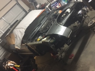

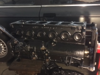

    I wish i got some pictures of it when i bought it 6 months ago. It was deceivingly clean. I found some unfortunate spots that lead to others, which lead to the teardown.
    As she stands now . . .

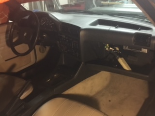

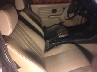

      I am working with a pretty clean interior, even if it they are only comfort seats.
      By the way, what is the best way to deal with tan discoloration in the door panels? This is apparently a common happening.

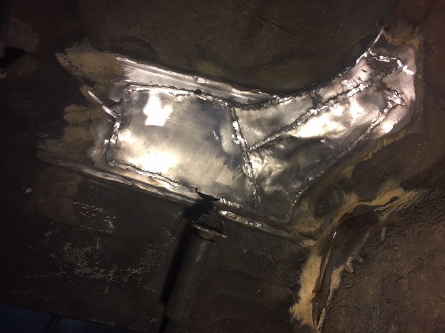

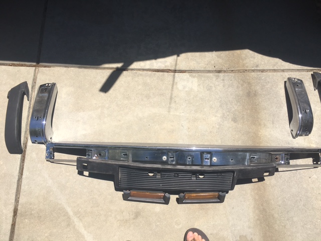

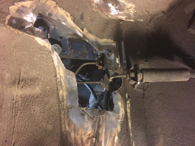

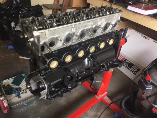

        10 May 2017 Update
        -So I have finished patching the wheel-well. The affected rust area was MUCH larger than I anticipated then I bought the car. The weather proofing is conducive until it has been compromised. It then becomes a rust promoter as it retains all the moisture from the road. None the less, it has been patched with fresh metal. I am contemplating getting rid of all the material and respraying it with bed dinner. What do you think?

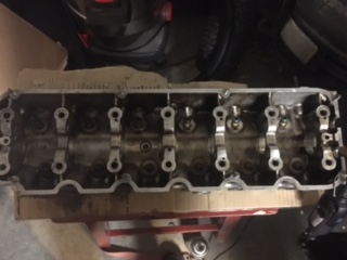

        -I have also mated the block to the head. The head was resurfaced and hot tanked by a local machine shop. Valves were polished and lapped. Additionally, the moving components were reused (i.e. springs, rockers, and cam)
        -Big News, I sourced a euro front bumper from Croatia which arrived yesterday. It ended up costing 350 USD shipped, pending and customs charges. They normally come in a little later in an envelope. Fingers crossed i won't get any.
        In the mail:
        -gaskets and sealed to install crank case cover, output shaft seal, etc. (al the boring things that add up to around $60
        -BMW Dot 4 brake fluid
        -timing belt

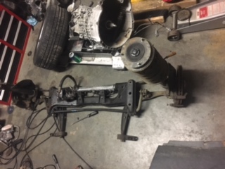

        Things to be done this month:
        -I found considerable rust in the floor pans. I am debating on sourcing full floor pans or patching in sheet metal.
        -Have the engine completely resembled
        -subframe refresh and cleaned (debating on whether I should do a power steering delete)

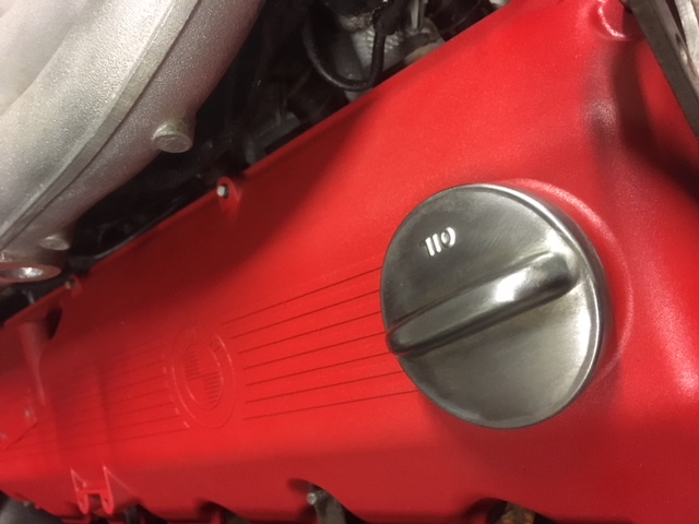

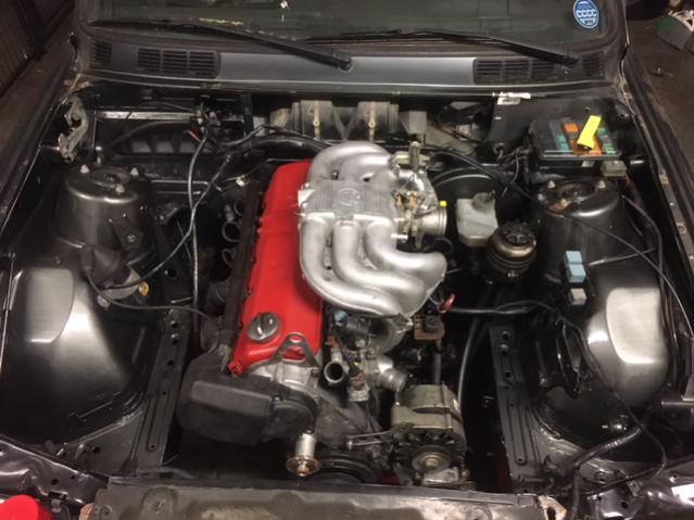

            So, a lot has happened since my last post. To date, I have:
            -painted the engine bay (same color as the body)
            -cleaned/sand blasted all engine parts
            -painted the valve color, inspired by Ferrari's textured red engine paint (pretty sure i am going to keep the red sliver two tone, don't want to go adolescent red crazy)
            -installed the engine
            -wired the engine
            -new brake lines
            -removed ABS
            the progress has slowed down since school has started back up. I was able to get some work done on fall break. I still need to finish welding in floor pan patches. I am getting slowed down by the angle sections.
            all that i am waiting for is: (in the mail)
            -electrical connectors
            -shift arm bushing (cleaned the bracket up by burning the existing bushing with a torch, then hit hit it with a sand blaster, looks brand new and saved $110)
            -brake line T
            -exhaust studs
            looking for:
            -wood steering wheel and matching shift knob
            -torn up sport seats to reupholster to cardinal red
            -euro style rear bumper

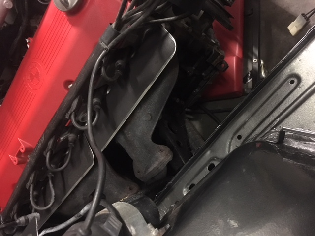

                Today I installed the headers with Ireland Engineering studs/nuts. I got them over the OEM one because they can be installed with an allen wrench. I also installed a heat shielding gaskets, primarily because i run a stock exhaust and they are prone to surface rust. The shield somewhat covers up the spot where water likes to pool up. I am still waiting on the other odds and ends needed to turn the engine over

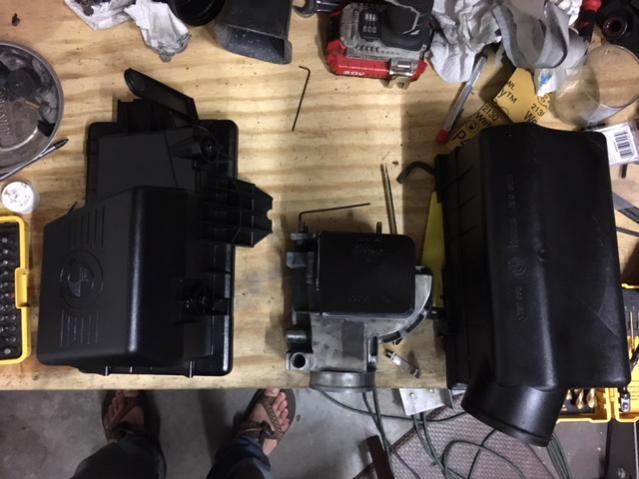

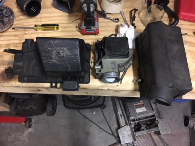

                  Today I spent the day refreshing the 30 year old air box. It apparently has some old and dried adhesive all over it. I cleaned it off with a dreamed brush. In order to clean our the detailed lines and BMW logo, I used a sewing needle to get into the crevasse. afterwards it got a fresh coat of plastic paint.
                  Furthermore, I got some other boring stuff done like replacing the gasket on the output coolant line from the back of the head. I also replaced the electrical connectors to the fuel injectors.
                  Here is a picture of the refreshed airbag. I think it looks a lot better than a cold air intake/stand alone air filter.

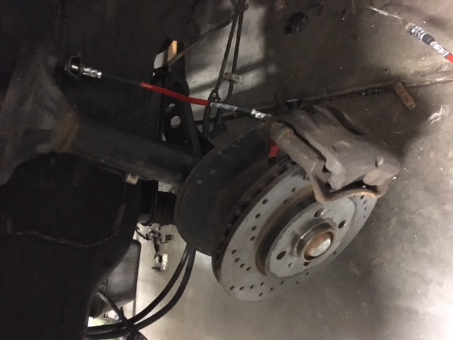

                    Today i was able to put in new soft and hard lines. Hopefully this will improve braking, not that i can even remember what the brakes were like before (going on one year into the build). The brake lines are from ECS tuning and by the looks of them they look pretty nice. The hardline are from 4.7mm metric lines from NAPA. I deleted the ABS and have the front T'ed.
                    Looking to get all the belts back on. I was finally able to find a place that rents a 3/4 drive torque wrench to torque the big ass crank bolt. My torque wrenches do not go up to 350 ft/lbs and i am not about to buy a $400 torque wrench for literally one bolt. So things in the engine bay should be wrapped up this weekend.
