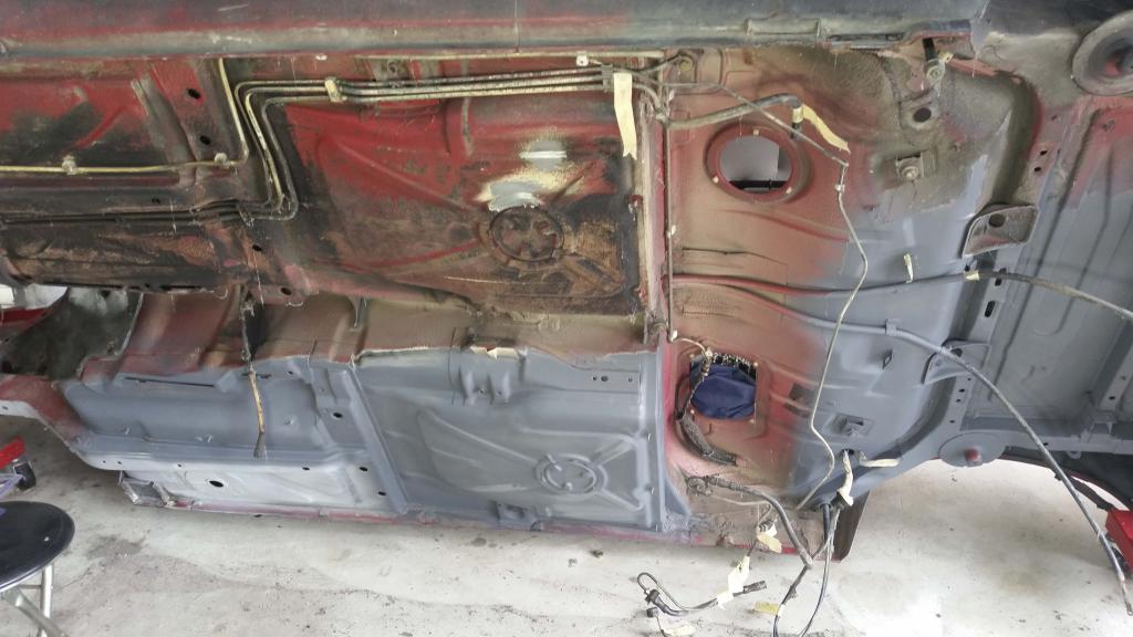

    Little bit of rust I would not have been aware of if I didn't do this. I couldn't see it on the inside of the floor but it actually went into a hole when I cleaned it up.
    [ATTACH]114853[/ATTACH]
    Messy job!
    [ATTACH]114854[/ATTACH]
    [ATTACH]114855[/ATTACH]
    [ATTACH]114856[/ATTACH]
    Every time I ground some off I would spray that area with etch primer when I'd finished for the day.

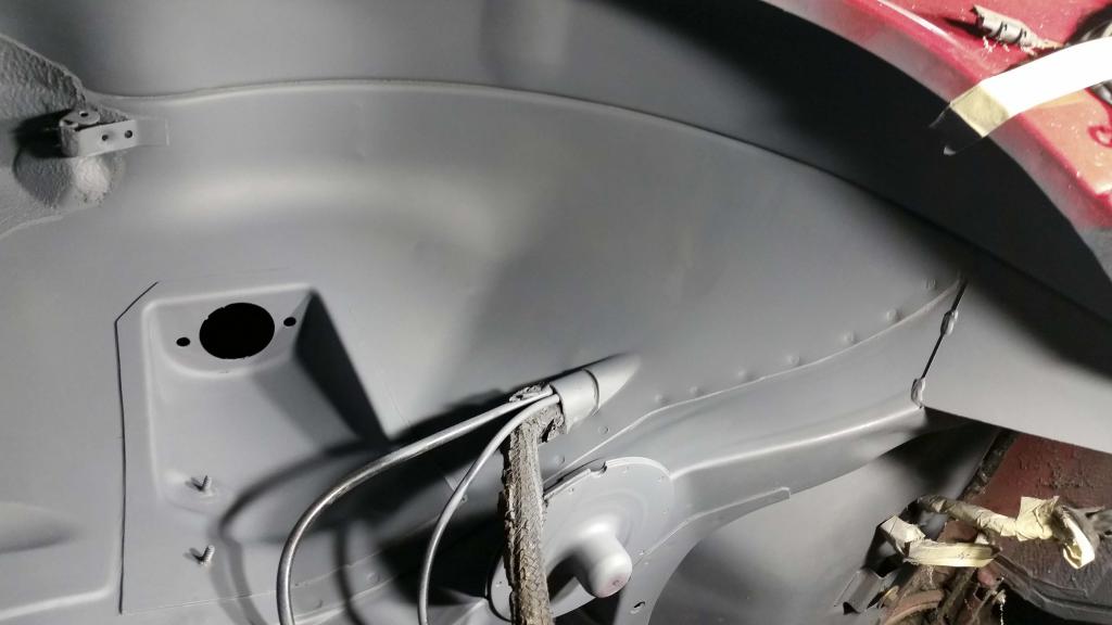

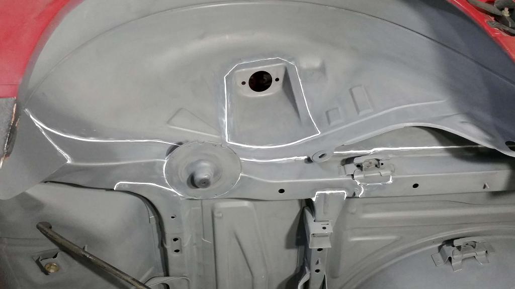

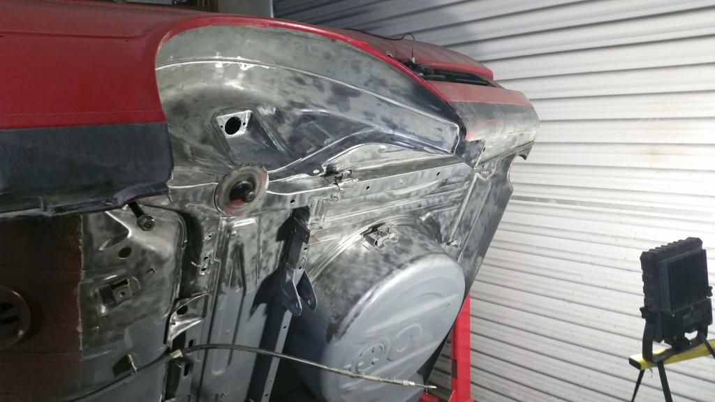

                More stripping of the underside.
                About 6Kg in total was stripped off.
                I know, I know, some people have said "but BMW put that on there for rust protection," and "It's going to be noisy." Well for the noise issue I'm going to put some sheets of Dynamat on the inside of the floor. You only need to cover 25% of the area to stop it resonating. And I have fixed the rust spot in the floor which was under the coating, etch primed everything, and all the seams have been sealed up again.

                Next it's time to 2pk prime the whole underside, stone guard the inner guards, and apply the base coat, Kandy coat, and clear. Looking forward to seeing it all in paint finally.

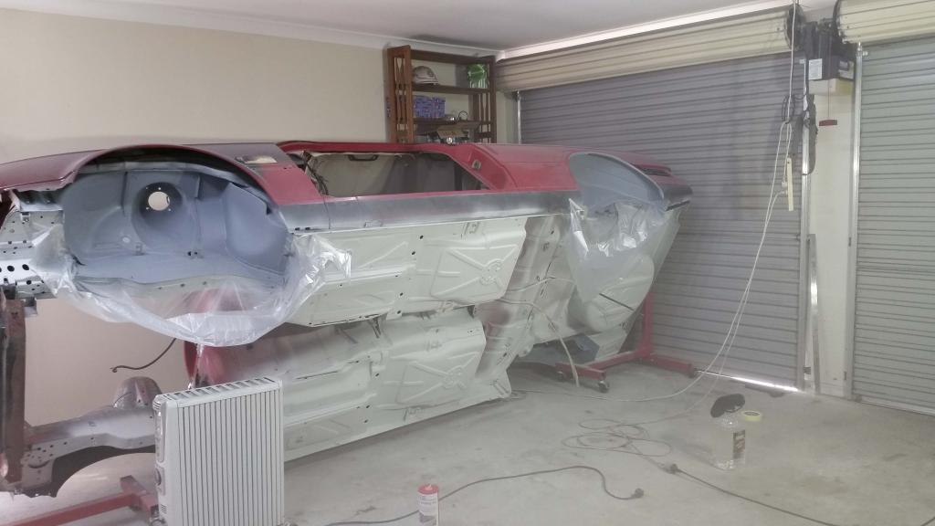

                  Getting closer.
                  All 2Pk primed and sanded back. Was finally able to get the stone guard on all the inner guards. Not far from colour now.......Click image for larger version

                  And the colour is on
