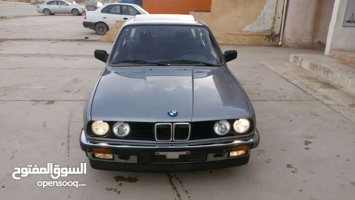

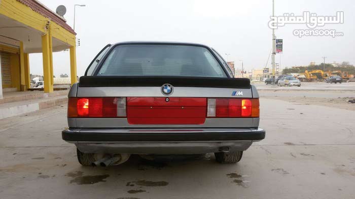

    Found this 1987 320i coupe for cheap planning on buying it in a couple days.
    Appreciate any forum advise on what to update on the car
    Thank you all.
  • ELVA164
    • 4861
    Why update it? It looks great now. Do you mean mechanically?
    If that's the case, start with a timing belt and water pump, change all fluids, check suspension bushings, consider an E36 steering rack, and read up on what type of suspension you might want. Check the brakes, as well, just to make sure they're in good shape.

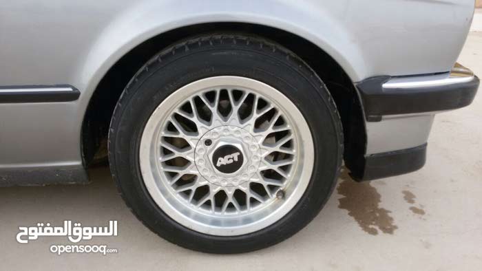

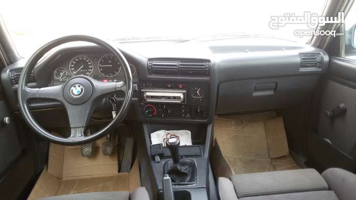

      Would like to update engine and suspension and put on a set of oem wheels.

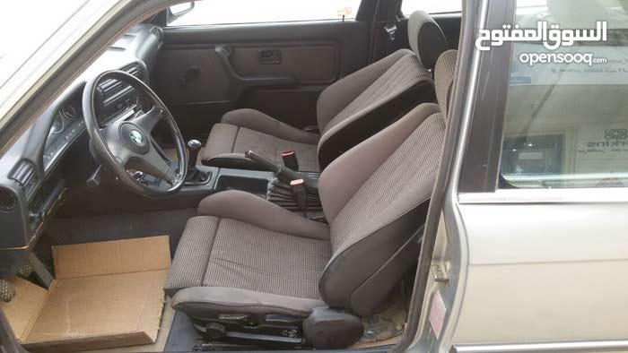

      Here are pictures of the interior.

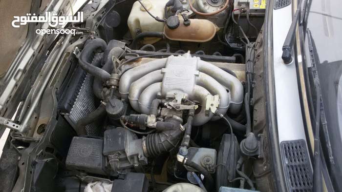

        That engine is limited by it's stroke and bore, but has the "731" head that was never offered in the states. The easiest thing would be to find a good 2.7L eta engine to swap that head onto, along with a 325i intake, tb, motronic 1.3 fuel injection, and 325i exhaust. I think that head will have the good cam in it but if not I'd use a 325i camshaft.
        I'd install a 325i radiator also.

          remove rear plate filler, and carbboard floor mats
          • MR E30 325is
            • Dec 2008
            • 3300

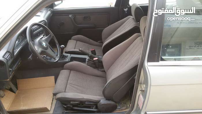

            Those front seats are probably worthless. Should definitely sell them to me! Haha
