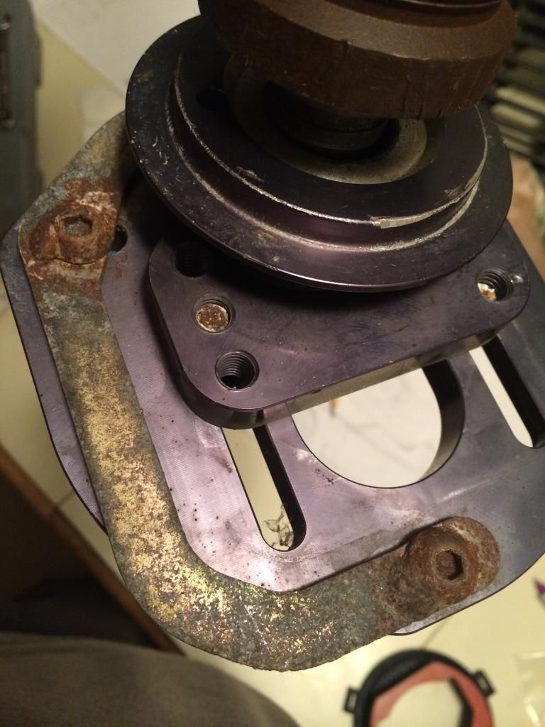

          I had my camber plates rebuilt sometime during this as well, which was a story in itself, but here they are before. Open raceplate design used for 3 years in New England means they weren't pretty
          Of course I didn't take pictures afterwards.

                    Got some new Ground Control camber plates too since I had a guy interested in buying my complete old setup.
                    Put them all the way down to start to see how "Tief" they actually go, was impressed until I realized the tire was bottomed out in the fender and the spring was still loose. Suffice it to say they go as low as you would ever want...
                    I ended up setting it at exactly the same ride height I had before. The ride is so much better, I had designed my old setup just to go low, ride wasn't factored in to the equation. The sway bars helped more than I thought they would; early 318's didn't come with rear sway bars.
