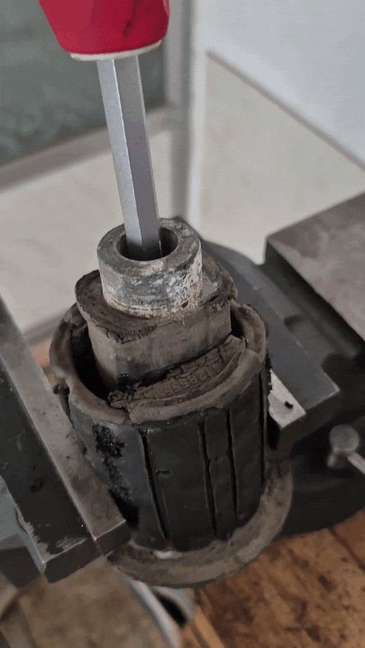

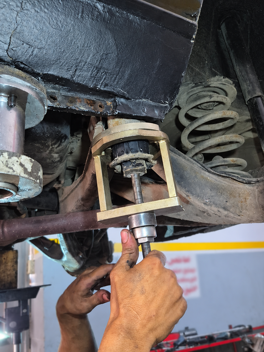

                              - During my home country visit this summer, I got help from my sister's father-in-law to replace the subframe bushings, a job I always feared to tackle. He repairs BMWs since the 1970s and have a special press designed specifically for this job:
                              In a matter of minutes, the old bushing was out and the new one was in while the car was on post lift.
                              Without this tool, I was planning to use the below linked method, using a 5/8" bolt:
                              Remove a stuck, seized rear subframe bushing on a BMW E30 - technique for oxidized bushings that will not budge.
                              In the below gif you can see the condition of the old ones:

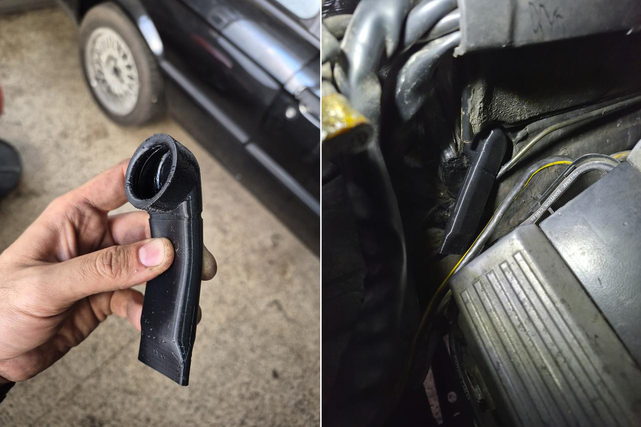

                              - The elephant trunk rubber drain hose 51731911369 below the front windshield was hard as a rock.
                              Considering the replacement from BMW is around $ 50 (51731911369), I printed one myself from TPU (flexible rubber material).
                              I installed it and it fit well ! The 3d model was downloaded from cults3d.com for around 3 Euros.

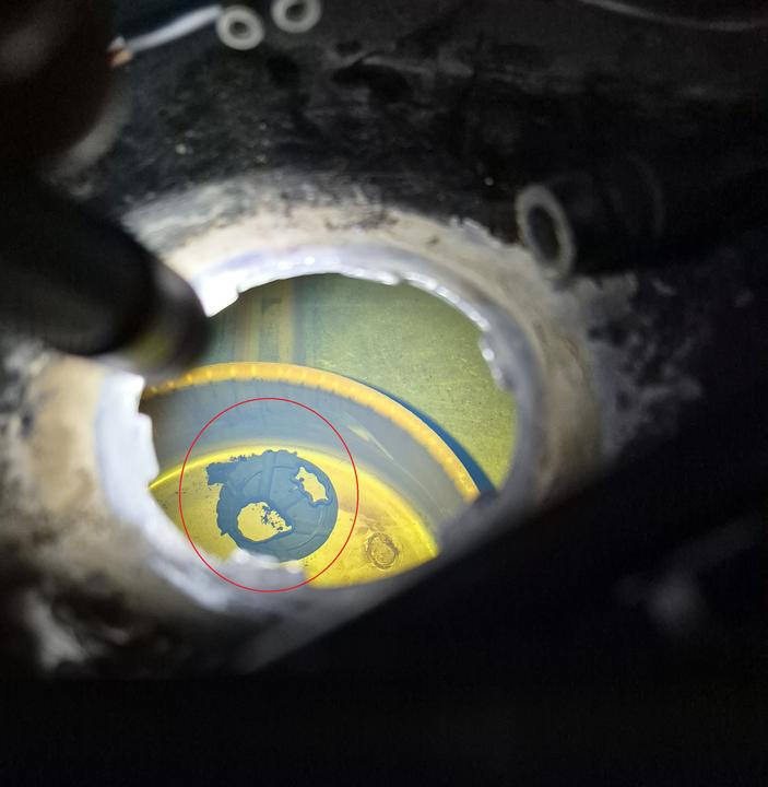

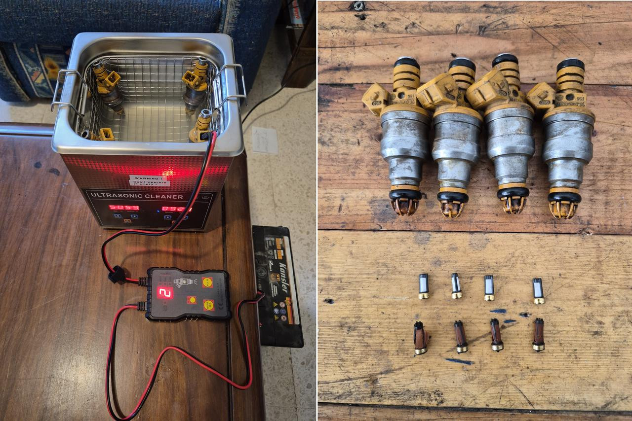

                              - Ultrasonic cleaning for the fuel injectors and filters change:

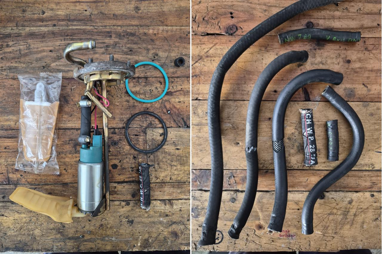

                              - I opened the fuel tank to the condition from inside.
                              It was clean and rust free, but found a rubber gasket laying in the bottom so I removed it:
                              - Replaced all the fuel hoses on top of fuel tank, which one of them was held by zip ties !
                              Also changed the fuel pump filter and oring.

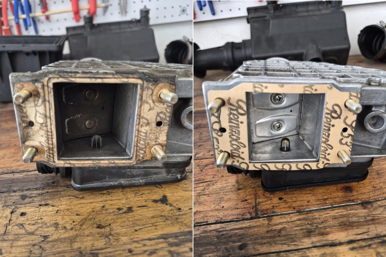

                              - Cleaned the AFM and changed its gasket:

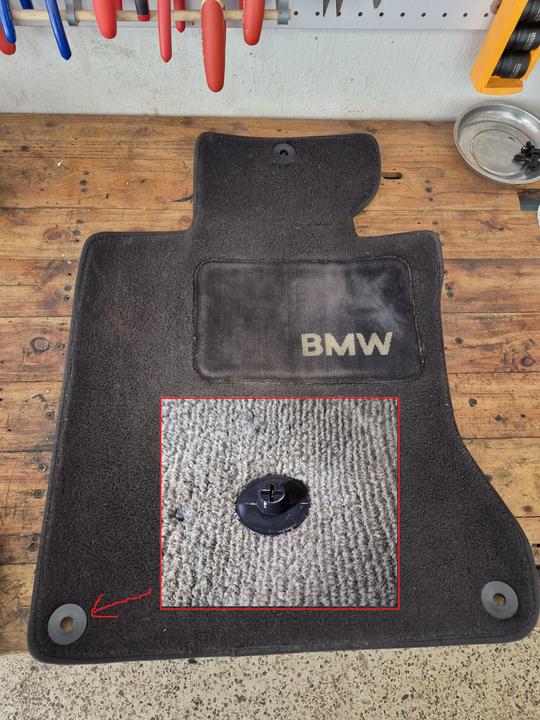

                              - The floor mat was not staying in its place under my feet and moved all around, so I added plastic holders and screwed their counter part in the carpet:

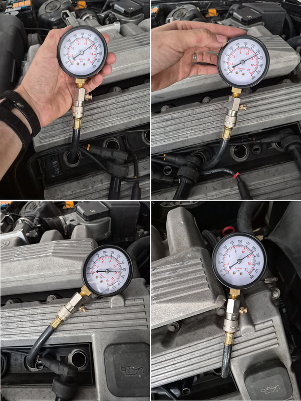

                              - Finally did a compression test after all these years and found that all the cylinders are in very healthy condition with pressure ranging from 205 to 210 psi for all:

                                #45
                                Did you use submersible rated hose for the in-tank fuel pump connection?
                                I tried it with regular fuel injection hose and the outside was soft within a month.
                                I ended up replacing it with submersible-rated Gates 27097 (3/8" ID)
