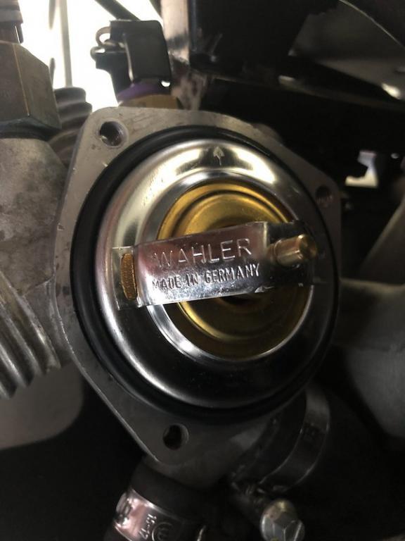

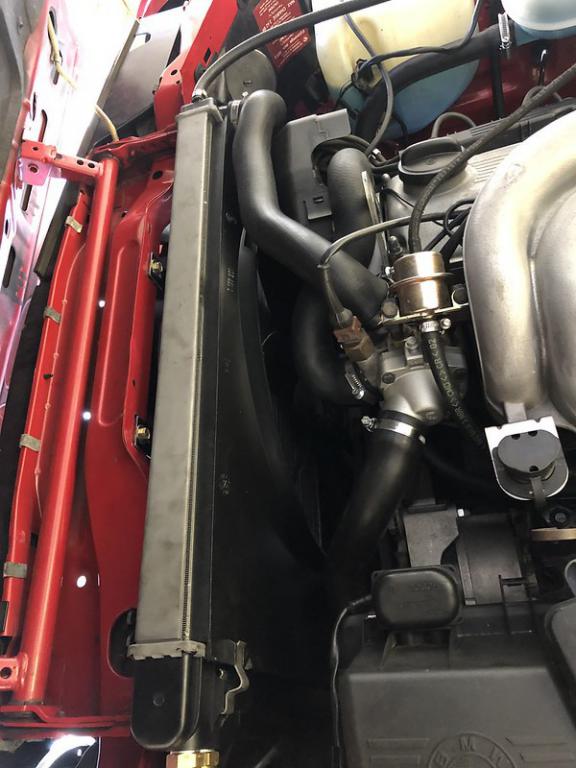

    I then got the radiator, new temperature switches, all new hoses, and a new thermostat installed:
    Click image for larger version  Name:	48555350051_8b3f55fcc2_c.jpg Views:	0 Size:	42.5 KB ID:	9862603
    Click image for larger version  Name:	48562658226_c151353d53_c.jpg Views:	0 Size:	61.5 KB ID:	9862604
    I then refilled the system with the good BMW coolant and went to start the car. Cranked and cranked, but wouldn't turn over. Bummed. I figured maybe my battery had been drained a bit and didn't have enough juice to get it going so I decided to charge it up. While waiting I started poking around, and realized that I had clipped my crank position sensor in the wrong groove when I did the timing belt. This effectively had the sensor about 1" from the harmonic balancer rather than right up against it, as it should be. I figured that HAD to be it. So I put the fully charged battery back in, crank crank crank and no start. Now I was getting a bit nervous. I decided to check the C104 plug by the DME because I couldn't remember if I plugged it back in or not, I had. While I was in there I played around with the big DME plug and it fell off, turns out I hadn't clipped it all the way in. I pushed it on all the way, turned the key...
    SUCCESS!
    The car idled better than it ever has after warming up. I then bled the coolant with the heater on full blast and the front of the car raised up a bit. After all the air was out, it was time to take it for a spin. It ran PERFECTLY, I was giggling like school girl the whole time shifting through the gears, everything was nice and smooth and the car was a BLAST to drive. After about 10-20 miles or so I felt comfortable that everything was working properly so I decided to get my Conforti chip installed:

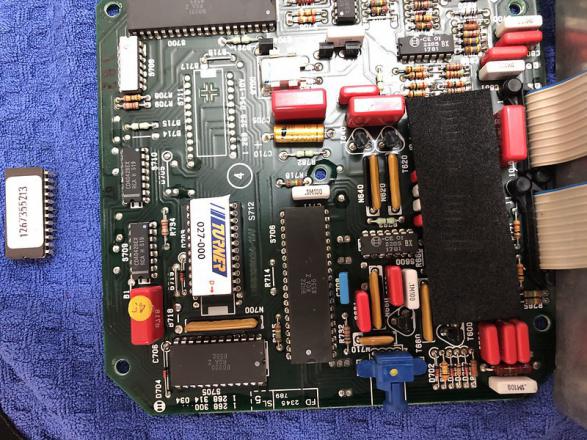

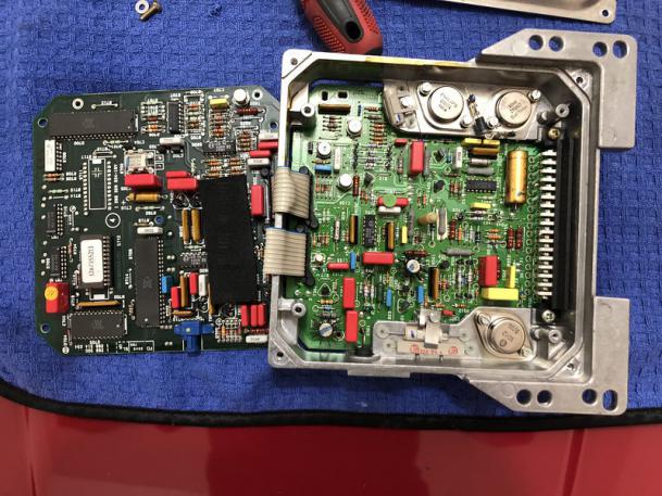

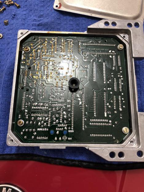

    Remove the 4 phillips head screws on the back plate of the DME, followed by 2 phillips and 2 flat head screws that hold the circuit board in place. Flip the circuit board out:
    Click image for larger version  Name:	48562656786_f5fe66206a_c.jpg Views:	0 Size:	68.3 KB ID:	9862606
    Click image for larger version  Name:	48562799962_a21f927e65_c.jpg Views:	0 Size:	68.3 KB ID:	9862607

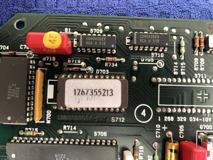

    The chip you'll be replacing is the one with the white paper label in the lower left corner.

      Click image for larger version  Name:	48562800197_6c8fe7286d_c.jpg Views:	0 Size:	72.0 KB ID:	9862611
      Take note of where that little notch is located on the left side of the chip, you'll have to align the new chip the same way:
      Click image for larger version  Name:	48562798857_11583a3751_c.jpg Views:	0 Size:	71.9 KB ID:	9862612
      Put it back in and took it for a spin, it idled slightly higher and definitely seemed to have a bit more pep and faster throttle response. I've been driving the car around now for the last two days and I have to say, WOW. It's so much more fun to drive. I still wouldn't classify the car as fast per se, however it's a very noticeable improvement and I feel like it rivals my e46 325ci in the speed/acceleration category for sure. The car finally feels complete. With all the suspension/drivetrain work I did, you couldn't really feel it with the auto trans in place because I always felt the acceleration was bogged down. Now, the car feels super tight, and the exhaust sounds phenomenal, very throaty with some nice burbles on downshifts.

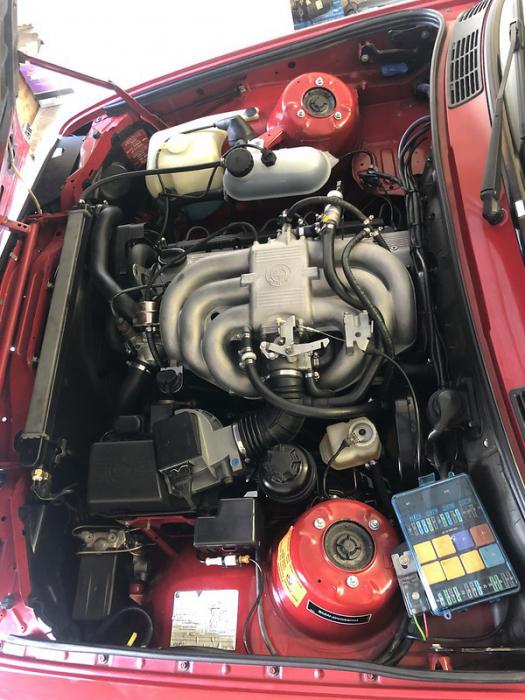

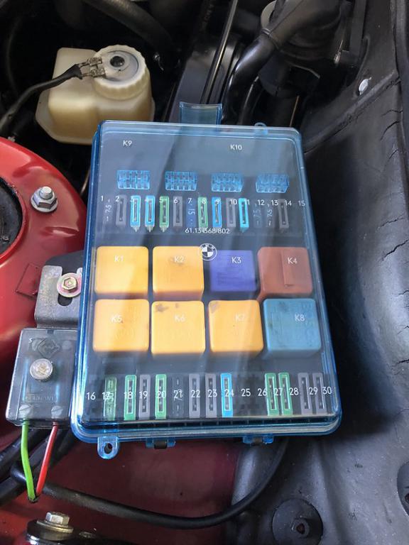

      I cleaned up the engine bay and put in a new hood hydraulic piston as well as a new fuse box cover, my old one's tabs were broken:
      Click image for larger version  Name:	48569850632_6a7f026e37_c.jpg Views:	0 Size:	69.4 KB ID:	9862613
      Click image for larger version  Name:	48569707346_f019f1360a_c.jpg Views:	0 Size:	60.3 KB ID:	9862614

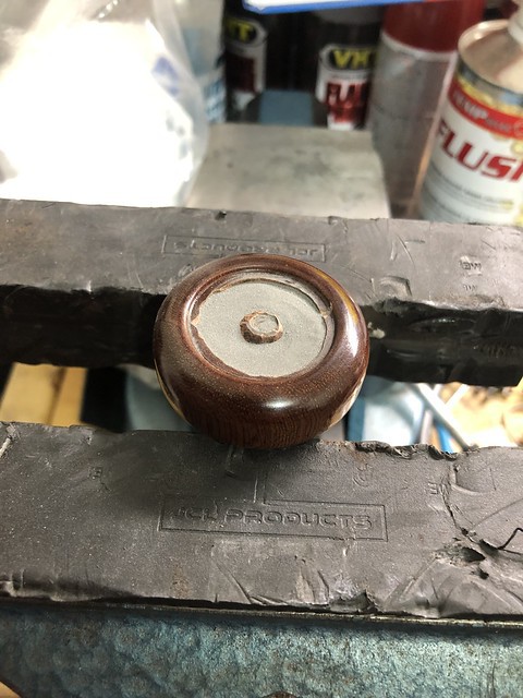

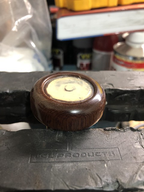

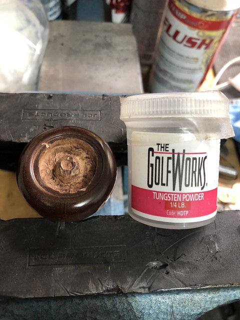

            A while ago I purchased a nice mahogany shift knob, however after driving the f82 with a weighted shift knob the wood felt a little unsubstantial (that's what she said). I decided to drill it out and add some tungsten powder, it's denser than lead and readily available from most golf shops:
            Click image for larger version  Name:	48507030052_209c67e6e6_z.jpg Views:	0 Size:	81.6 KB ID:	9862966
            Click image for larger version  Name:	48506856551_5078b1b9d7_z.jpg Views:	0 Size:	86.4 KB ID:	9862965
            I sealed it with some wood glue:
            Click image for larger version  Name:	48507029547_dcf0dab3f2_z.jpg Views:	0 Size:	62.2 KB ID:	9862967
            I estimate I got about 3oz worth of powder in there, definitely gave the knob a nice heft.

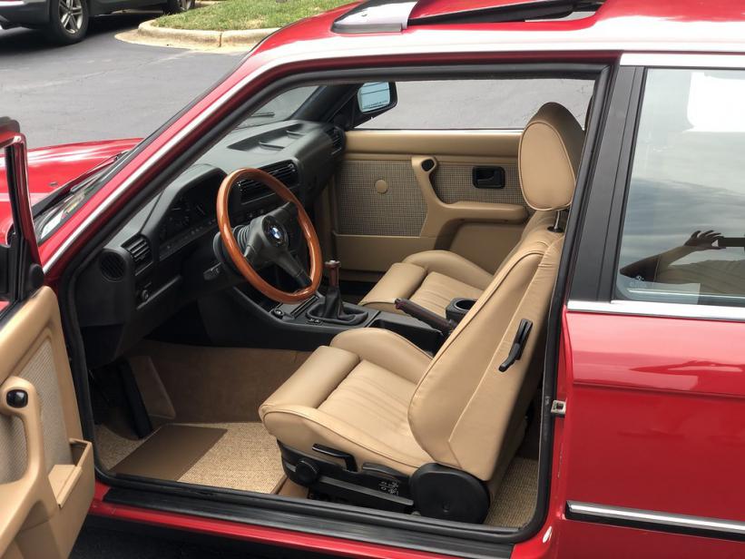

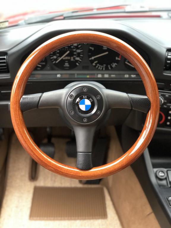

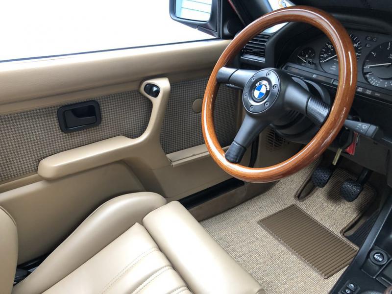

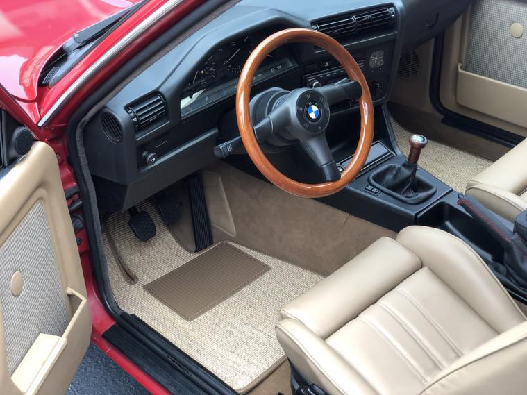

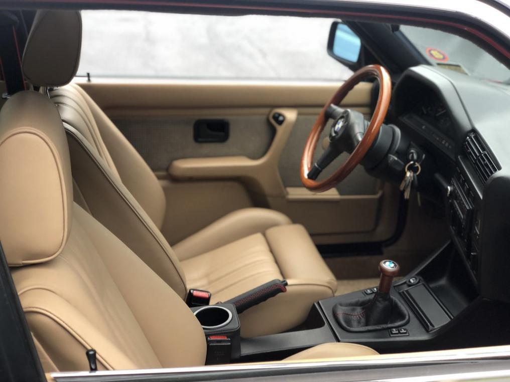

              I also decided on a steering wheel:
              Click image for larger version  Name:	48580067587_ac42d6c10a_c.jpg Views:	30 Size:	52.5 KB ID:	9862972
              I knew I wanted a Nardi for awhile, but had a hard time deciding which one. I loved the wood wheels but felt like the metal spokes were just a little TOO retro for me. Once I saw someone post up a Woodline for the first time, I thought it was the perfect balance of retro with the wood, but a bit more modern with the leather spokes. It took awhile, but I ended up finding a used but essentially brand new one on Ebay with the hub included for a very reasonable price.

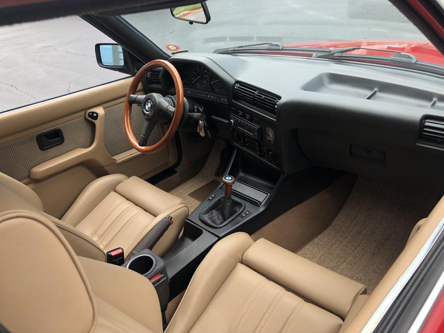

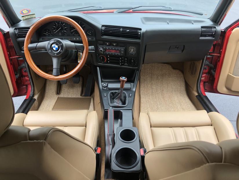

              I have to say, the mats really bring the interior together:
              Click image for larger version  Name:	48580070427_2f96521ec5_b.jpg Views:	29 Size:	71.9 KB ID:	9862973
              Click image for larger version  Name:	48579927566_cc14cff1e2_b.jpg Views:	29 Size:	71.7 KB ID:	9862974

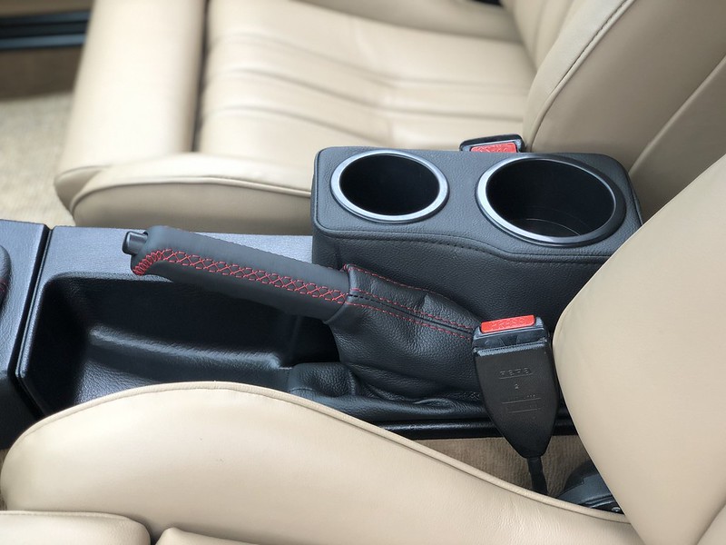

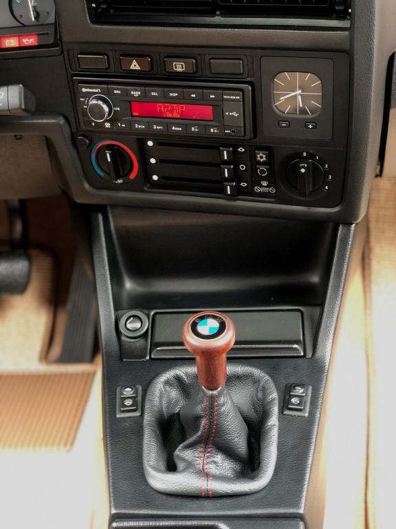

              In keeping with the red-trimmed theme, I found some leather shifter and ebrake boots from the UK for about $20. Then, I found someone I had bought some other parts from in Germany selling leather-wrapped E-brake handles and he too offered a red-stitched example, and I feel like they go together really well. The cupholder is from a seller on R3V:
              Click image for larger version  Name:	48580066432_71a082c919_c.jpg Views:	29 Size:	87.7 KB ID:	9862975
              Click image for larger version  Name:	48579925746_d0efeb8388_b.jpg Views:	29 Size:	65.8 KB ID:	9862976

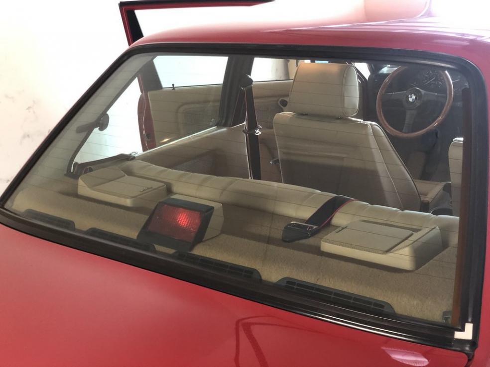

                  Click image for larger version  Name:	48579925091_7a4655b6d2_b.jpg Views:	0 Size:	70.4 KB ID:	9862985
                  Tough to get a great shot of the rear deck:
                  Click image for larger version  Name:	48579922351_1395243cbc_b.jpg Views:	0 Size:	64.0 KB ID:	9862986

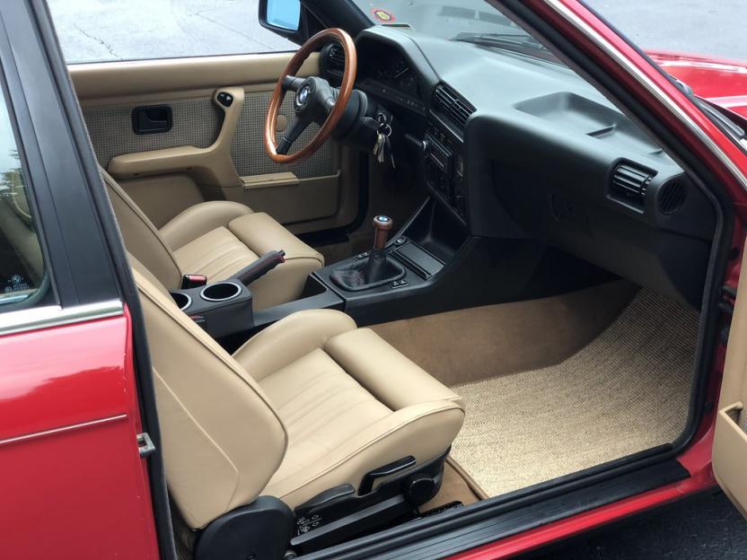

                  I'm extremely happy with how the interior came out. I was a little iffy on the red stitching/seat belts but it really makes the interior pop and looks really sharp. I was also worried that the houndstooth would be a bit busy but it works really well and will actually be correct for the MTech1 once I get it installed. Only thing I need now is the new cluster which will finish off the look.
                  As for mechanicals, I still need to get the A/C working. I rebuilt my compressor last week and will post up a little DIY on how I did that. I'm waiting (actually been waiting for over a month) on one of the new replacement hoses and then I can get everything hooked back up, vac'd, and refilled. I NEED some A/C down here in the durty durty. After that, essentially everything I've wanted to overhaul from a mechanical standpoint will be complete. Then It'll be on to the cosmetics: MTech kit repair, repaint, euro bumper conversion, and a few other nice and functional euro upgrades for the car.

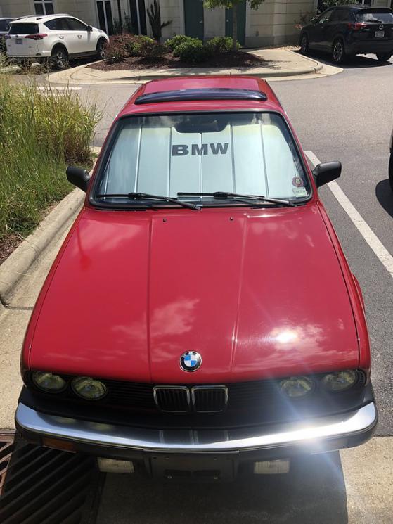

                      So after a day or two of driving normally, I've run into an issue with overheating. My first few drives I saw the engine temp creep up to the 3/4 mark, then work its way back down to 1/2 and stay there. The other day when driving home from work, however, it kept going up to the red. I pulled off the road and let the car cool down immediately, then once cool limped it home. I re-bled the system with the front end of the car jacked up a bunch of times, and no dice. After some diagnostics, I've narrowed it down to either a faulty thermostat, or a clog in the new radiator. All coolant hoses including the upper radiator hoses feel hot once the car comes to temperature, however the radiator itself as well as the lower radiator hose remains cool to the touch. This leads me to believe that there is no circulation of coolant through the radiator i.e thermostat or a clog. I highly doubt the new water pump is bad, and essentially all components of the cooling system (sensors, hoses, radiator, heater core, etc) are brand new. The only thing I didn't change was the fan clutch, I had a new one lying around and swapped it in. Definitely seems like more air flow, but this just slows the overheating a bit. I've read on a few different threads about the OEM Wahler Tstats being faulty out of the box and so I've ordered a new BMW one, should be here by the end of the week. I have no reason to believe that the head gasket is the issue as it was fine prior to the manual swap, my coolant remains clean as does the oil, and I have no white smoke coming form the exhaust. The car is running great aside from the overheating.

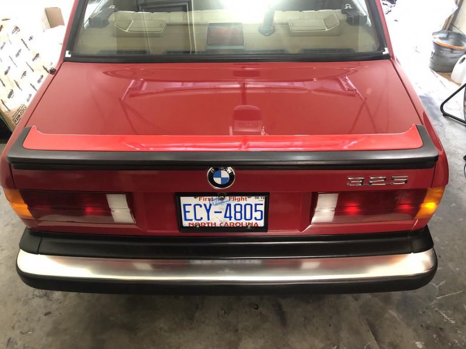

                      While dealing with the above, I decided to touch up the bumper shrouds and IS spoiler as they got a bit dinged up from all the work I did under the car. With the IS spoiler off I decided to test fit the MTech1 spoiler as a bit of a pick-me-up, looks pretty good aside from being a different color (brilliantrot or perhaps hennarot):
                      Click image for larger version  Name:	48620474246_fed64b40c6_b.jpg Views:	0 Size:	49.6 KB ID:	9864424
                      Click image for larger version  Name:	48620126748_bea1467a6e_b.jpg Views:	0 Size:	72.5 KB ID:	9864425
                      Can't wait to have it repainted and installed along with the rest of the kit!
