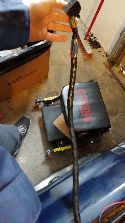

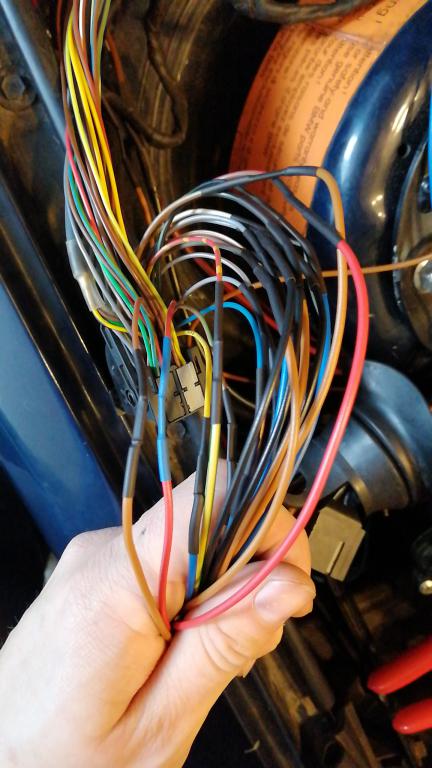

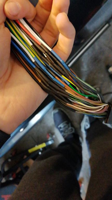

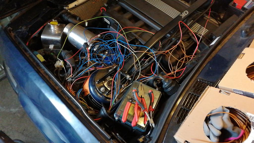

          ECU moved inside the car. the splicing action was real.

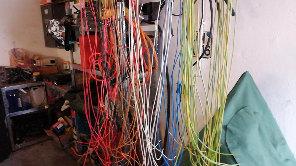

          About half the wires that where used:
          Started to feel like a bad idea:
          Getting there:
          Almost...
          Done!
          Did this with all the wires needed for the ECU. fits now inside the glovebox.

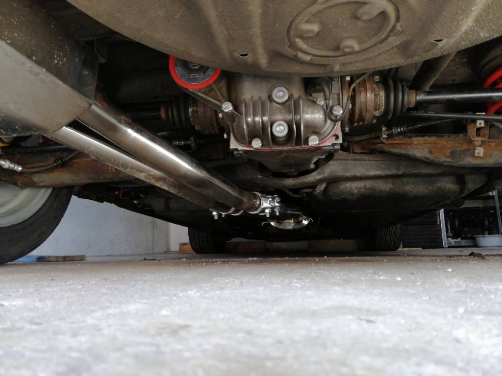

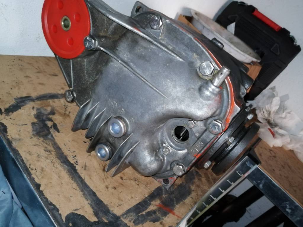

              Finished the wiring and filled the diff with 75W140 (about 1.2l)

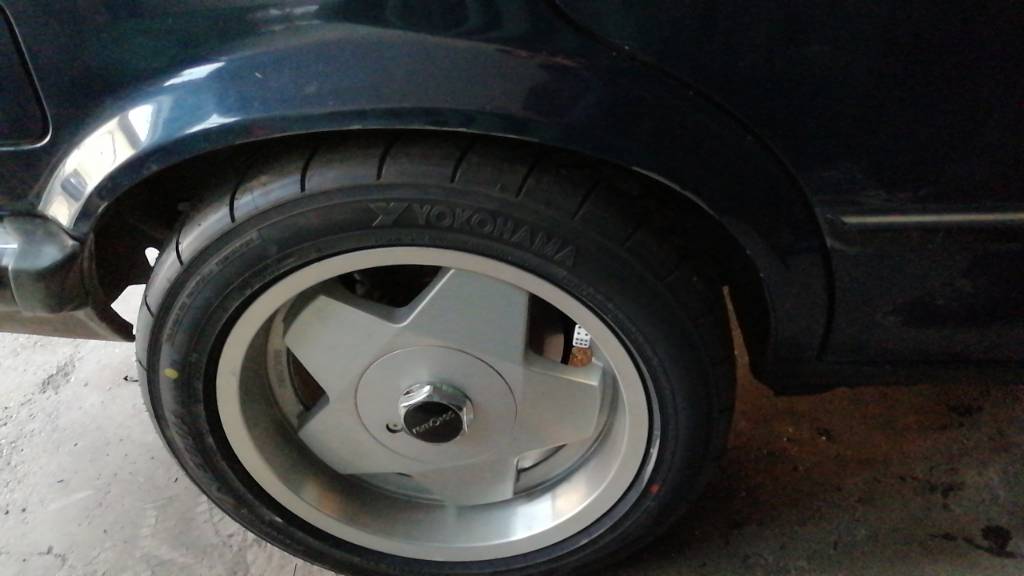

              Also rolled the rear fenders.

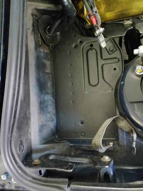

                Put the new diff in, did some rust removal of the battery tray and rolled the last fender.
