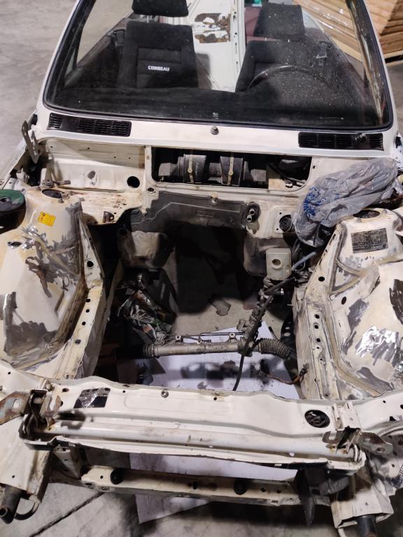

              I started to shave the bay this weekend in preparation for the new engine. I pulled the wire harness and rewrapped it, mounted the G260 to the M52, and had the subframe reinforced. The next steps are to install my ChaseBays BBE and ABS kits, finish shaving/painting, and drop in the new engine.

                I'm keen to do a lot of the things you've posted here. Interested to know more about why/how you went about rewrapping your harness. To make it look nicer or did you do some re-routing as well to hide parts of it?
                Any further pics on the shaving ?

                  Hey, it was mostly to clean up the harness since the old tape was crumbling off. I can't recommend tessa tape enough, and high temp tessa tape for the engine bay. It's like a cloth electrical tape that isn't as sticky to deal with. I don't plan to tuck the harness, though I did separate things that won't be used. I split the ABS wires from the main loom and wrapped them independently so they can be tucked out of the way somewhere. I didn't want to cut too many wires in the case that I change my mind about something, but I will probably cut the wires for the AC that aren't being used anymore.
                  As far as shaving goes, I cut off the unused brackets and ground the seam sealer down smooth using a flap disk and cutoff wheels, then used body filler (rage ultra) to smooth it all out. I sprayed etch primer over everything and plan to go back and clean up any spots that I missed. I'm not too concerned with the passenger side as it'll be covered with gold tape for heat insulation. I'll attach a few more pictures of the process for you here.
                  Click image for larger version  Name:	img_20200403_193210.jpg Views:	0 Size:	81.6 KB ID:	9915589Click image for larger version  Name:	img_20200403_182456.jpg Views:	0 Size:	80.5 KB ID:	9915590​ Click image for larger version  Name:	img_20200404_150817.jpg Views:	0 Size:	79.1 KB ID:	9915591

                    Awesome, thanks for that! My friends is a sales rep for Tessa so I'll get some of that off him - my loom is a mess and the whole thing needs to be re-done from the P.O so it's a good time to give it a crack.
                    The shaving of the bay looks awesome, are you planning on filling the holes on the two 'front' sections near where the headlights are?
                      I thought about it, but I feel like it's more work than I feel like doing to do it right. Maybe one day in the future if it starts to bother me. I'm struggling to find the balance between building to my goals and getting the engine in so I can drive the thing. Sent from my OnePlus 7 Pro using Tapatalk
