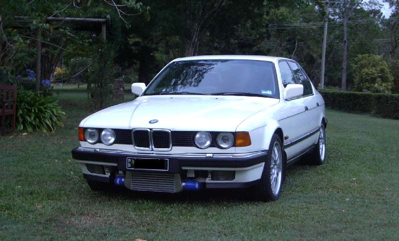

                          Have also been playing a little with my daily driver too... E32 735i with a 2JZGTE :) I want 400 atw's with this before I get back into the E30...
Name:	7 complete.JPG
