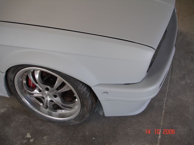

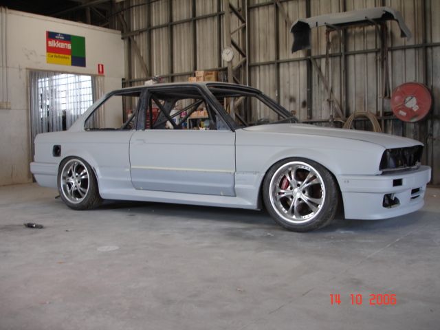

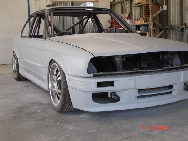

    Been floating around for a while, but haven't been doing much with my E30 project over the last 12ish months due to work comitments and the fact the car is at the panel shop.
    A few little details abot my car :-
    Purpose :- strip/street
    Engine :- 2JZGTE
    ECU :- Autronic SM2 + R500 CDI
    Turbo :- T66 XTR BB
    Injectors :- 850cc/min Sard
    Intercooler :- Garrett BnP 600x300x105
    Radiator :- PWR twin core 450x400
    Exhaust :- 3.5inch through to twin 2.5inch
    Gearbox :- Transbraked C4
    Front End :- Bilstiens, nolothane bushes, Adj strut tops
    Rear End :- E23 cut down, M5 LSD, E28 brakes, custom GAZ coil over conversion
    Body :- 318i '85 model, widened guards, M-tech II front/rear bar, Zender sides, full 6-point cage, race seats etc etc
    It appears my images are too big... so will have to resize and update at a later date :)
