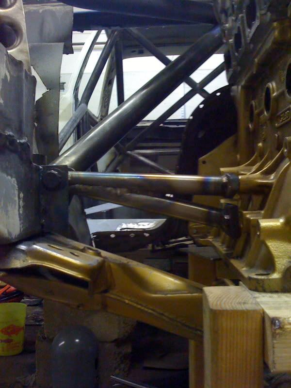

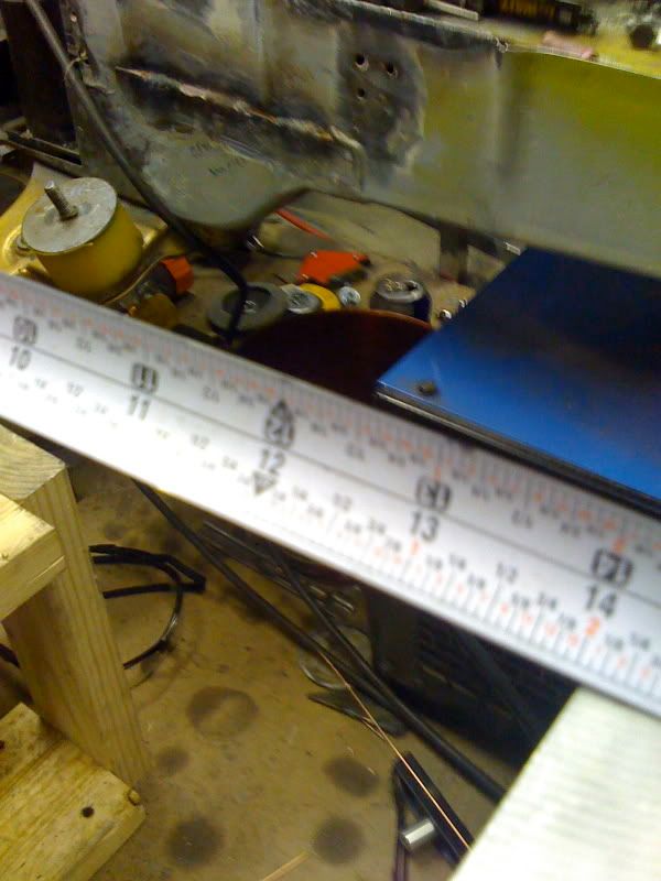

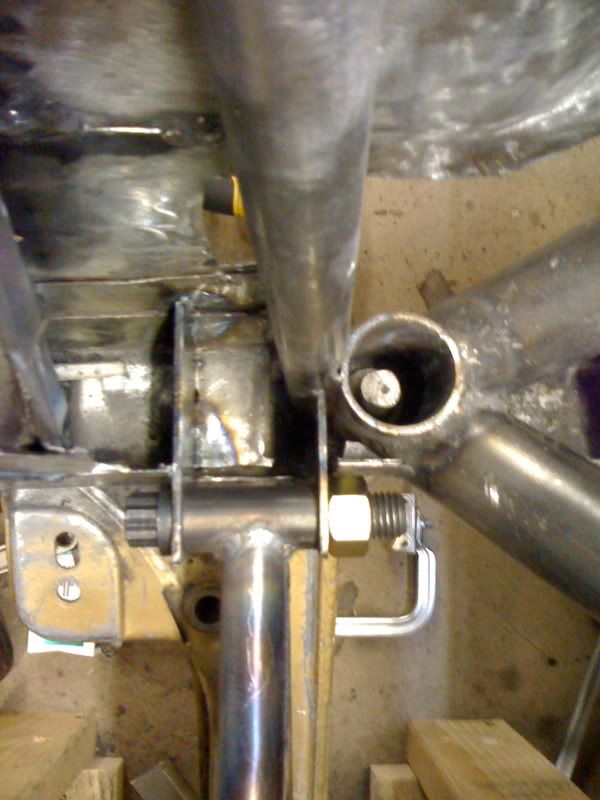

                Ive been pritty bizzy latly with work and all but ive worked on the car a bit.
                I got the motor centered and mounted vertical its 14 inches back from where the front of the engine bay it, and about 5 inches from my dash bar, which is what i planned for.
                Everyting moutned so cleanly im very happy with the results. The tube is 1" .125 wall 4130 and a 3/4 bolt fits inside like a glove. ANd i know it will hold the motor just fine.

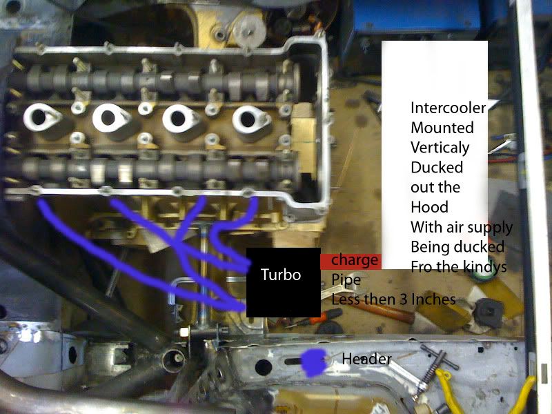

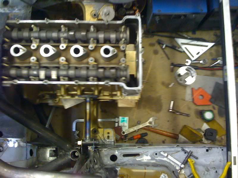

                Heres what i have planned for the turbo set up. The intercooler will be moutned vertical, ducked in from the kidnys, and then out the hood. The rad will be V mounted and then also ducked out the hood, and i will be running the flossman undertray.
                The charge piping should be less then 3" inches a side too.

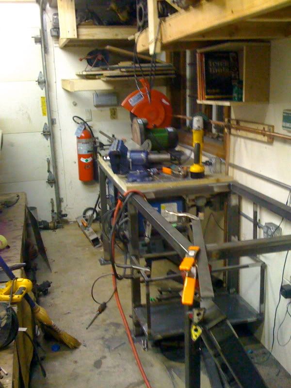

                Summer is around the corner so i need to get ready for some serious fab so i redid the garage to.
                I love my plasma, it has really increased my fab speed. And it has saved me a shitload in cutting consumibles.
