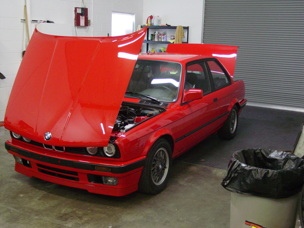

          In my shop, Time to get ready for the 2010 concours
          Up and disassembling begins. I had to fix the gap of the rear bumper and also install my sunroof drains.

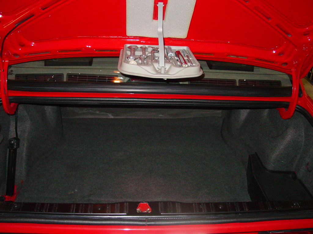

          The stock cardboard back in place:
          Cleaned the freshly painted trunk:
          Ran this wire in a cleaner location:
          Had to fix some rust and corrosion in the battery tray. My last batter overcharged and spit acid all over... I didn't notice for a year and a half, Great. Anyways all cleaned up and also installed the sunroof drain:
          Re-installed battery shelf and battery:
          Trunk Done!

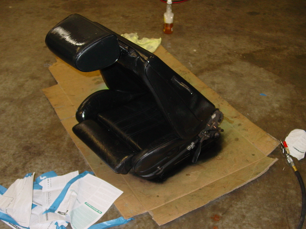

          Pulled the seats to clean then and paint the rails:
          Conditioning:
          And installed:
