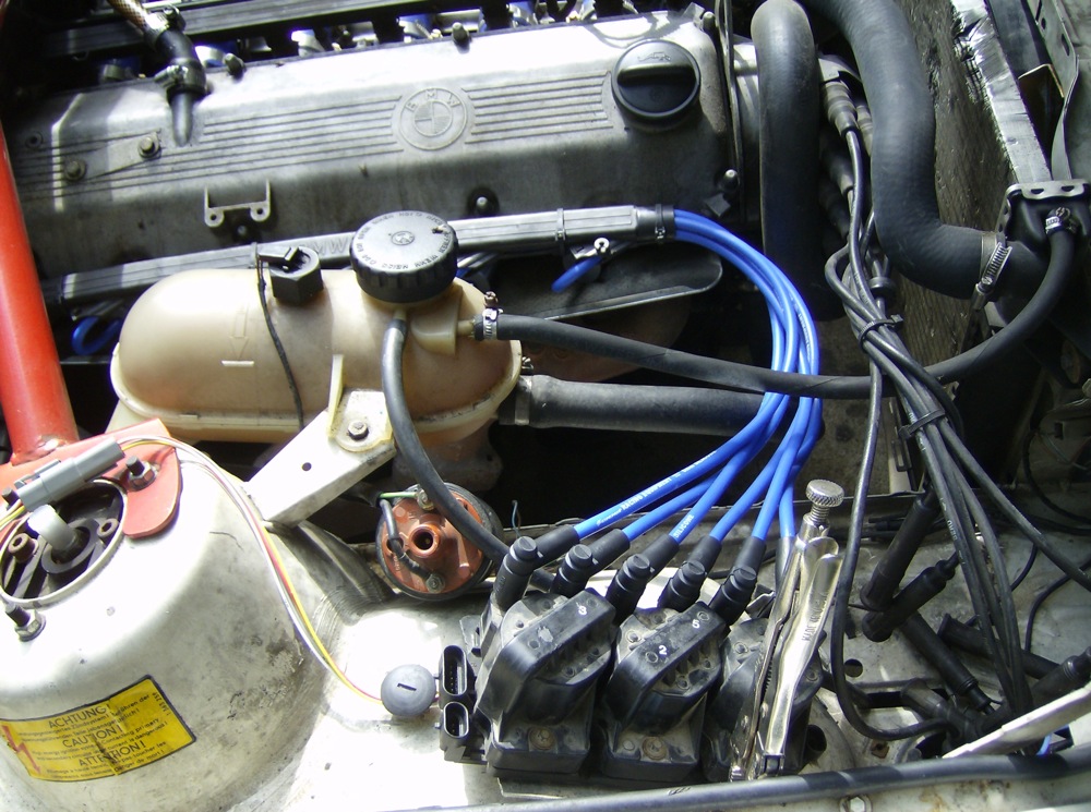

        Started another little project today, just waiting on some Bosch coil drivers to come in the mail, to finish wiring it all up.
        85 325e 2.7 ITB'd stroker

          yup... that's a stout m20.

            Man that thing is sexy looking, Any plans on cleaning/painting it (the engine bay) after you get all the small thing's ironed out?

                I doubt it.. That car is built to go not for show !! ;)

                    I'm probably going to throw a painted I valve cover back on it at some point but that's probably it. I'd love to get everything sparkling clean and painted but just don't have the patience or time to do it.
