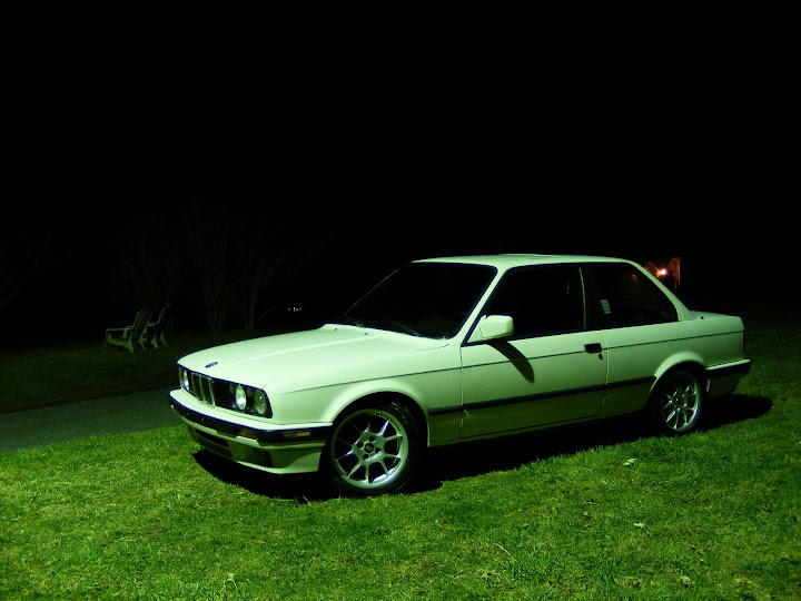

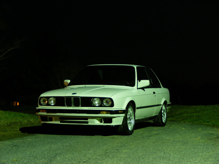

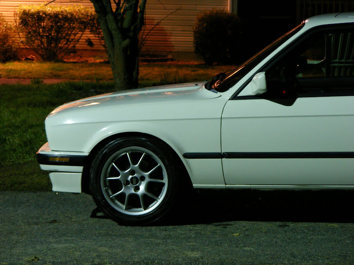

      Got two new pairs of shoes for my piece of junk....
      got some BBS RKs from EtaSport. Hurriedly cleaned my car in the dark and took some night shots under the huge flood light.
      My immediate plans are next to get new tires, spacers in the rear, and a stud kit. The wheels sit too far in in the back it seems.
      someone got curious as to what i was up to
      see how badly i need spacers
      there's me!

        Nice fix on that wheel.
        They look great on your car. You NEED spacers though.

          oh i know i need spacers. I knew i would need spacers before i bought the wheels. I am going to get new tires first because these ones are terrible and vibrate bad, and then 15mm hubcentric spacers in the rear and i am not sure what i am getting for the front yet.

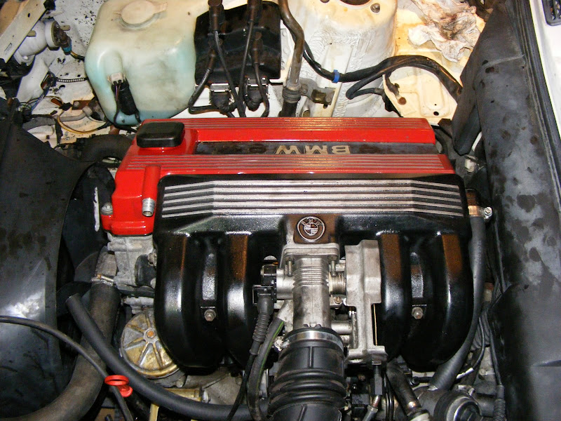

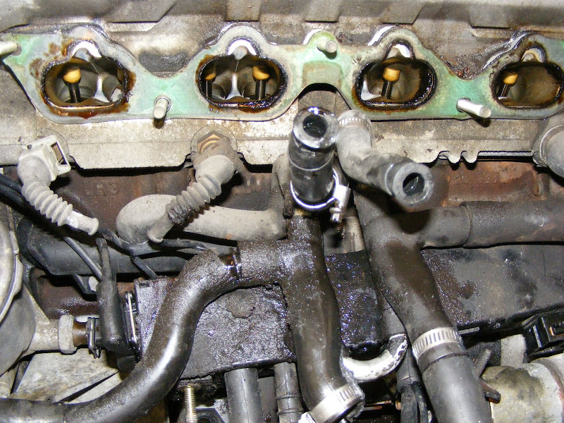

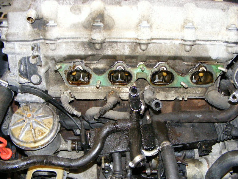

                        So anyway the newest develpoements with my E30 is that it decided to not idle when cold, but stall out instead. And also overheat.
                        So to attempt to fix the idle i decided to do the "mess under the intake" delete mod (here at M42club: http://www.m42club.com/forums/showthread.php?t=2742) which gave me the chance to do some engine part painting. of course the whole procedure (which took 8 hours) didn't fix the problem at all, but at least now my ICV is accessible and there are way less hoses, and no more stupid throttle body heating plate, and of course the cool colors which makes my M42 faster.
                        sprayed engine bay with degreaser:
                        power sprayed it out. yeah it doesn't look much different...
                        Also power sprayed off the hood insulation which was so old and rotten that it would crumble into dust if you touch it:

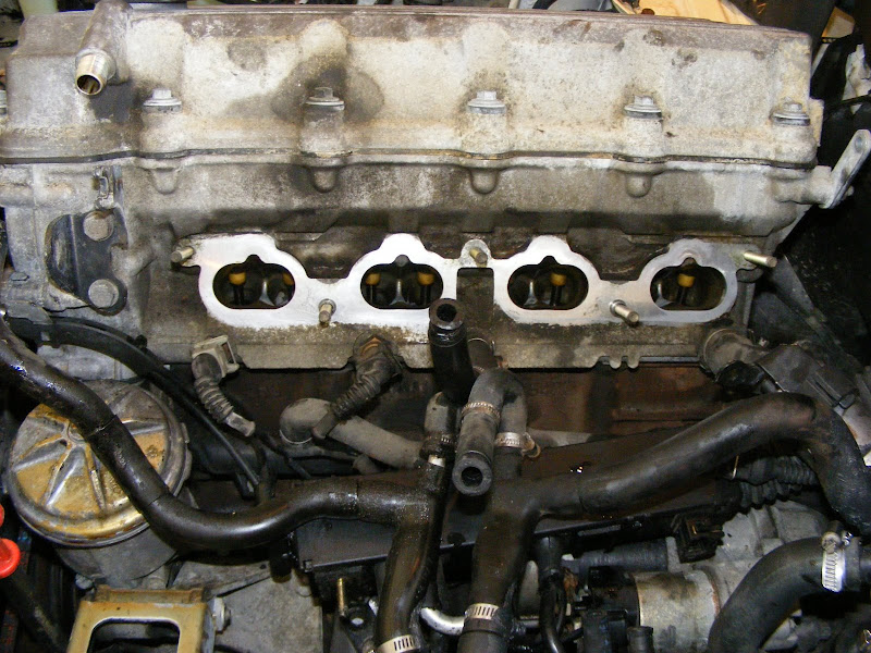

                        started the procedure:
                        nastyness:
                        cleaned out the ports:

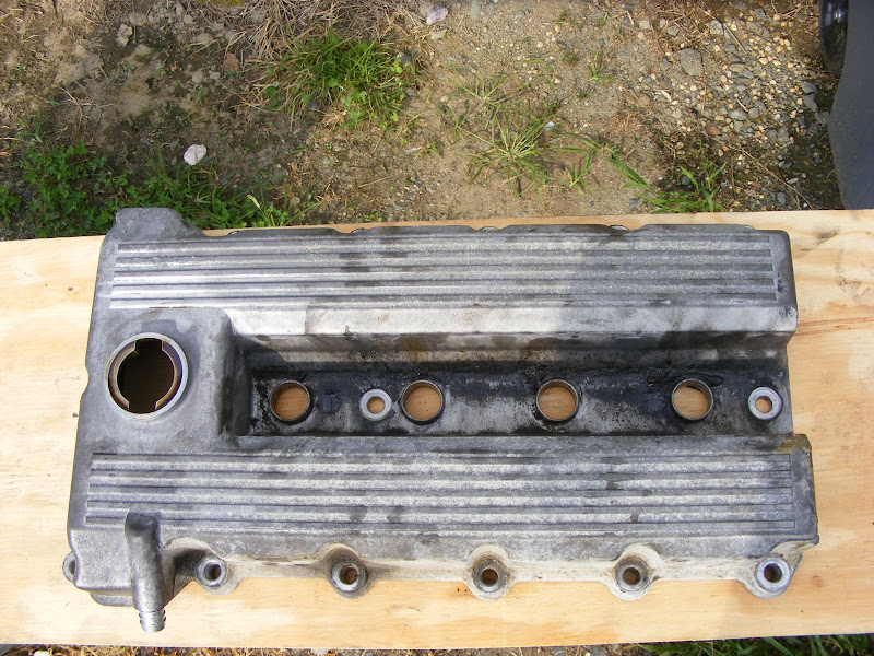

                        valve cover time
                        cleaned. (sort of)
                        cleaned out the lower intake and put it back on, there was TONS of buildup in this part, didn't take pics though....
                        back together!
                        So i am not sure i love the red valve cover or not, i am thinking about scoring a cheap extra valve cover to paint black, but that is later.
                        And yes i know that cone filter looks like moldy testicle cheese, but i am too cheap and lazy to replace it at the moment.
