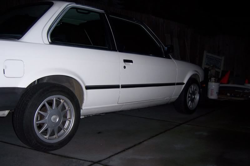

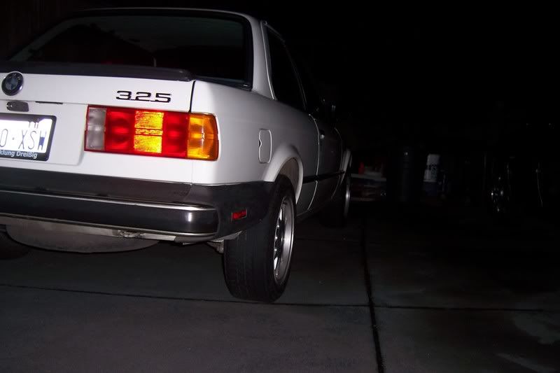

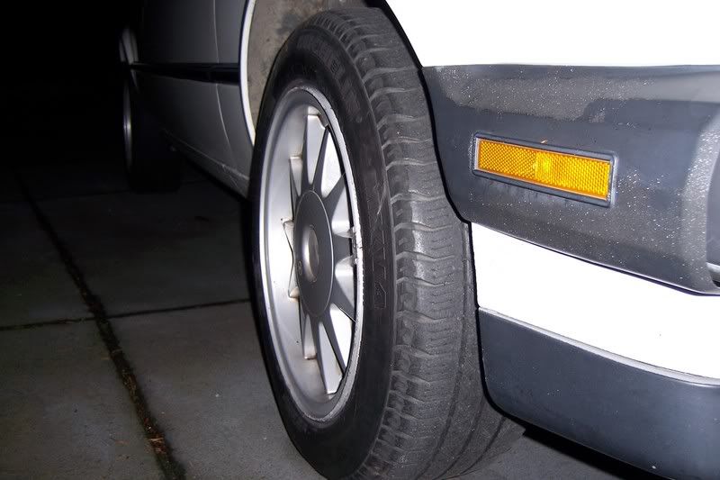

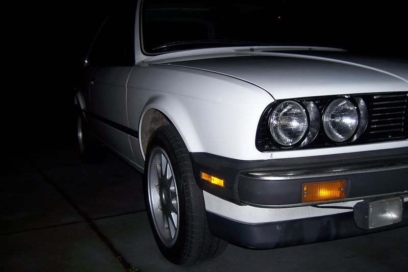

    I put the "Hartge" wheels on today and popped some dents out with my $20 dent popper from Fred Meyer:

      I think the car is going to look good once its been dropped a bit, with those wheels, hot!
