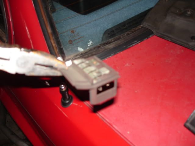

                  Had the camera in the garage, so i documented the Blower Motor Resistor Replacement.
                  First, (2) phillips screws holding on the bracket here for the Harness.
                  (2) 8mm nuts holding on this harness bracket
                  Then (4) 7mm screws, and the panel comes off.
                  There is a plastic cover that you need to take off. Clip that thin piece of plastic that connects the two ends, and unclip the harness.
                  The, rotate the plastic ties off to the sides and pull the cover off. It takes some finess, but the cover bends just enough to pull it.
                  I don't have a good pic of it, but the resistor is right in the middle of the blower motor, clipped to the case towards the bottom. I found it easiest to just pull it with pliers.
                  New one
                  Clipped back in.
                  Install is reverse.
