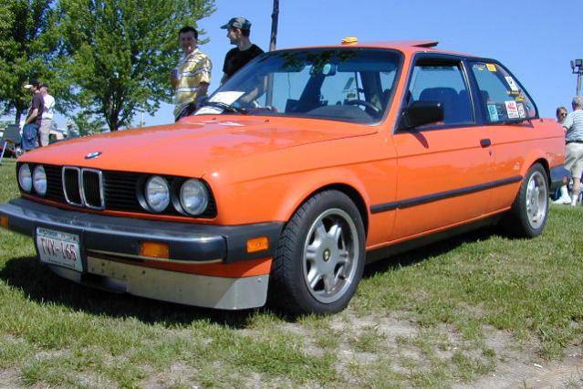

                  Just read through this thread -- great job, Josh! My track car project has been running on for about 3 years as well, so I totally sympathize with you wanting to finally drive the car.
                  Not to stir the hornet's nest, but here is a pic of my friend Jenny Morgan's car (of Roundel fame), in Inka Orange. It may not be what you want, but I think it looks really nice, unique, and not at all out of place on an E30.
                  Keep up the good work! :up:
                    Alex
                    Truth be told, I may have found a way to satisfy the craving for orange. There's an E21 down in the town south of me that I have passed for the past six weeks on my way to church. It's a 1983 320i resprayed in what it claims is inca orange though I thought all e21's of that year were phoenix orange. It's in pretty decent shape but the seller has flaked on me so much that I'm beginning to lose interest. I swear if he would stop making excuses and allow me to look in the car and test drive it, I'd probably buy it assuming no issues. It'd make a nice daily and there wouldn't be many mods to get it to a state the wife and I would like. Strangely, she was the one who urged me to go and look at it.
                    Of course, building up that M42 sitting in the garage might be fun to stuff in it. ;)
                      Alex
                      Inkabeast! I have some old 4x6's of that car from gateway tech in '00 or so that I need to send to her.
