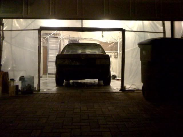

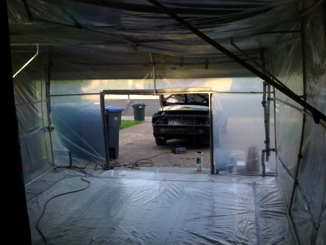

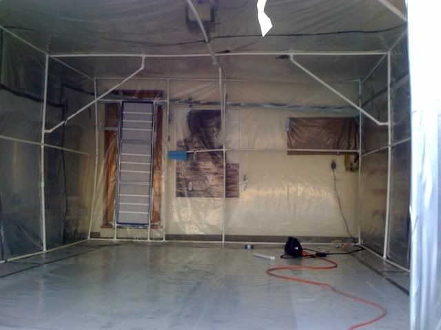

                              Jack I would recommend that you buy a HVLP gun and spray it yourself. You don't need to go crazy with a high priced gun, especially if you are just spraying the bay (and it is your first time spraying). I am working on painting my car, and my friend (with experience) and I are doing it in my garage. You could do something like this; but maybe on a smaller scale, for your garage. It's just 1/2" pvc and plastic sheeting.
                              And one with the car pulled in.
                              It has a door that gets closed and sealed, along with two box fans that actually pull a very good amount of air through the booth. Enough so that I don't have to worry about overspray getting on other parts of the car.

                                Yeah, I think I'm going to try the gun and build up a both like you built Jordan but maybe not to that scale. At this point I just need to buy the gun, I can borrow a friends compressor and just give it a shot. Unfortunately it will probably be a month or so before I can get to it with work and Easter visitors. Apparently I have to spend time visiting inlaws instead of working on the car. pshhhhh.
