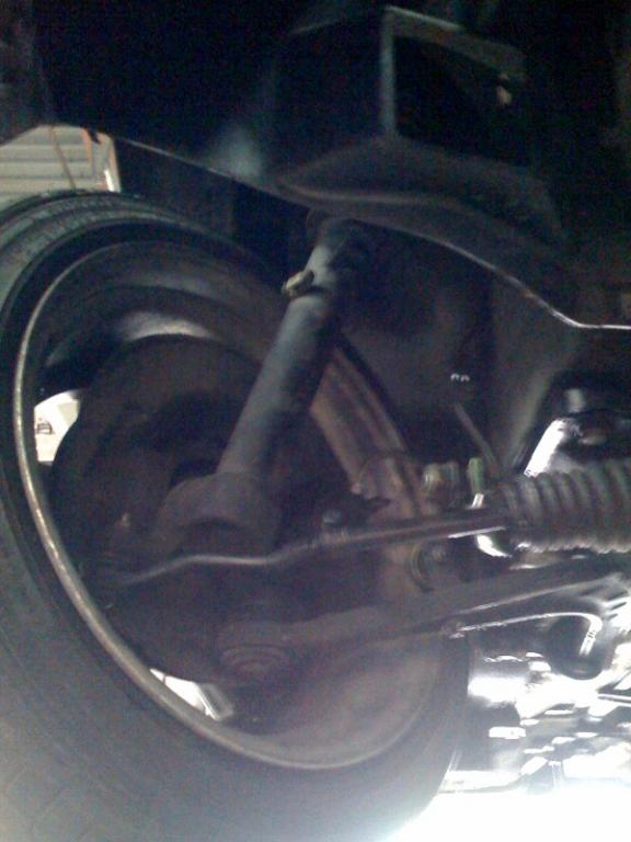

                                Long day.... running on 6 is kinda sketchy. It's 2:17am and I'm massive tired. Gotta be back at the shop before 9am. Just working out details right now as well as finishing the exhaust (almost done), finished driveshaft, wiring fan, etc.
                                Leaving one picture as a teaser of some new stuff. Got angle? :)
