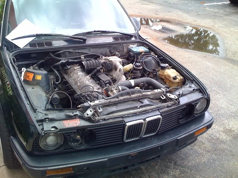

                    Here's the engine bay as it sits:
                    Injector harness wired up to the late model M20 harness plug for easy removal:

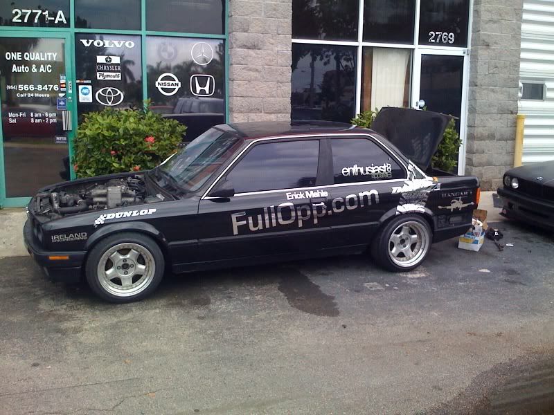

                    Car as it sits with rear suspension installed. Gotta adjust the height a bit more to my favor :)
                    Radiator clearance. We gotta see how we're going to mount it, but it most definately will have no room to move about:
                    That's all for now. As long as we got all the wiring correct, we are still seeing no reason why this should fire up tonight :)

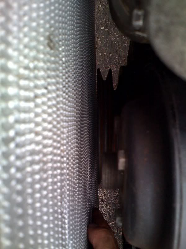

                        Cooling. Radiator is in and mounted, 16" pusher fan also in and mounted, most hoses already in place, but I need to figure one final hose out.
                        Headers also in, but trying to figure out our issue with the downpipes. O2 Sensor has been acquired!
