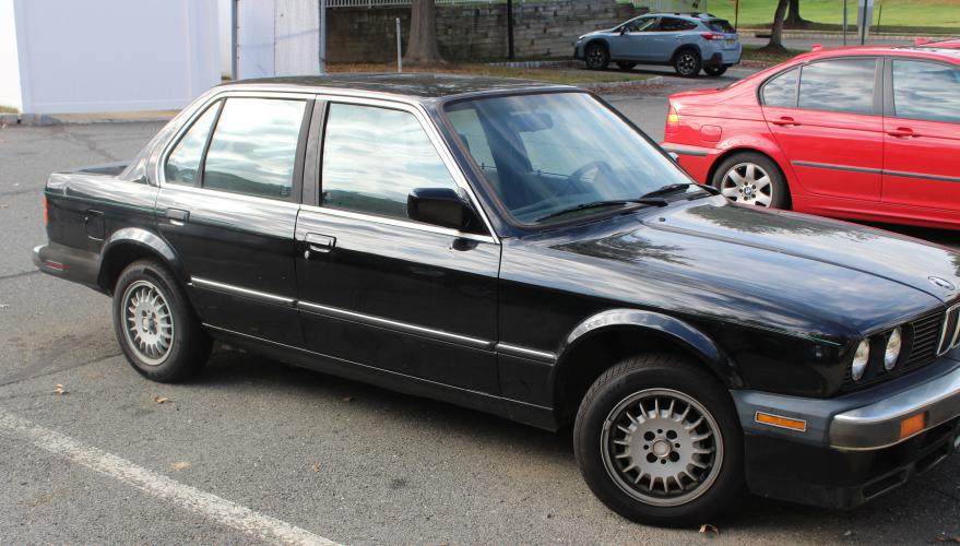

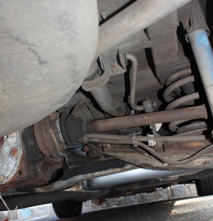

    I brought a 1986 325e w/automatic transmission about 1.5 months ago. Immediately upon buying it I had a shop (I do not have a garage so cannot and my neighborhood does not let me do any major mechanical work on cars) replace the following parts to make it driveable:
    - Gas tank (rusted out)
    - Driveshaft (rusted out, was causing a vibration in gear)
    - Timing belt and water pump
    - Fan clutch (fan was switching speeds)
    The car drives much better than when I brought it, but still has a few issues that would prevent it from being a reliable daily/long distance car:
    - Grinding noise coming from rear around 40+ MPH
    - Transmission has harsh shift from 1-2 when giving lots of throttle, shifts a bit smoother at light throttle. Downshifts are pretty smooth.
    - Metal banging noises when going over deep bumps
    - Seems to have a minor exhaust leak in the pipe connecting to the exhaust manifold. The exhaust manifold is highly corroded.
    Condition of critical areas of the car:

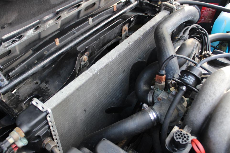

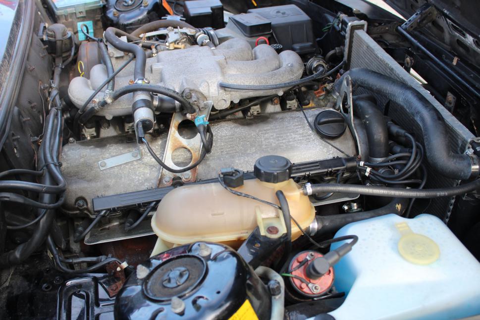

    - Cooling system:
    - seems to be in good shape overall
    - the metal fins of the radiator seems a little beat up
    - Plastic parts of radiator and coolant hoses are not brittle/cracked. Coolant hoses are reasonably soft when lightly squeezed even thought they look a little dated.
    - Expansion tank is discolored
    - Brakes:
    - work fine
    - Suspension and steering:
    - Suspension probably needs new bushings all around. Other rubber-based components also probably need to be replaced I also plan on replacing the engine and transmission mounts after reading an account of a transmission falling out of a car on the E30 subreddit
    - Body
    - Has surface rust developing in various areas which I am in the process of temporarily addressing with rust converter. I plan on giving the car a new paint job a year or two from now after I have the mechanicals sorted out
    - No rust holes (yet)

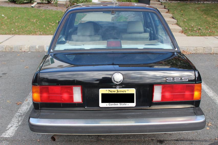

    Being an Eta I do not plan on driving the car hard, I just want to use it as a classic daily cruiser. The interior will need some work, but I do not plan on addressing that right now.
    How much money would I be dumping into parts/labor to make this car a reliable daily driver, addressing only the mechanical issues for now? And how long would it be stuck in a restoration shop for? Will be uploading pics of the car to give you guys a better idea of the mechanical condition of the car

                Sounds like you need every suspension bushing front and rear (I'd also assume struts/shocks), which is going to run you around a grand right there just in parts. Since you did the gas tank, you should have done the entire rear when that job was getting done as you'll have to pull many of the same parts to do the rear suspension, in particular the rear subframe bushings. The banging you hear over large bumps is most likely the struts bottoming out because they're dead, that or your strut mounts and bump stops are dead.
                Based on your description it sounds like you also need a new rear differential, which should be done with the rear suspension.
                Transmission shifting issue is the trans slowly dying. If you prefer a manual, you should start thinking manual swap as that trans will eventually fail completely.
                Not sure what the rest of the car looks like, but the 325e is one of the least desirable e30, are you sure you want to throw thousands at it just to get it drivable? There are plenty of vehicles (some for sale here on this forum) that are for sale from $6-10k that are much better platforms and given your situation lacking a garage or anywhere to do the work, I'd sell what you have and buy into something that doesn't need to be "restored". Jordan knows what he's talking about and I think he is probably even low depending upon where you are located and what types of shops you have access to. In the end the car isn't going to command the value for the money that you are spending.

                  Btw, here are more pics of my car and a video of the engine running. I got this one for $1800. It's a black and unmolested Eta, and exactly the kind of E30 I was looking for. I plan on keeping the car stock and enjoying it that way for as long as I can.
