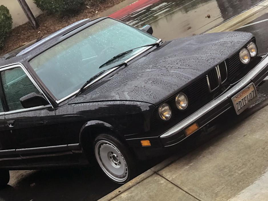

    IÂ’ve decided to abort the e30 mission for now. Got my hands on a project I am not in over my head with. I bought a pretty molested e46 330i 5-speed , traded it for this 528e. And I love it. 260k shown on the broken odometer . Its just at a perfect starting point for these cars : not perfect , time to put in work. Dash is fucked , headliner is yellowed , seats are nice , back seat bench is holey, things are out of place..but.. The car runs good , drives ok and is going to be a fun build

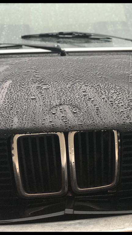

        It has a slightly damaged core support , from some previous impact , the only thing looking out of place from the outside is the kidney grille No pictures of the core support but I will take some just to show . It can be fixed but i’d rather have it replaced with a fresh unit . I need to start the routine M20 maintenance on this car . All of the above . She leaks zero fluids and has been running and driving strong . But as far as run-and driveability , here’s a list of things needed to do
