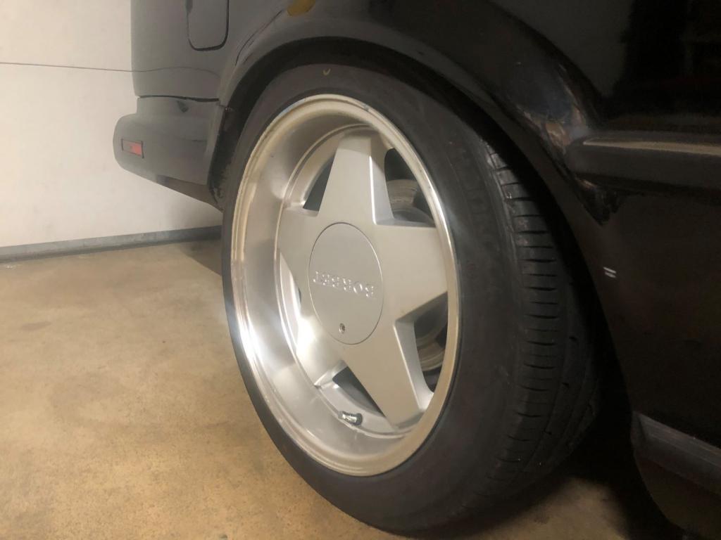

    Initially I made a set out of PLA. They looked great, but after the car sat in the sun for a day they warped badly.
    PLA material has a 'glass transition' point of 130 to 180 degrees Fahrenheit. That's when the material starts to melt. Sitting in a parking lot by the Van Nuys airport must hit that mark, or come close to it.
    This is the PLA version (pre-warping):
    Click image for larger version  Name:	2020-02-24_07-54-37.jpeg Views:	0 Size:	53.3 KB ID:	9936750

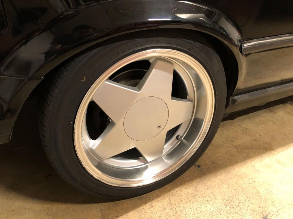

    I had second thoughts about using the word Borbet on reproduction wheels, so the next version out of ABS doesn't have any letters.
    ABS has a glass transition point of about 220 to 230deg Fahrenheit, so there shouldn't be any future problems with warping.
    Click image for larger version  Name:	2020-07-05_13-03-58.jpeg Views:	0 Size:	84.7 KB ID:	9936751
    Click image for larger version  Name:	2020-07-05_13-03-41.jpeg Views:	0 Size:	80.7 KB ID:	9936752
    The paint is from a rattle can and not a spot-on match. There are many things about the car that aren't perfect, so this is fine for me for now.
    If/when I make another set I'm thinking I may use the german word for cruiser: "Kreuzer" if my google-fu is correct, or maybe the Grateful Dead dancing bears in a circle. That's the thing about 3D printing: your options are almost limitless.
