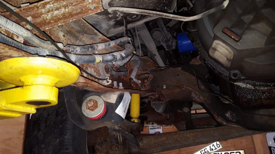

    Let's look underneath!
    Hmm, what's that odd thing? ENHANCE!

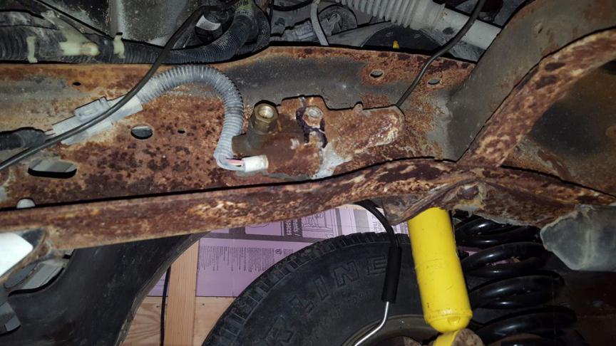

    Great...looks like someone bypassed the ABS pump. At least it has new brake lines, shocks and front springs...
    OKAY, that's enough of that, the more we know, the more we'll have to fix. Lowers lift.

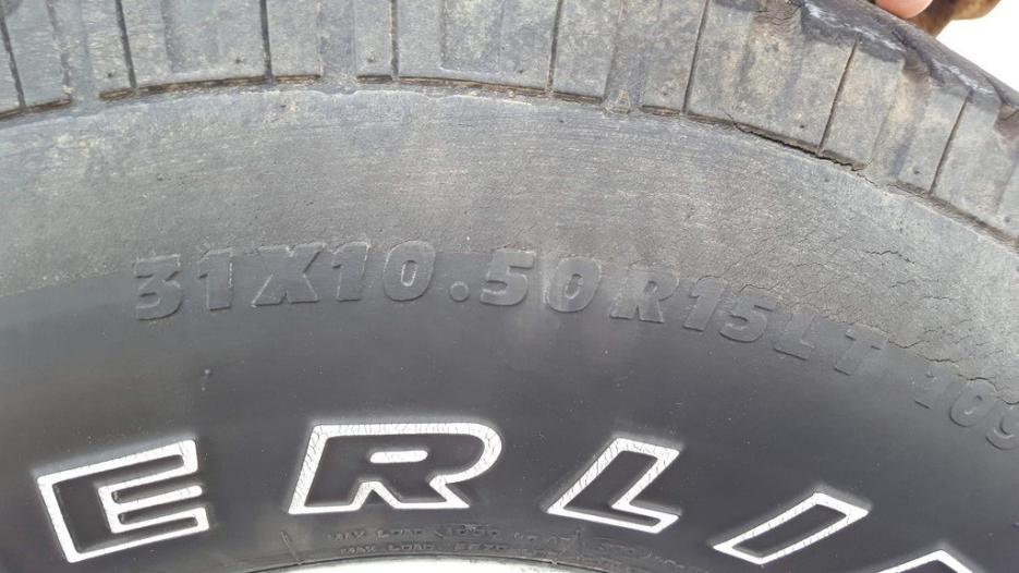

    But at least it doesn't matter if I flat spot the tires, and maybe they already were since they drove like they were a rendered in a video game from the late 90s.

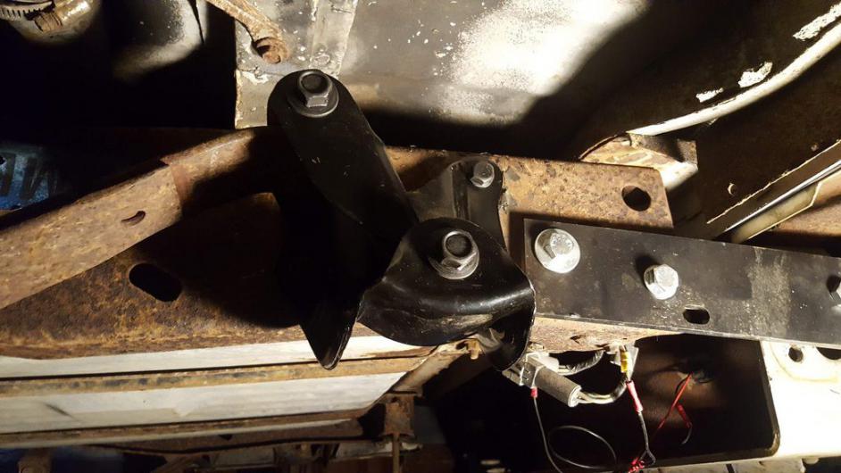

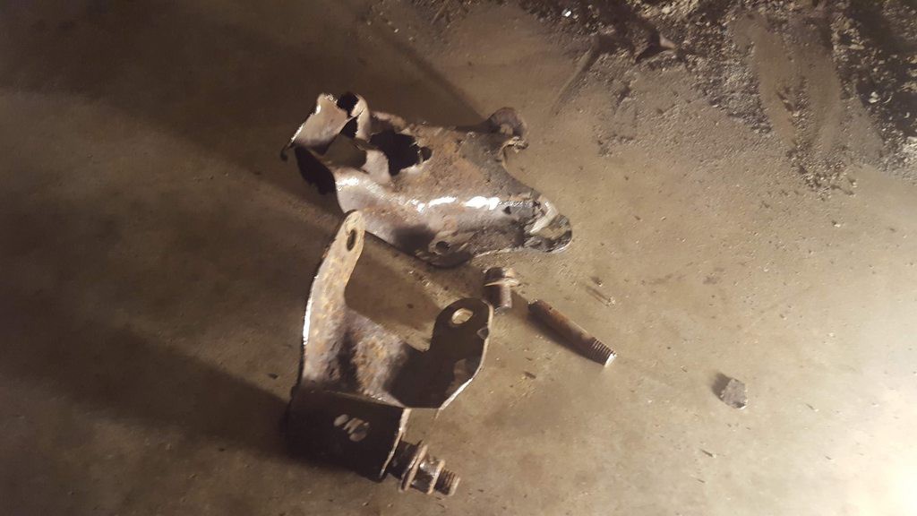

      While this truck isn't exactly mint, I didn't think it was a clunker until it started making that exact sound.
      And, survey says...rusted out leaf spring mount twisting under load. Didn't get any before pics since it just looked like a spring mount, but the cup at the bottom holds everything, and that rusting weakened the component over the years.
      So that took something like three hours, three cutting discs, and all of my sawzall blades. It was so unexpectedly bad. At least the parts were something like $30. The fatal flaw is that the lower cup holds all sorts of crap and rusts out. Great design, 10/10, and now I know why most people with old trucks have a torch rig in the corner.

      There, all better, and just ignore that massively suspect wiring in the frame.
      Now let's slow down some of this rust. So I pressure washed the entire undercarriage, got horribly filthy, found all of the places dirt likes to hide, and sprayed most of the rusty bits down with Fluid Film/lanolin oil. After five months it looks something like this. Very nice, a real improvement, and just ignore that other spring mount, it's fine!

                    It's neither especially slow or anything approaching fast, but isn't bad for an old truck with a base engine. The video attached is WOT, or nearly in 3rd on the highway.

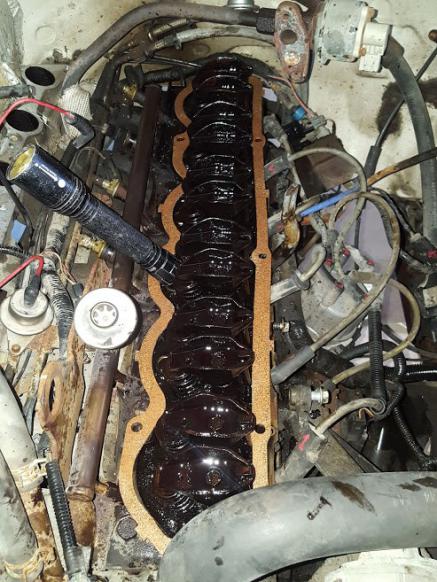

                          Dinosaurs, as promised, and as you know, they dwell within all poorly maintained engines.
Name:	aNK2zGG7DTQJOEqbvOBuFLkI0k3Aer_t7VYfi0zrfNZhc2za8kmliMfWmlwHLwq5X3p8Lt0kAecZIF3tTolAFq4EVrIHK7uR8Piap7eVTji8KBcxq6hTzqr6NYrjE62ZU9toIJCvlkbpVhrJgK0uN7ShF-YJCeKiX8Xm4IPhr0bB3GNEFHDSA39ZF2MiKgocrUfjtO8eFQo9GVnusSRRGHyvEzSABq7zPMTIsRUOqDwRaom062qIDJ8v2MFg4lf
Name:	eDSwA0sQkxRD83eqJeaai8lSYyhHB9lE-CWcIrLz4w-aV0hYJbFgSZthZl8bSwLNK_VH0NGIvgUYZ_dGU2PrYVgnJvuSXT40dtFF4qdMUjIN_OUTaiV0sAQrNaH0LQAUPyRSm0DAKVoX5ihF6Q6wim_C51vdcen2P8-PbI-SJ9nASLokeTZIjvRIDlOAHnRG2sJv-xd7Y7jADkGzp--3YNYhWLutDk17OMhOJ2uFc6ezVgNeADxXmnUCfG0u1OI
                          Found the vacuum leak too!
Name:	lZ0ox-yYODUAs9hej3RCgP5hup4EQfnH5cj7Za25tmpgQew9danC3NCqSWaLg6Sk-dB7QbtX6YMd4x9XTFgfEYnz2kMWckv77VI8CzraZMqGGzOOM8RCKw59pVuIR-7x0OLsaNIjJ1NY6ULNmtCnccFnL2_XWNCf8CFAlR8_TxRsYXMhKxNpvQYmmPq034iJMLreGjFj2D9cI6Iz46yGmYWN5QiVWkMSn_fC3moXIkoxSTZaV16tM1VCE_ABuY_

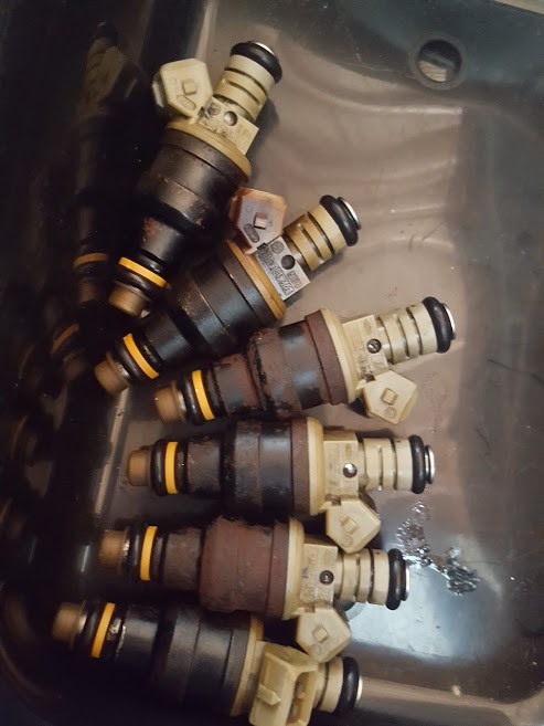

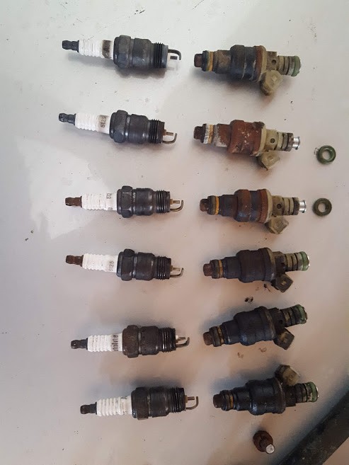

                          Pulled the injectors to give them new filters/seals/spacers/caps. It was worth it. Plugs looked pretty good, which surprised me from the way it smells. Must be a toasted catalytic converted.
Name:	Vh0LsHG80uAq7nbbXBvhe4kjDLPETqcmNoToWEEC5VRwYPmeIoQuyOlB8q8bX3hqTkVP-9y-Xc74MpsCjemMX72zelsjer5T9q7zg272r7CFTKOxI396ydElBYwZlsbzlb5rNCf4qHB8jbZQ-XMbwrkK3yHWb-qVTbq29MVxRSjDLF-2tKmdGAJZ_DdHjoqlCKpqzd9omuJ5CElNmhI5GKyDX7eXbDvEpaG_66AT31DSoFu4cRF5WRAQGFTzUXE
                          Nice and "completely rebuilt," if you're on CL at least.

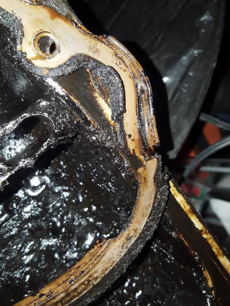

                          At this point I was going to show a picture of the before in the valvetrain, but the after looked mostly the same in photos. Between a screw driver, a pick, a brush, and a small vacuum which is now pretty much a write off I was able to keep the larger carbonized crud out of the return passages.
Name:	02Oe3zjhQ-3jUIYrEbnp8B1S52uqfZQKgWyGliS8wpocXgbrqfq3wPIH2uanT_cfCcLhM2gOOFnUxcpH3_-SQo1VA5sRdERj-vQ4kES0mw6P6pBY-JlMhj9c15nABV7pvjjsCfHwb6EdmRo_Mx8e483UoPCU-9Bq-PgDq8ME-nYwiE3_r7q8Ov1I0yEdrk464qvKkvIuXfLXrgfBGL_xlsUXHP9F9c9Nrgy_vTVEy3C9Ib04r2K3eLLfqMi5qCZ
                          So, at this point I'd like to thank Ford engineers for being completely inconsiderate jerks. Valve cover gaskets that cannot be retained, require the VC to tilt and then drop in to place while completely obscuring the gasket make it so fun to see if any of the long non-fastened sections aren't in place. Bleh, and at that point it seemed like oily dreck was everywhere.
                          At least the actual mechanical components seemed okay, but I am sure a lifter or two is fairly worn out.
                          As we'll sort of see in the next installment the pushrods and the cam are kind of okay too.

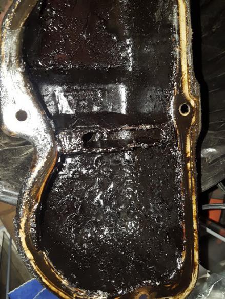

                                Tackled the pushrod cover and oil pan next.
                                No completed pics, it was messy, dark, and all I did was repaint the oil pan. I can say that the little temporary plastic thread in gasket/pan retainers are amazing. Overall, the bottom end looked okay for the f***s given per mile by some previous person.
