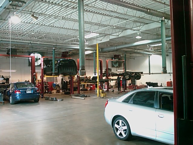

    My friend is a mechanic @ Jim Ellis Audi and this was going on in his shop yesterday (all week in fact). The frame in the middle is bent, the frame on the right is the new one. Basicly two mechanics removed the "body", rolled the bent frame (motor and all) to the lift next to it, and are transferring everything to the new frame. They will then lower the body back on the new frame. This is a 36 hour job, and these two are apperently the best at Jim ellis when it comes to this sort of thing. I was amazed when I saw it.

    looks like an f150
    maybe?

      I think it was a big ass chevy. Not sure though. I was standing in my friend's bay, and didn't want to walk over there for fear of getting him in trouble.

        wow, i am suprised that the insurance did not total it. usually a bent frame means total unless it is a big expensive truck like a new diesel dually or similar. 36 hours is kind of low for the insurance co to pay for that job though.

            My friend was saying it was low, but that these two could do it in less time. You don't really "milk" a job like this i guess.
            Trent, I guess it isn't that big of a deal, he said they do it alot on bigger trucks. i was completly floored however, I didn't know this sort of thing was done! Can you imagine going up to the parts counter and ordering a bumper and a FRAME! LOL

              dodges used to pay 50 hours and up for that depending on how good the writer was. so 36 is low, but insurance companies are tighter than a ducks butt these days so they may have combined labor opps now to screw you out of some of the hours.
              it is funny, you order the frame, then usually with in a week the parks guy shows up in you stall with the forklift and a big assed truck frame on or hanging from it. "where do you want it?"

                  NAH, it is not that big of a deal as long as there is no wiring damage to the harnesses, it is pretty straight forward. just start bolting it together, drop the cab on the frame, align the bed, finish putting it back together and make sure everything works, get it over to alignment, wash and ship it.
