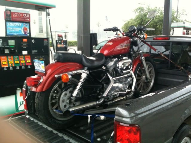

                        Picked up my canvas today!! '99 Sportster 883.
                          Yummy..
                          I could chop about 60lbs off it as it sits..!
                          Wake that little motor up..

                            I'm very green to these bikes and building them. I don't even have a motorcycle endorsement on my license yet. Engine mods will probably wait a bit. However, the bike has "Screamin Eagle" pipes that I don't totally love the looks of. What 2-1 pipes do you like?
                                Ok, you and I need to be friends. these bikes are a blast to build..
                                there like a small block chevy, anything and everthing you throw at it makes it run better than it did on the show room floor..
                                You can do anything to them..
                                I have this carb fully jetted and setup for you + two extra jet kits and a stock load of parts avalible..
                                I'll give you the carb & jet kits for $60. + shipping.
                                I also have an extra set of cylinders and pistons for the 883 in black
                                I have valve covers and much more crap sitting in my Shop wasting space. So at some time if you want them let me know..
                                The pipes you have are crap, the SE pipes are stockers uncorked..
                                Any 2-1 pipe will do better than what you got..
                                Find one "you" like..
                                I have a stream line seat and a few other thing to make it look better you can have too..
                                OH i think I have a set of higher lift cams for the 883 too but I'll have to look.
