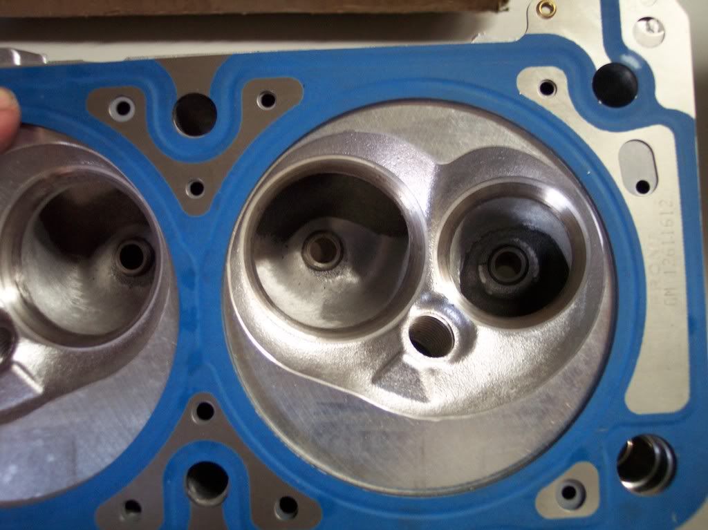

Here's a pic of the 3500 gasket on a 3400 head ;)i have a couple of 3400's that need rebuilding. i still have to find something to put them in. i was trying to convince my good friend to swap and build a 3400 in his 89 rs/camaro but i think were going to do the sc3800 long block and turbo it. but it's still talk for now.

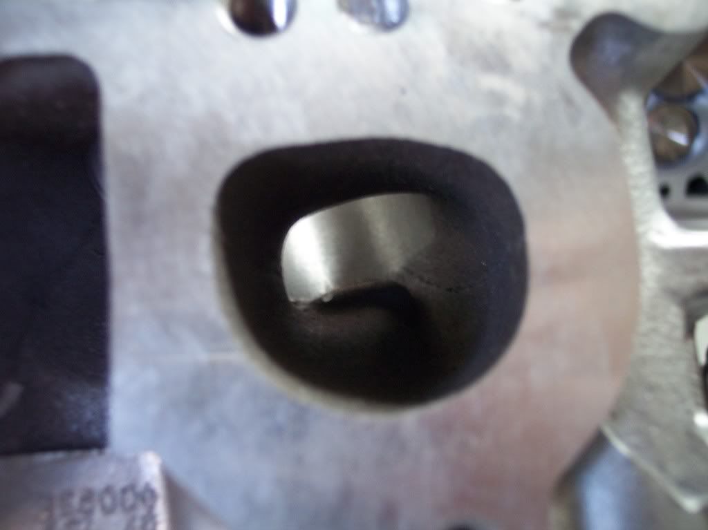

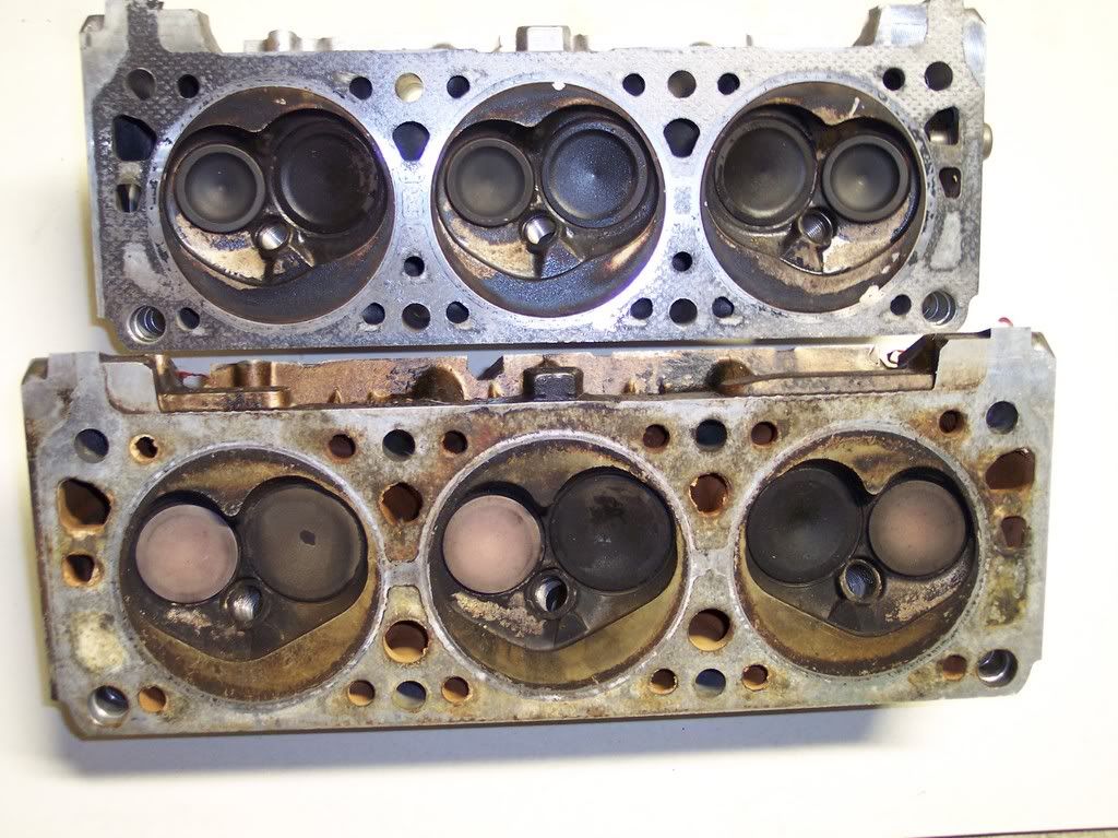

The port roofs were raised quite a bit, the exhaust ports were re-designed and the chambers made more efficient...
The 3500 heads flow well over 250CFM bare and 175CFM with the manifolds attached (minus throttle plate). The bare 3400 heads don't flow as good as the 3500's restricted by the manifolds.
