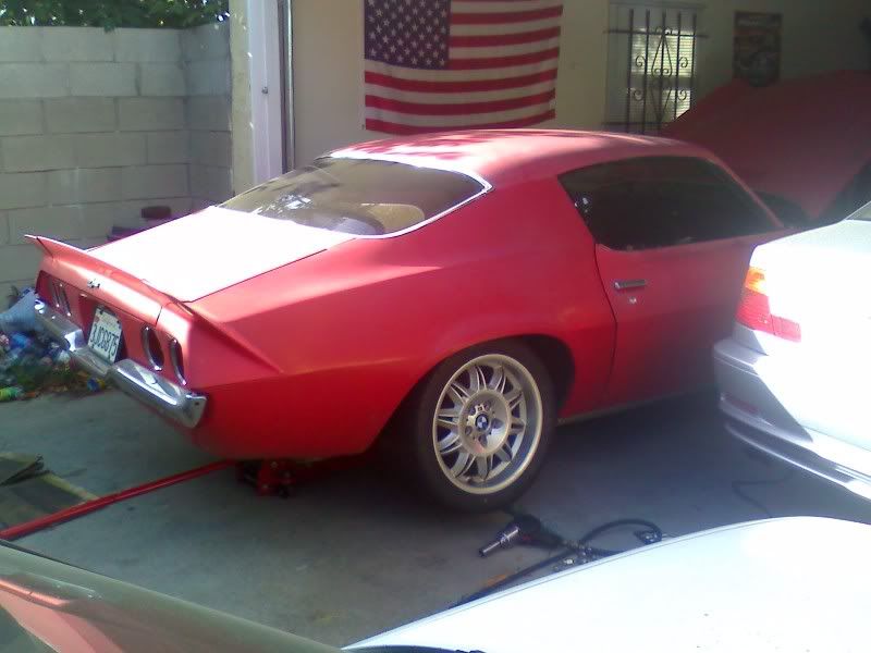

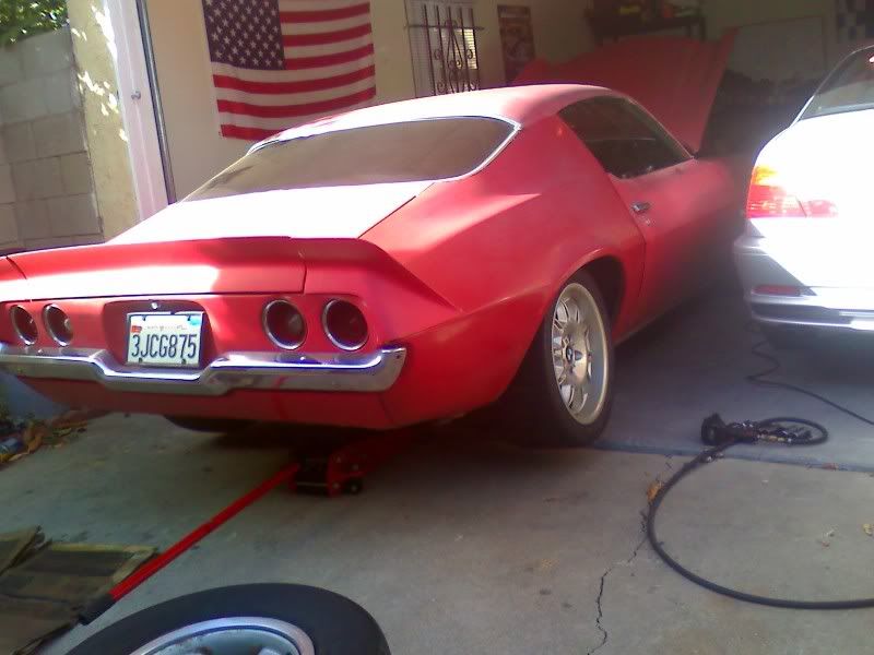

    M3 wheels on a Camaro
    this is the first car i ever owned. had it since i was 16 years old. built it to drag race runs 12.4 1/4 mile
    it was parked at my parents for the last 5 years. they finally gave me the boot. so its at my house now.
    anyways i was bored today so i took a wheel off and put the M3 wheel in its place just to see what it would look like. i think it looks pretty good. wouldnt work without wheel spacers though. thats a 17x8.5 m3 wheel

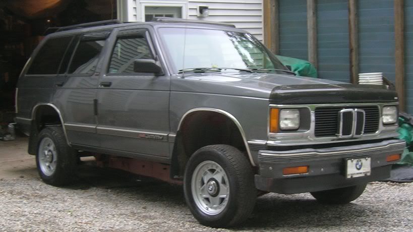

                yah, cause some S10 people was putting BMW wheels on their trucks, And they ended up bending thier studs.
