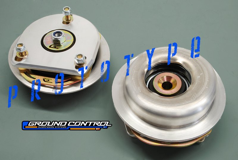

    Ground Control TOURING camber/ caster plate.
    Features:
    A lot of camber adjustment.
    A little bit of caster adjustment (enough to make the car go straight, not enough to experiment)
    Spring perches included (stock, 60mm, 2.5 inch)
    18mm more suspension travel than stock (important for Bilstein)
    11mm* lower spring height (I couldn't quite get 15mm like the dropped hat because it has to slide)
    Economical. (I don't know the price, but less than any other GC plate)
    Waterproof steering bearings, made in Germany.
    100% noise isolated, not a race plate with a stock spring perch adapted.
    * give or take until I'm done testing.

    yummy. send me a set please. I need a set for the race car to replace the crash plates I have ran for the past 3 years

        Coolio. How much road noise is added with the regular plates?
          No noise is actually ADDED, however the strut shaft intentionally goes through a bearing, so noises from strut oil, wheel bearings, brake calipers, tire huim etc. is more directly transmitted.
          But to put it in perspective, if you roll your window down 1 inch, that would make more noise.

                  I may be very stupid, but I thought that stock plates also had bearings in them?
                    They do, the bearing is isolated from the car by rubber.

                      Im interested! Ive got my first set of GC plates still. 2 sets of needle bearings have been eaten up by them. I gave up :(
                        Call me. I bet we can fix it in 5 minutes. The CCP spacers need to be rearranged, thats all it can be. The needle bearings are rated for 9,870 lbs constant load each, and an e30 just wont put near that much force on them.
                            Yes thanks, I get the concept. There's no rubber insulation between the strut shaft and the body of the car, which when compared to stock strut mounts will amplify road and other misc noises. So, call it whatever you want, the result is additional noise.
                            Cracked windows aren't really a good basis of comparison, I just wanted to know if it was a nontrivial difference from stock mounts (or these plates) to pillow ball/spherical bearing style camber plates. I've heard yes and no, I'd imagine yes. I've got a set of GC plates already but I don't have a good control group since I never had good condition struts with stock mounts.
