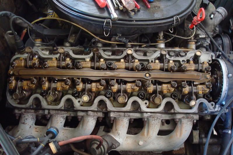

      I personally don't believe the 12 valvers are more robust. The 24v had better fuel injection/ECUs and ran a bit quieter with less shake.
      24v's are also pretty easy to turbo/supercharge and can take a lot of shit from what I've read.
      I should mention the ASD diffs, which can be changed from about 25 to 100% diff lock with the flip of a DIY hydraulic switch.
      (not stock, taken from E's and C's)
      The 12v head is a lot more robust than the 24v. All you have to do is look at the quality and thickness of the casting or the headgasket failure rate. The 24v is prone to warping. That said, if its healthy the 24 will be a lot easier to squeeze top end power. Just don't try to put a turbo on it.

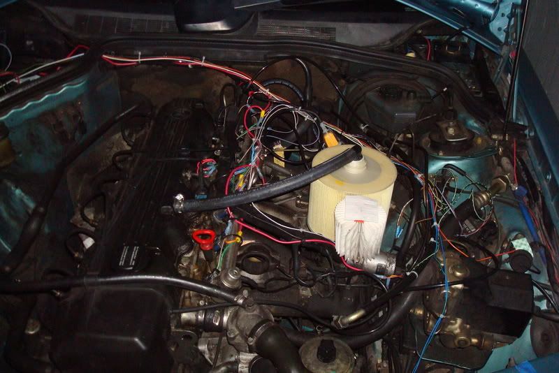

      I picked up a 2.6 manual for $850 last spring and I'm running MS2 on it. All the EFI parts are available in the JY including a 24v fuel rail. The plan right now is to get my hands on a diesel turbo manifold or swap in a 3.0.
      The wiring is still a work in progress. I have 5k trouble free miles on it so far.

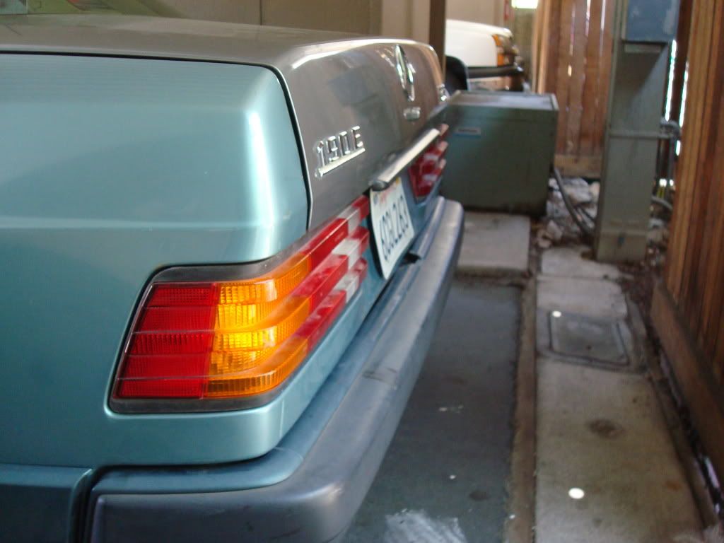

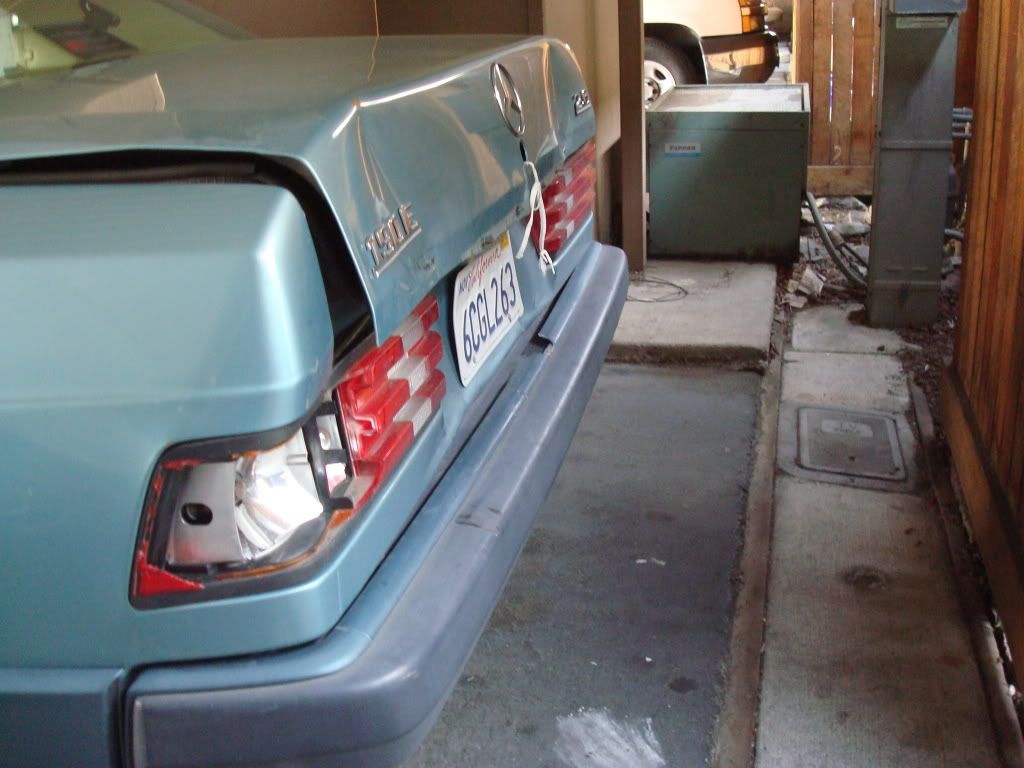

          It looked pretty sad when I got it.
          Rear damage.

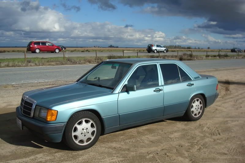

          A few days later. I'll probably repaint the lid this summer.

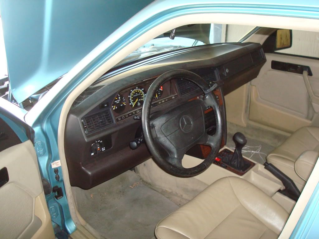

          I've since replaced this steering wheel with a smaller diameter wheel that uses the same airbag.

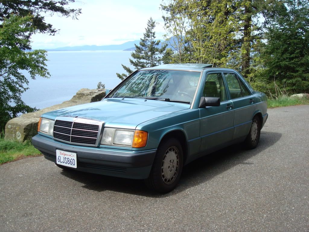

          A couple of months ago with E320 wheels. I also have some E320 4 pot brakes to install. The ABS module and stock brakes are identical (except for the bolt pattern) to the E30.
          Other than the timing chain the engine is a lot like the M20. It was still running KEjet at this point.
