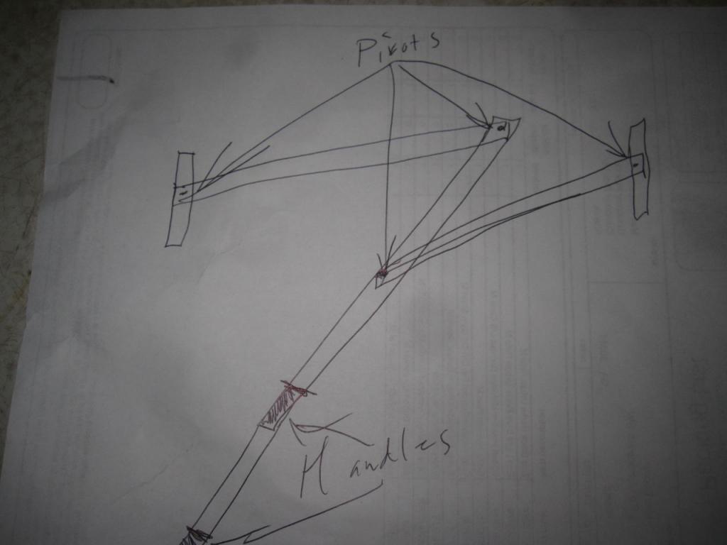

          Originally posted by mamzak
          I do like this idea, the only problem with that is that on stuff like an excavator, the final drive isn't like a Caterpillar dozer, with space on the unmeshed gears. Your idea would work for a D9, but probably wouldn't work for an excavator. I'll show you what I mean:
          Unless you used something that grabs onto the outside of the rotating 'gear/wheel' and tightens down. Then you could use it on different diameters and and type of round square etc. Sort of like a 6-8 fingered closing fist. Put that on a threaded shaft that as the motor turns, it tightens down.

                Originally posted by Van Westervelt
                Unless you used something that grabs onto the outside of the rotating up and tightens down. Then you could use it on different diameters and and type of round square etc. Sort of like a 6-8 fingered closing fist. Put that on a threaded shaft that as the motor turns, it tightens down.
                AHA!
                Very smart. I really like this idea!! Sort of like a giant vice-grip, that closes in from 4 sides?
