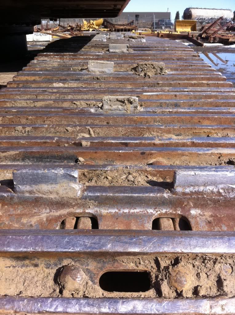

    Basically Ice Lugging is when welders weld small rectangular pieces of metal onto the tracks on heavy equipment (sort of like a cleat on a soccer/football shoe) to give it more traction on snow and ice.

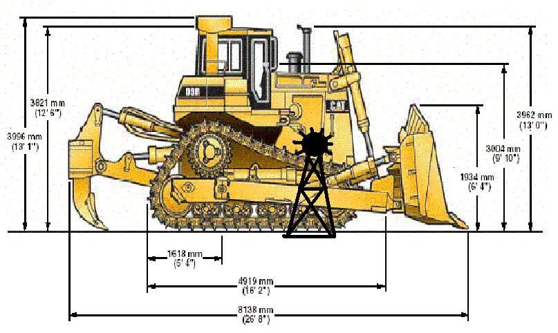

    Here is a picture of a D9, probably one of the more common pieces of equipment to get ice lugged, however this also has to work for excavators, pipe-layers, etc. It needs to be a universal solution.
    Here is a picture of Ice Lugs:
    My ideas so far:
    -Use an overhead crane to rotate the track. Using a 2-leg chain with grab hooks on the end you could grab the track at the bottom on the rear end and lift up, rotating the track
    -Some sort of a winch system that would place a cable all the way around the track, encompassing it...and then as you reeled the winch in it would turn the track
    -Some sort of a hydraulic finger built up on a telescopic stand (to account for differing machine track heights) that could insert itself in between the track ridges and spin 360 degrees, therefore rotating the track.

                      Why recreate the wheel? Is there a way to manually rotate the upper drive sprocket thats already engaged? If so, then all you would need is to use an electric motor to drive that from either the face or via its own unmeshed gears.
                      Either way, thats a hefty load for an electric motor.
                          I do like this idea, the only problem with that is that on stuff like an excavator, the final drive isn't like a Caterpillar dozer, with space on the unmeshed gears. Your idea would work for a D9, but probably wouldn't work for an excavator. I'll show you what I mean:
