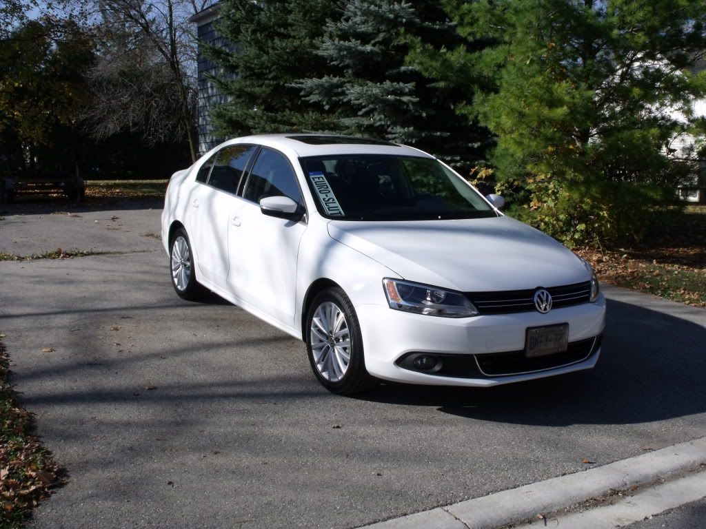

    Ive been considering an older jetta TDI myself recently, decent power, great fuel eco, great reliability, huge aftermarket in all forms, and the car pays for itself after a short while if you get a good deal.
    they're really simple to work on too if you have a basic understanding of how the engine works. Can even do a veggy conversion and set up a WVO gas station in your garage.
    eurotrash jetta TDi ... may end up talkin myself into pulling that trigger eventually, subarus are gas hogs that are over hyped unless you're rolling an STi or super modded wrx even then there are better options unless youre just a fan (nothing wrong with that)

      ^^ Just went and looked at the new jetta tdi's. Really, really cool esp. for 24k.
      • CabbE30
        • Aug 2009
        • 2358
        #33
        And they come with a 6-speed mt!
