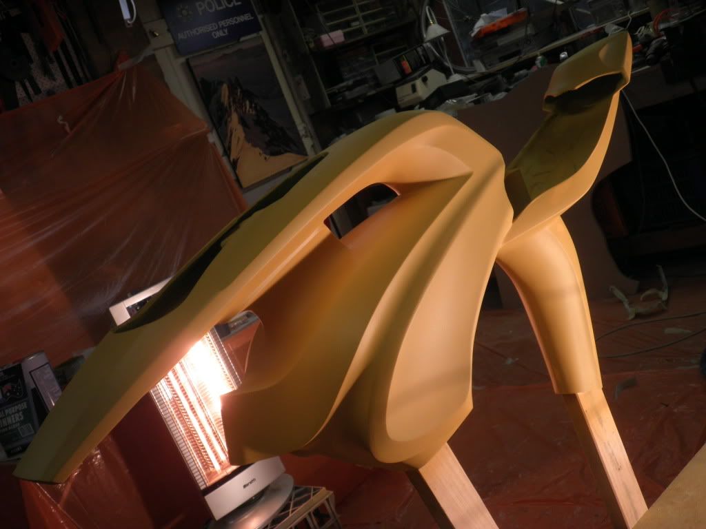

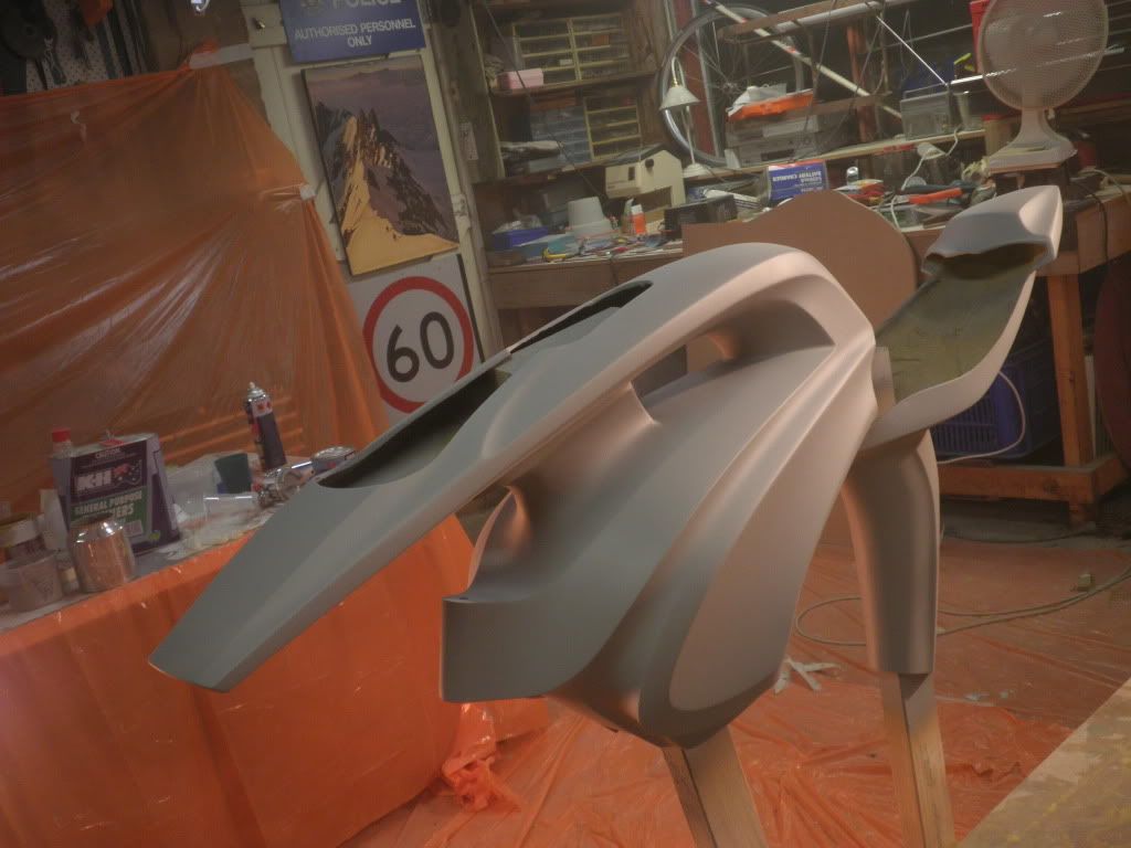

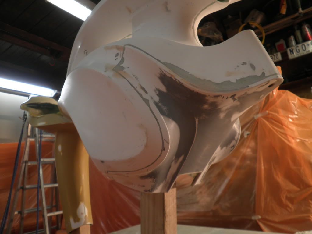

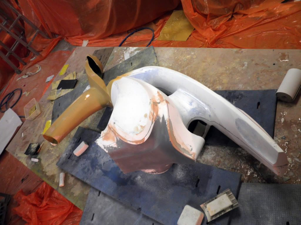

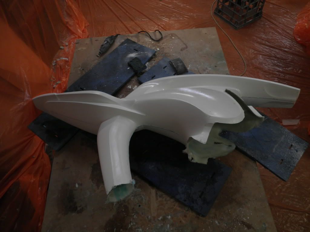

    ok another update to show some of the final stages of fiberglass..
    I'll try skip through this bit quickly since the bike is finished, and I know you will want to see the result!

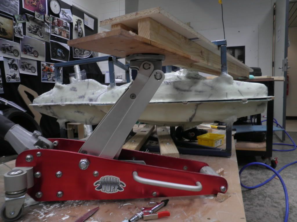

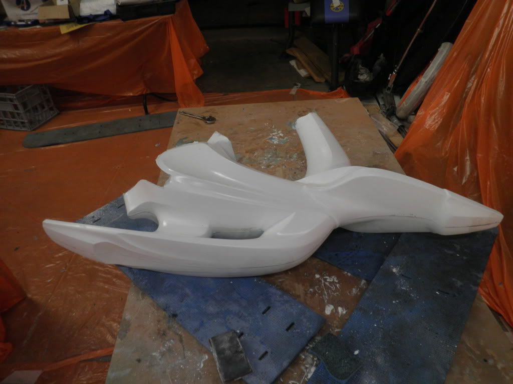

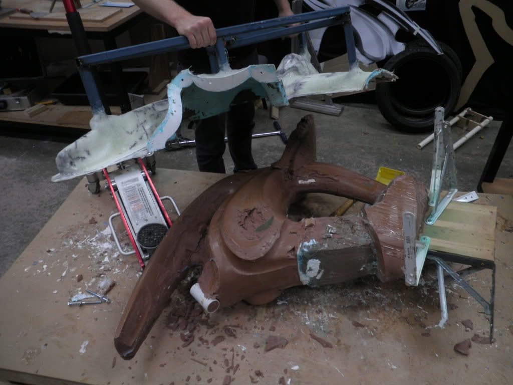

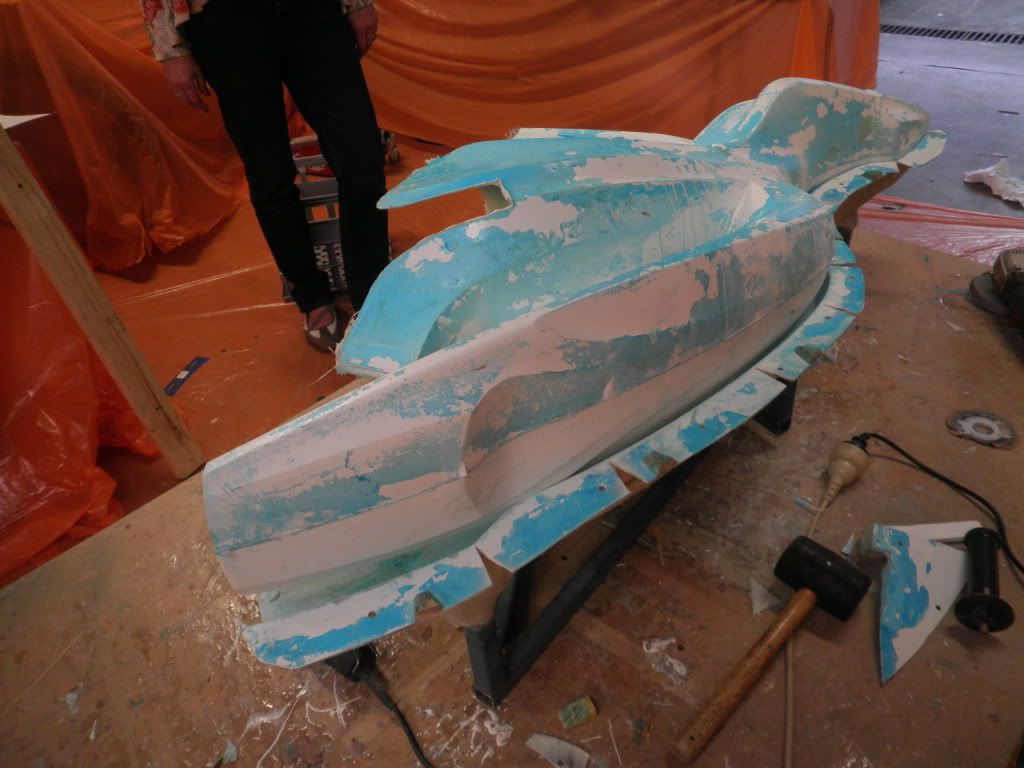

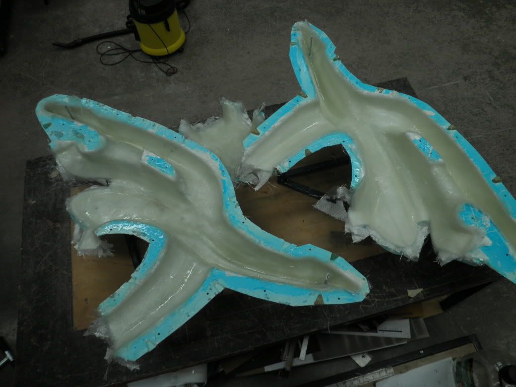

    Prying the moulds apart was a 2 day job!

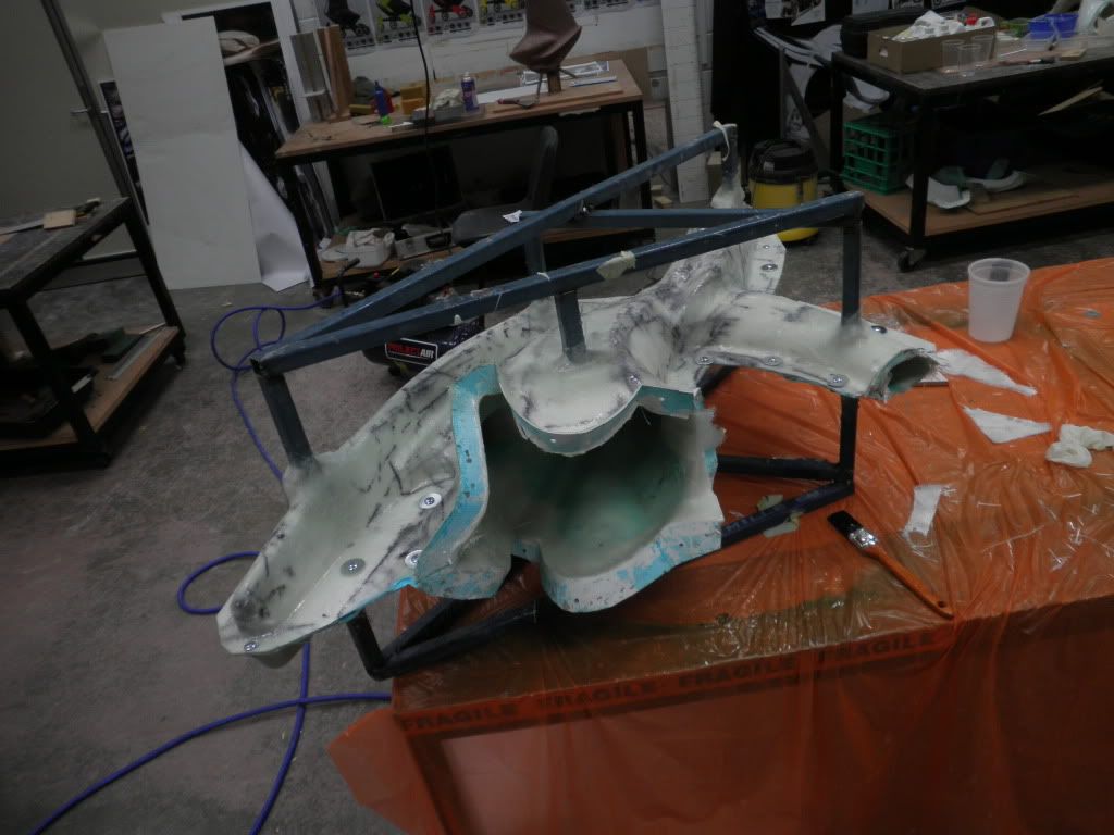

    After moulds are prepped and laid up with the fibreglass parts:

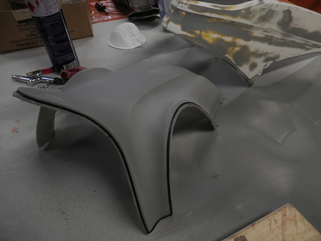

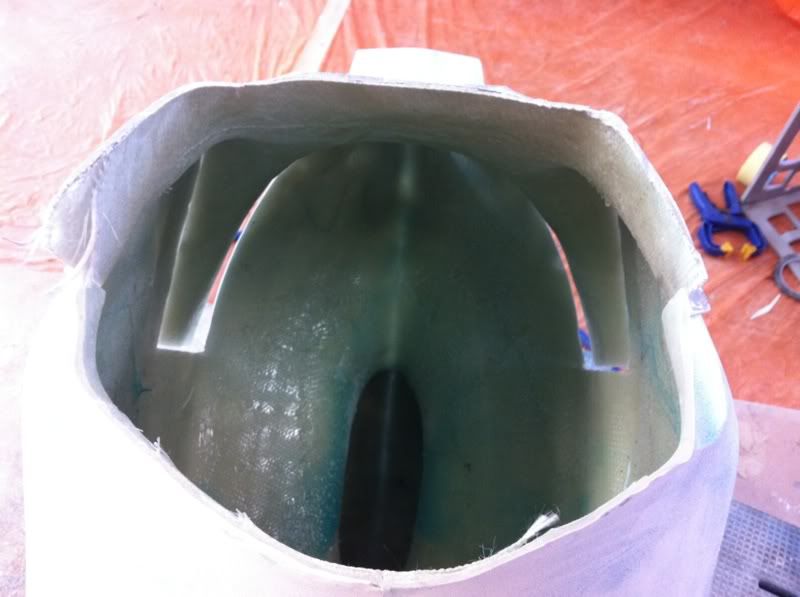

    I decided to bond the parts together inside the moulds to keep everything alighned.. was just hoping the moulds would come off without destroying anything... :/
    Bonded together with epoxy resin:

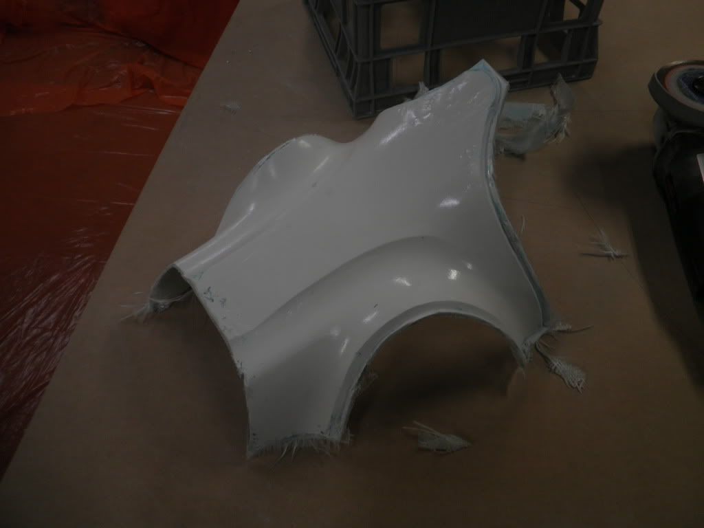

    Moulds apart eventually! (don't underestimate how difficult this was, advice to anyone making moulds is use a fuck load of draft angle, you can never have too much...)

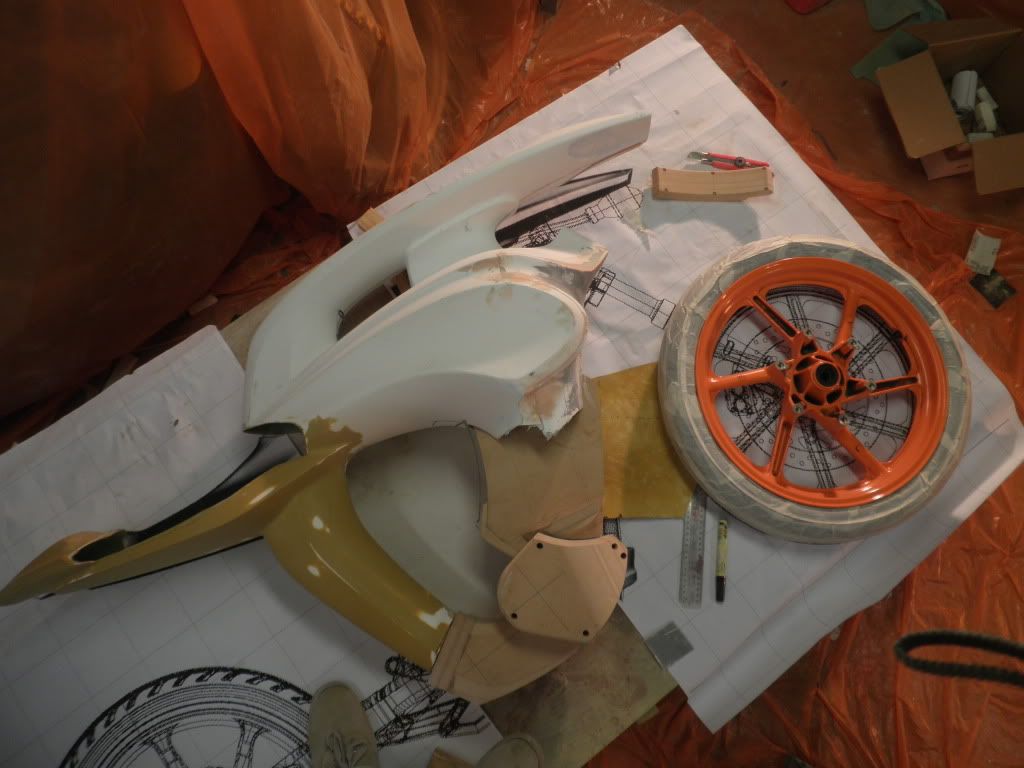

    This bitch of a piece took a lot of work to fit but, got there in the end, you can see below how far off it was..

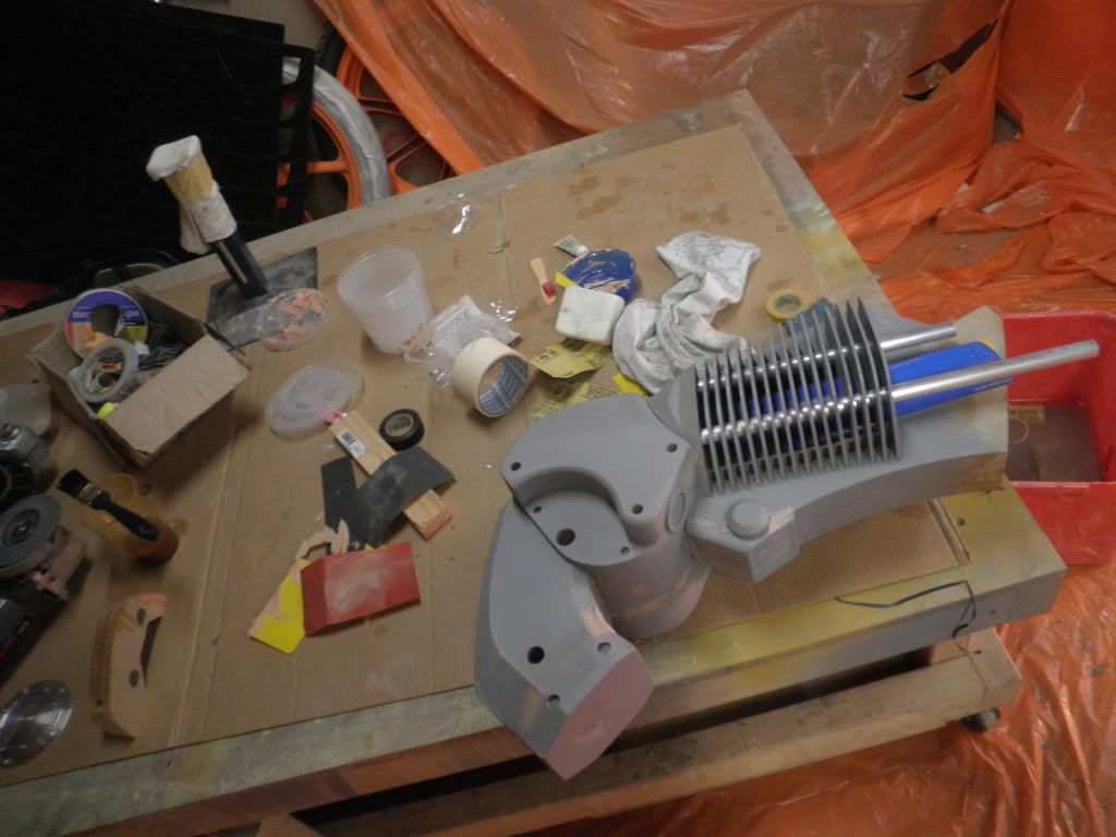

      Test fitting the "engine:
      R.H.D
      M-technic I club
      • JamesE30
        • Feb 2007
        • 2092

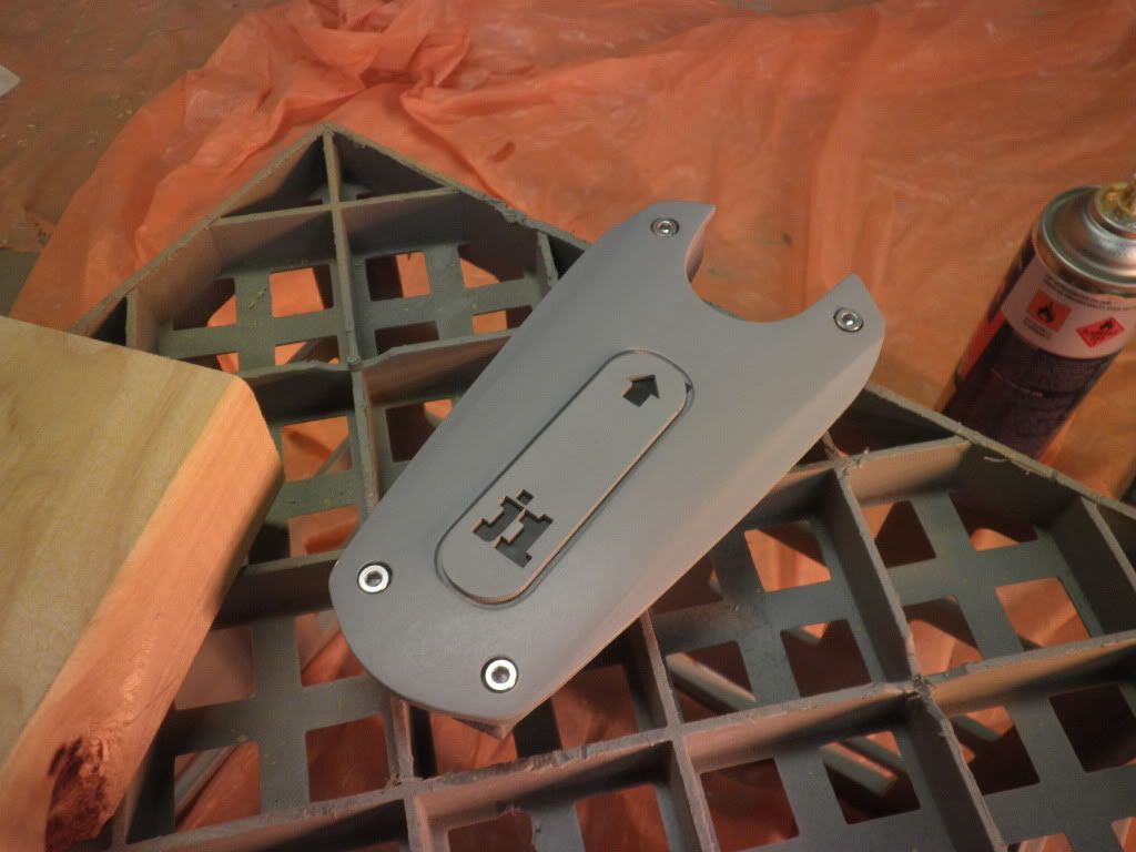

        #78

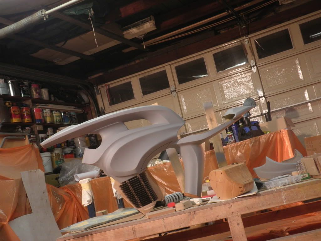

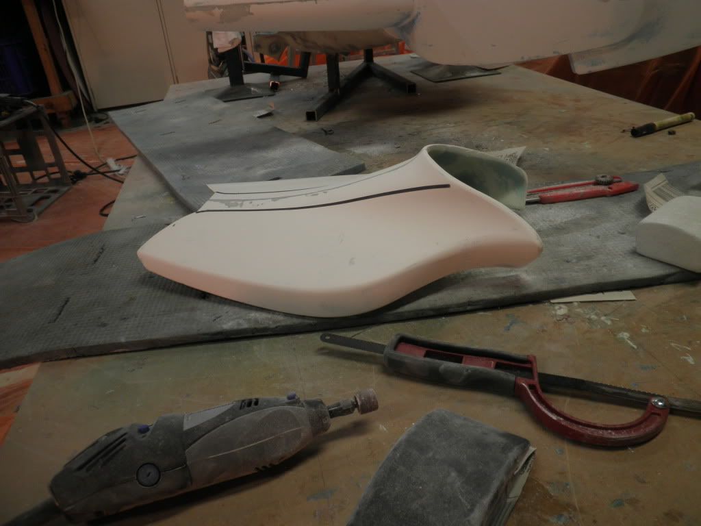

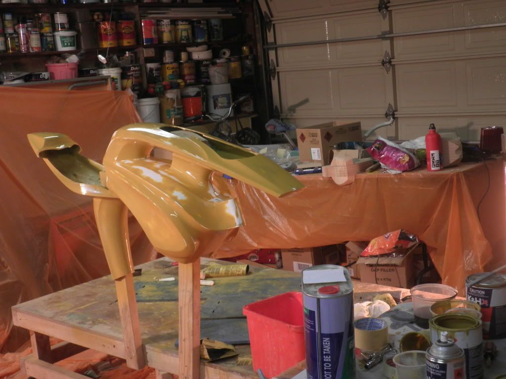

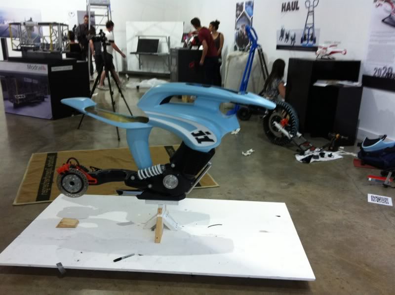

        work on the engine and other little bits:
        That preetttyyy much brings us up to the point where I had to send my journal off,so it could be printed in time.. This was about 6-10 days before deadline.. and I still had a lot to make.. so there were not too many photos taken after this

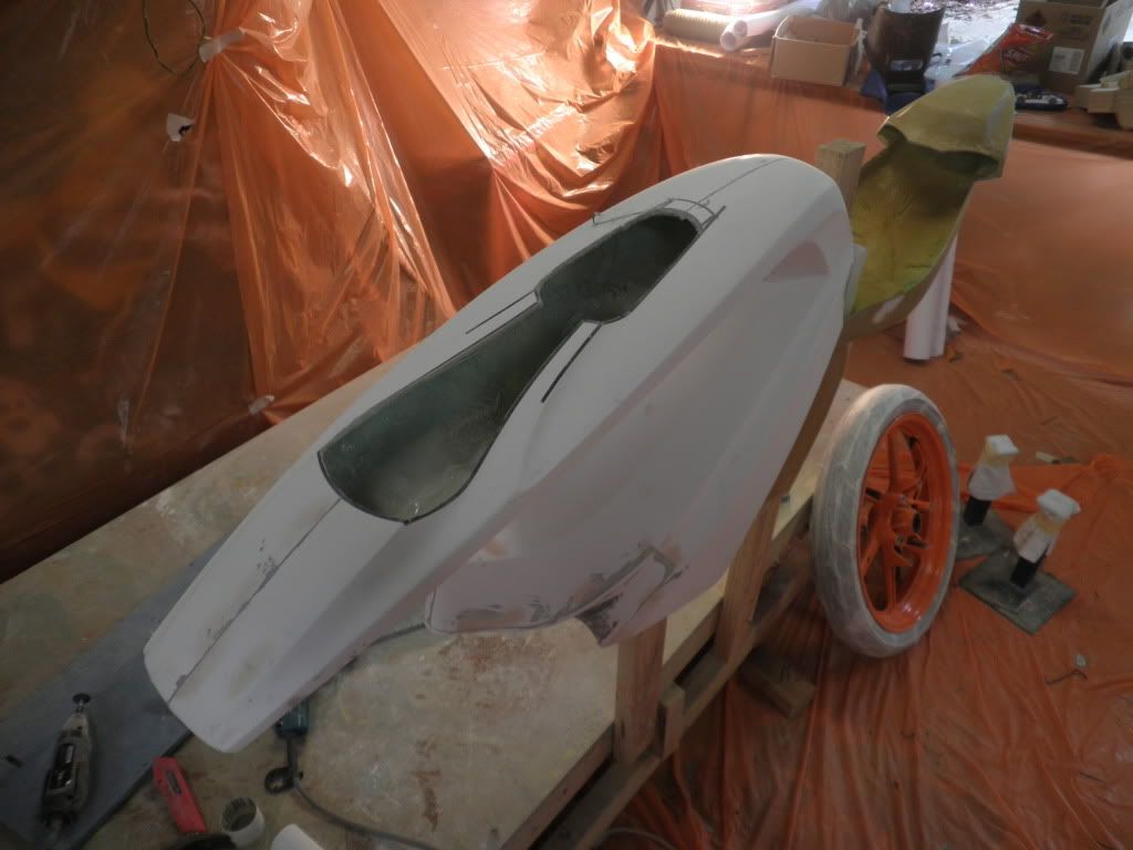

        So I'll cut forward a bit, and here's a little teaser of the final assembly..
        High res shots coming soon!

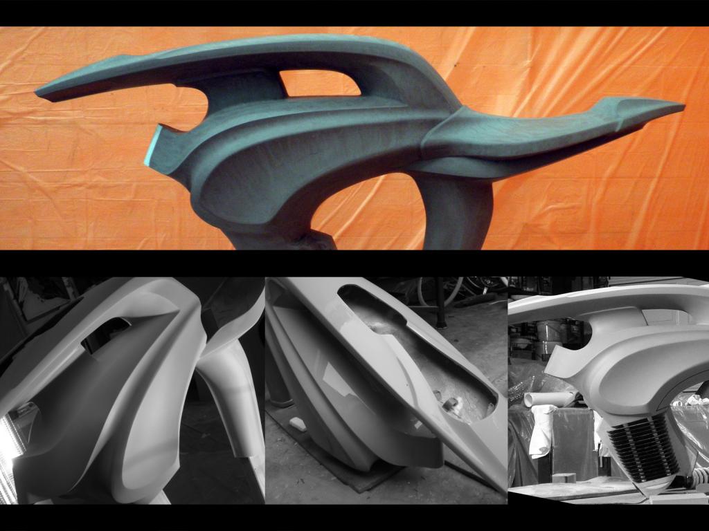

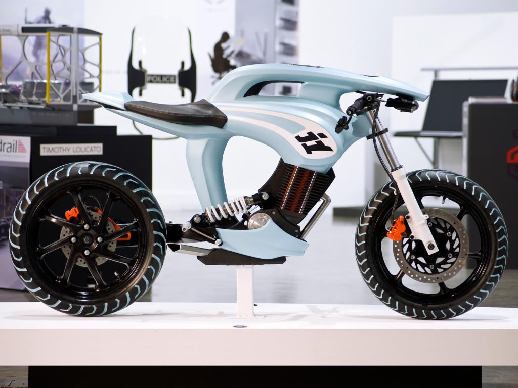

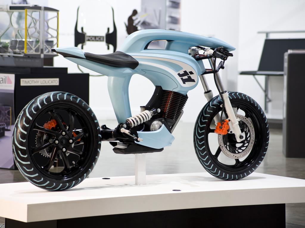

                  #83
                  Thanks again guys
                  Originally posted by masduro
                  NICE! steam moto1928 is awesome, some great style an themes in your sketches.
                  Sorry I kind of forgot to update this thread and kind of conclude it but here are some final shots of the model..
                  So guys My bike is entered in a design competition on AnnoBooks.com judged in London. Please VOTE FOR ME R3V!
                  Link: http://annobooks.com/index/competiti...rcycle/id/1649
                  VOTE VOTE VOTE :D
