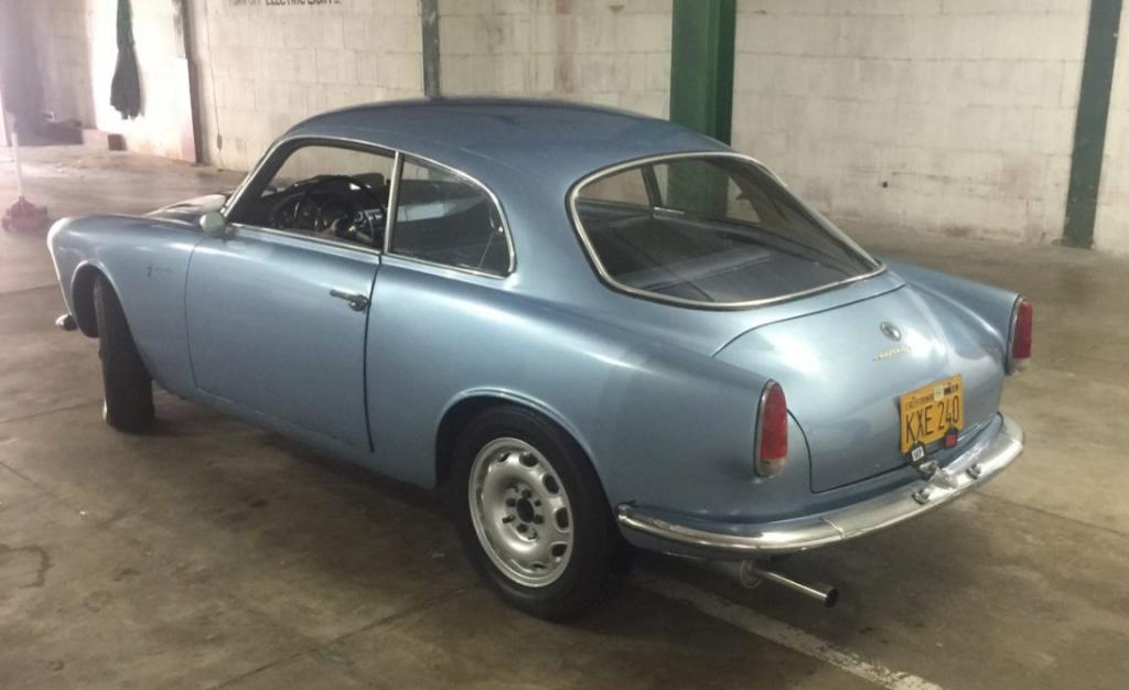

              '62 Sprint Veloce coupe on BaT
Name:	Giulietta Sprint Veloce.jpg
              Bid for the chance to own a 1962 Alfa Romeo Giulietta Sprint Veloce at auction with Bring a Trailer, the home of the best vintage and classic cars online. Lot #8,335.
              • BlackbirdM3
                • 2772
                #1822
                Looks like a pretty straightforward car. Too bad the original Veloce engine is missing, that will cut a big chunk of $ of the winning bid.

                    If I'm not mistaken, that car has either not sold, or has bounced around for a long time. I've seen that pic a few times before. Seems like a nice car, but I don't know why it doesn't find a good home.
                    Back to the Sprint. That is an interesting car. Since Glen Olivera went through it, I'd bet its in great mechanical shape. Glen owns the oldest Sprint in the US and races it on a regular basis. He does great work.
                    Looking at pics of the engine, I see a 1600 intake, and a Denso alternator (rather than a generator. That also likely means is a negative ground car now.) I also see an aftermarket guibo cage on the driveshaft. I think it will make for a great project, or preservation car. The carpet is pretty tired, as is the headliner, however both can be found. The headliner replacement is an involved job, it took 9 hrs to have mine installed and that didn't include removing all the windows (An involved job in itself.) The rest of the interior looks decent. I'd hate to call it a fake, but a couple things tell me it is. The biggest one being the lack of a ridgeline though the trunk floor for a Veloce fuel tank vent. Also, that is a Normale fuel tank, not a Veloce. The gauges are correct, as are the badges, but both aren't that hard to obtain or install. At the very least I'd be sending hte VIN# to Alfa Historico to have it verified.

                      Is it possible the tank got nasty and was replaced with a regular one? Same deal with the motor... Seems like getting the VIN verified is very important for a car like this because there is a big difference in the historical value of a Veloce and the Normale

                        Yeah, that's a long long time to keep all it's original parts, especially when for a lot of that time it was just an old sports car, not collectible. "Keep it running" was more of a priority. Used engines were cheap.

                              Its totally possible the tank was nasty, however I'd bet it wasn't based on my findings with my own tank. (My tank sat half full for more than 40 years and its only slightly varnished, no rust.) The engine is a toss up, but even back then people knew the Veloce engine was worth hanging on it. To be honest I bet the Veloce engine ended up in someone's spider. Tons of Sprints were parted out for all the swappable parts for Spiders in the 70s and 80s. The popularity of the Sprint in those days was low compared to the spiders so they were plundered and thrown away. (Now there are far more spiders than Sprints.)
                              This is what you get when you research the VIN through the Alfa archives. this was for my Sprint.
                              Dear Mister Campbell,
                              with reference to your request we are informing you as follows.
                              According to our documentation files, the chassis number AR 1493.20198 originally corresponds to an Alfa Romeo Giulietta Sprint, manufactured on the 6th October 1959 and sold on the 12th October 1959 to N.S.U. Werke, Germany.
                              The body colour is Alfa red.
                              The number you provided me doesn’t correspond to the engine originally fitted on this car.
                              Yours, Sincerely,
                              Marco Fazio"
                              its easy enough to do. The buyer of this car would be stupid if he didn't send them an email to verify.
                              That said, I like the car, and I like the color. I hope it goes to a good home.

                                Does that suggest that it is or isnt a Veloce?
