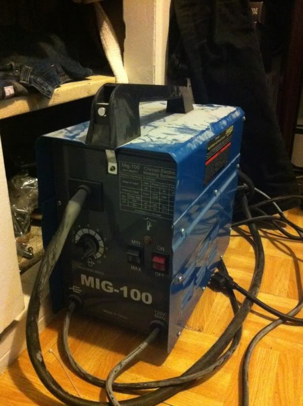

    Hey guys. Picked up this "Chicago Electric Mig-100" welder as my first welder. I welded my selector rod with it and my skid plate, but it all of a sudden stopped "arcing" I guess the word is. I know just about nothing when it comes to welding. Basically when I ground what I wanna weld and get the wire on it nothing happens. But it indeed did work. Any thoughts ?
    UPDATE: Fixed it, loose ground wire

        Fuse? Check polarity Cables if the polarity can be reversed.
          I was going to say Fuse as well, may be an internal.

            The only things I could think of would be a fuse or a physical connection not hooked up properly somewhere.

                Got it going.......Ground cable from the huge electro coil thing inside was disconnected.......Quality my friends, is not found in $80 harbor freight welders.
