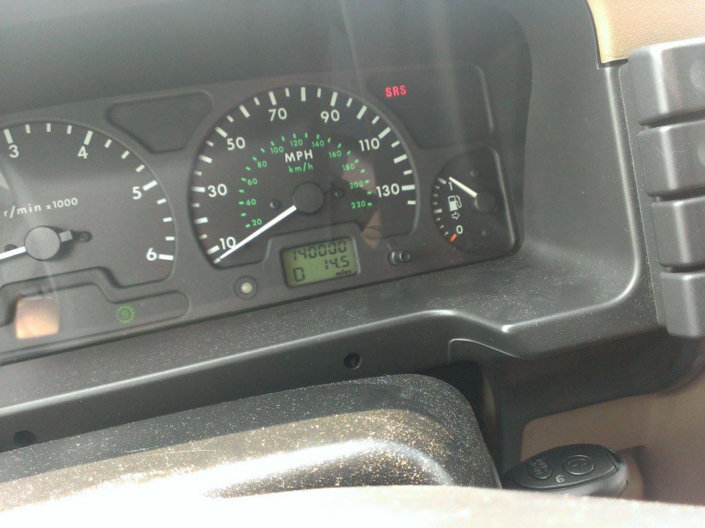

                        Hit 140000 today, its due for an oil change, and headgaskets! Picked up my rebuilt spare set of heads today and will install everything next month.
                        The SRS light is on because the Disco didn't want me to think its reliable and turns random lights on to remind me how British it is.
                        /the rotary coupler in the steering column is faulty.
