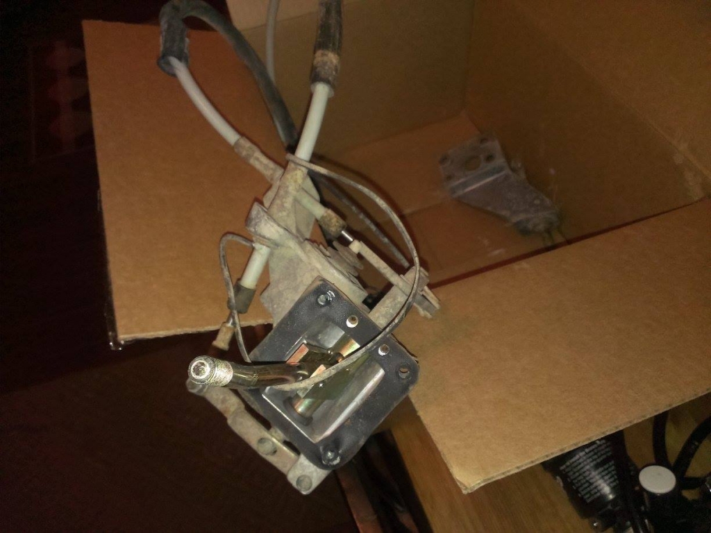

            Got this in the mail today, 2004 Discovery CDL lever, nice addition to my 2000
