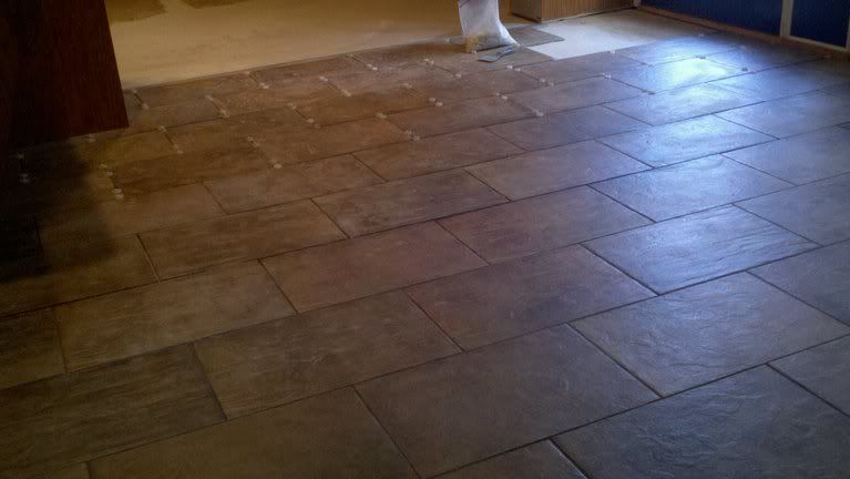

      So what did you settle floor on your kitchen?
      Mine is done minus the molding finally.
