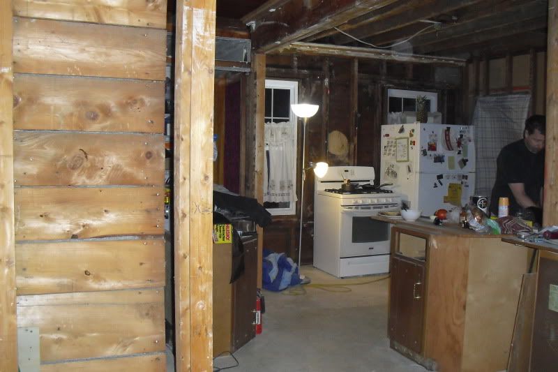

          So i ripped out all the 1/4 inch plywood that was covering the sub-floor in preparation for the Hardback concrete board. under the fridge area was worse than i thought and it looks like it spread to under the hardwood floor in the hallway. i dont want to half-ass this because it is my house. what do i need to do to fix it?
          and the particle board in that area looks sorta green:
          so you can see how far the mold/mildew has spread:
          thanks for the help!

              Was there mold on the 1/4 inch sub floor? You need to determine the moisture source. Is it still wet?
              You probably should have left the 1/4 inch for strength.
              Did you calculate the floors deflection to see if you can lay tile without it cracking?

                all the water came from the fridge leaking, which i think i have fixed.
                also, the 1/4" wood was just luan that was stapled down around the edges. so if i had tiled over it, it would flex and the tile/grout would crack when people walked on it. it also doesnt act as a water barrier. i am putting down 1/4" concrete board that will be a barrier for the moister and will support the tile by being screwed into the floor joists.
                i just need to know if i can douse the dark areas with bleach and forget about it, or if i need to remove part of the subfloor and replace it. (assuming it is solid when it has finished drying...)

                  Half bleach, half water mix. Mold rejects pure beach.

                    After that some Killz to seal it up. Let the bleach do it's work don't rush it and let it dry thoroughly.
                    Or yank the subfloor and start new.

                      Bleach is not effective on porous material, like wood. It will not penetrate past the surface.

                        dude you need to watch more Holmes on Homes you'll learn everthing you need to look for and how to fix it, what to do and what not to do.
                        but you need to see if it's mold or dry rot. If it's just water stain then wood should be fine as long as leak is fixed. Other wise rip it up and put a new piece of OSB. I would suggest just put new piece in because it's cheap for that board and will look nice, even though you don't see it.
