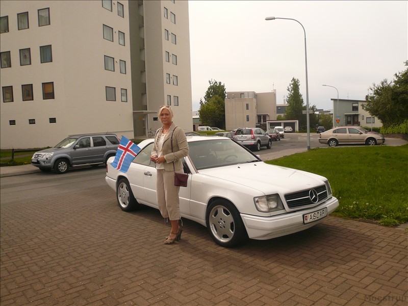

        Buy it,,, these are a bullitproof cars ,, my wife drives a 300CE ((both are superb))
