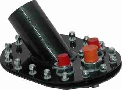

    Hey guys I'm pretty new to solidworks. Been using autocad for a year, now working with solidworks.
    I'm building a fuel cell with my boss and id like some tips on making a hole pattern around an oval flange.
    Trying to make something like this.
    Project

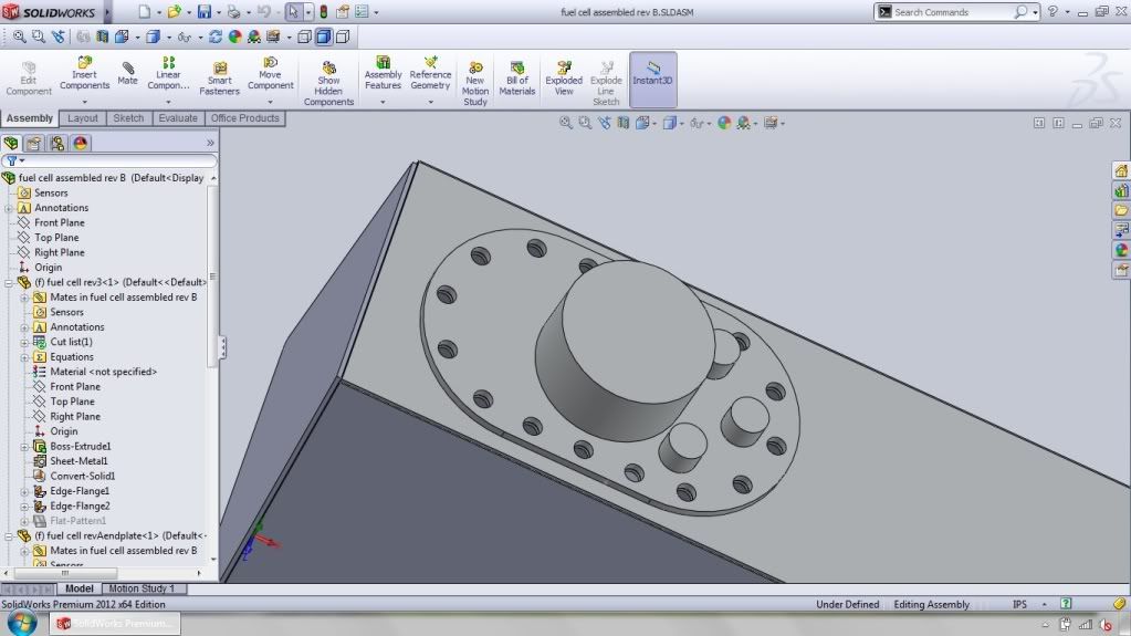

    I haven't played with SW in about a year. Extrude cut and make a pattern? Can't remember if they have extrude cut patterns for oval. Could just go make a hole, dimension them from the outside of the oval lines and go from there? I think you should figure it out by just playing with it.

      Do it all in sketch, then extruded Boss/Base the plate.

        Can you array along a line?
        • TurboJake
          • 3780
          No, only rectangular or polar.

            Can you divide a line?
            • Thizzelle
              • 4422
              yes you can do curve driven pattern or sketch driven pattern, L2R in solidworks. although I have 10 years xp, I think everyone is a noob.

                also if curve driven make sure you click offset curve option, but as you can see the spacing will get tighter towards the points of the ellipse. If you want perfect spacing use sketch driven. Don't think it will be perfect cuz ellipse but close.
