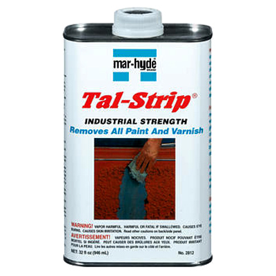

            Aircraft remover ain't got shit on this stuff:
            Works 10x better then aircraft remover.
            Also, a little heat on the vinyl will make it peal off very easily.
                thats what I am talking about Tal-Strip II says aircraft coating remover and has a pic of a fricken C-17 on the can .
                This shit will turn your hide brown and blister all to hell if you get a little to much on ya fingers
