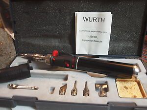

                • mikeedler
                  • 6707
                  bought this from Würth about a year ago for around $75.
                  it's butane powered. love it!
                  • !kid
                    • 1362
                    ^ i have the same one, works very well.
