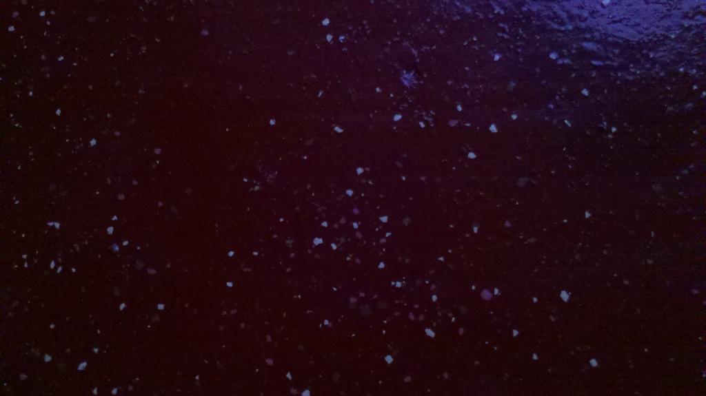

      If you do go ahead with it I found that color flecks over epoxy really help hide the imperfections in the concrete.
