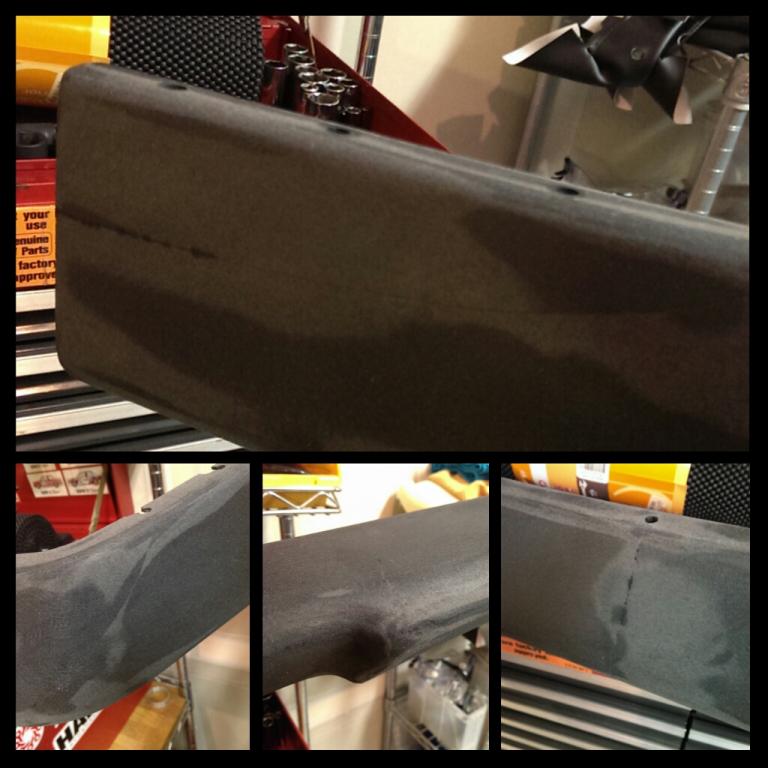

              Pics of the carnage. I don't think this is really that bad, there's just a lot to fix.
              The break in the middle is PERFECTLY clean, no chips missing or anything:
              I have to say, if there's any kind of a silver lining to this, I'm impressed as HELL at the durability of Duplicolor bedliner. I smashed this thing into a concrete slab hard enough to bust the entire thing free from my car, and this is all the damage the coating took:

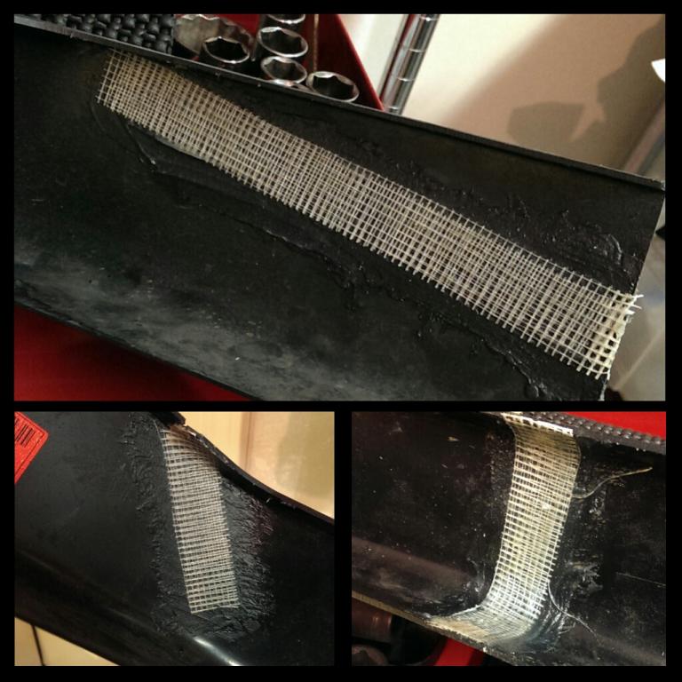

                            Started fixing the lip this weekend. I superglued the cracks and broken off pieces back together, just to get the thing into one piece again.
                            Then yesterday, I used a palm sander to sand all of the bedliner off, and get the cracked sections flush. Once they were all sanded down, I turned the backside. I used fiberglass tape to reinforce the cracked sections. I laid down one coat of plastic epoxy, pressed a strip of tape into it, saturated with another coat, laid in another strip, then saturated again with more epoxy. When the cracks are all repaired and dry, I'll be repainting the lip again with the same bedliner I used before, but I'll also be coating the backside where the major repairs were done.

                              that looks good!! nice fix man
