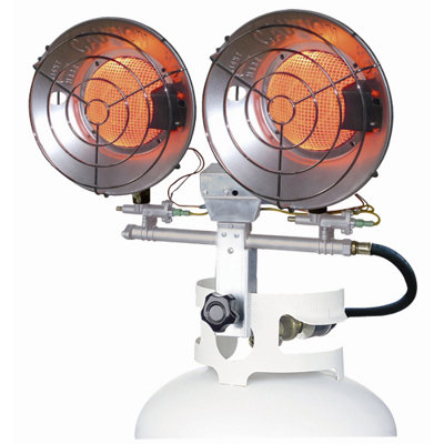

          You;ll end up getting something like this:
          $200 at lowes: http://www.lowes.com/pd_150677-46631...r|1&facetInfo=
          Or you can get a propane tank top heater from 15K BTU or a duel head version for 30k BTU.
          There are some other options with more heat if you need (large panels).
          If it was me, I'd get two single head propane top heaters and put on at both ends of the shop.

                lol but really, would something like this work in a garage?
                http://www.homedepot.com/p/Mirage-38...f#.UqFFvmRDsRs
                • george graves
                  • 19998
                  I think that's too close to the rafters.

                        Based on that chart George, to be comfortable I'll need a maximum of 60k and a minimum of 45k. I think that one dyna-Glo will do the trick however I'd like to see some real life usage data. Tri-fuel is impressive.
                        Mrsleeve is absolutely right on kerosene being a higher output of btu's for the money. Salamander style seems more than ideal. Those propane top heaters sure are attractive for the price though.

                              The propane top heaters are useless unless you're in a 5'x5'x6' deer stand tiny box. Don't think about them.
                              Go 75K at least. Trust me. I use mine all the time in winter, and it heats up my 2car to about 65 after about 3 hours. It takes a looonnngggg time to heat up initially, but stays there quite nicely after the fact. It's a priceless thing to have. Easy to move even with a full tank.
                              It takes about 8-10 hours of constant running to empty a full tank too. Lasts a good deal of time.
