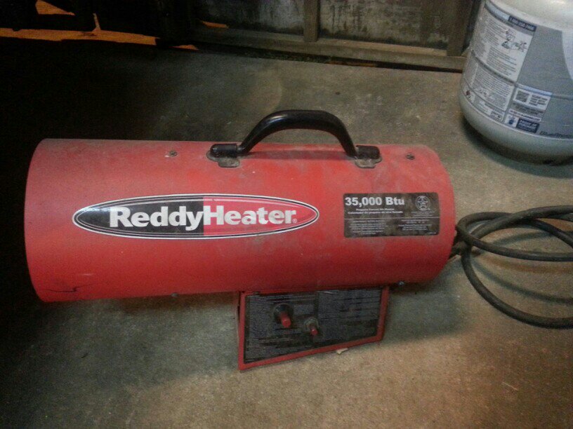

                            This is what I use Matt. It's only 35k but on a cold night I'm comfortable in a t shirt working in the shop. Youve seen shop. Its 20 x 24 and isn't insulated.
                            Now it is fairly noisy. And if you need to run it all day it will eat up a tank of propane. I'd say get the largest one you don't have a problem paying for.
