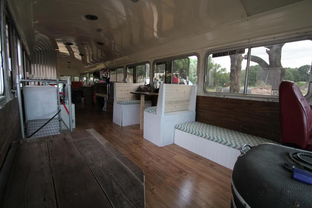

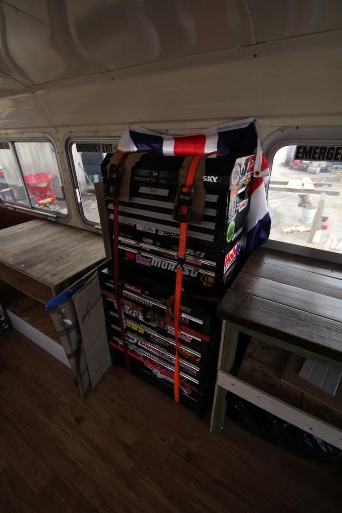

      Alright I took some more photos with the real camera today to give you an idea of the final layout. Most everything is in its final location now and anchored down. Also finished building the dinette eating area this morning.
      View of the front. Also note the sweet red air ride captains seat. The engine is under the big doghouse in the middle. You have to scramble over it to get into the seat haha.

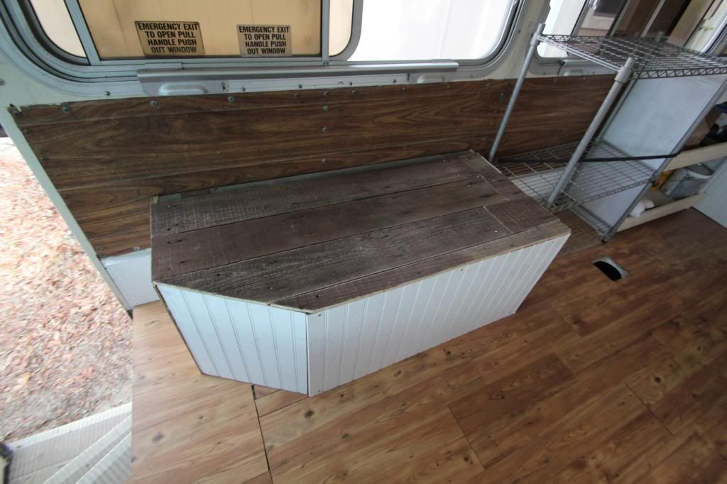

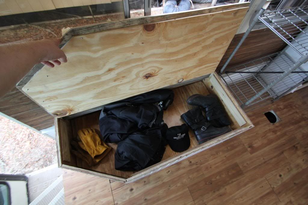

      This box covers the pass. side front wheel well.
      I hinged the top to make a place to stash shoes and whatever else might fit

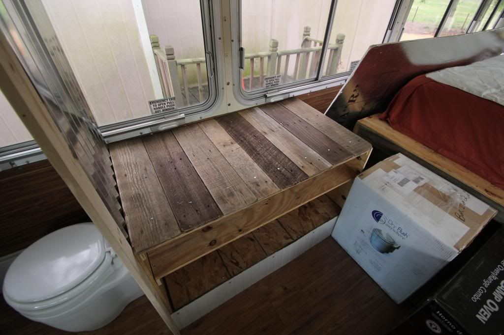

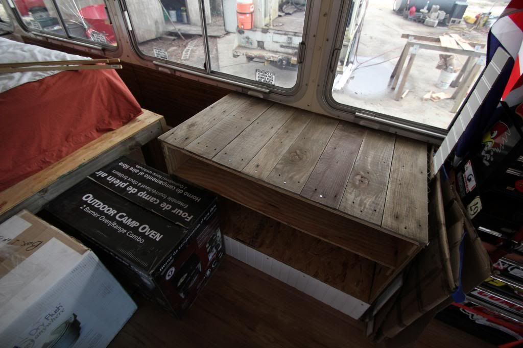

      Drivers side wheel well cover is a small bench

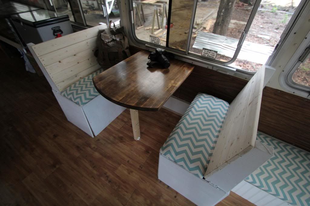

      Finished dinette seating area. The table top is the middle section of that old table pictured earlier. We refinished it to give it an antique look. Also reused the hinges from the folding table sides to hinge the front panels on the benches to make some secret storage areas

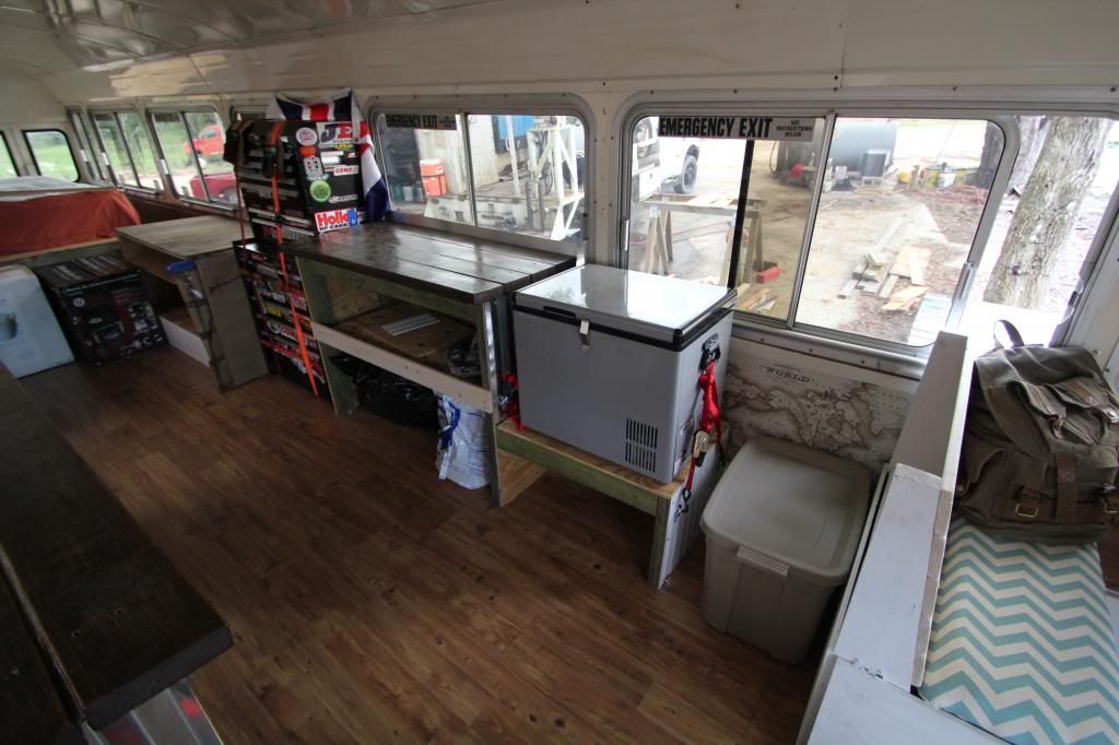

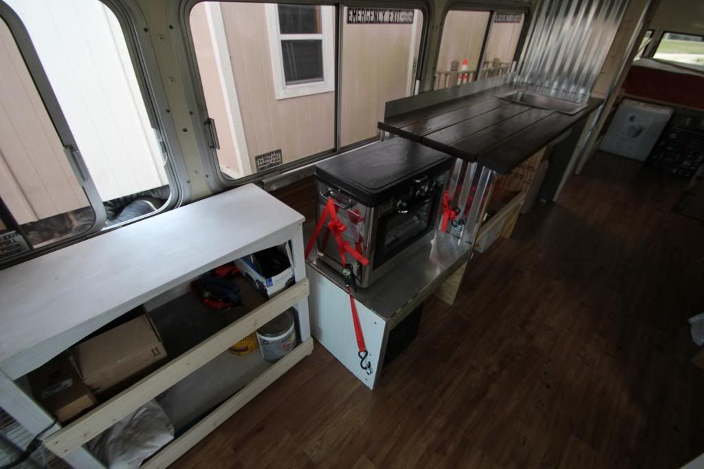

      Propane camping oven/stove setup. Notice the use of festive ratchet straps to hold appliances down :D
      Fridge mounted on the other side

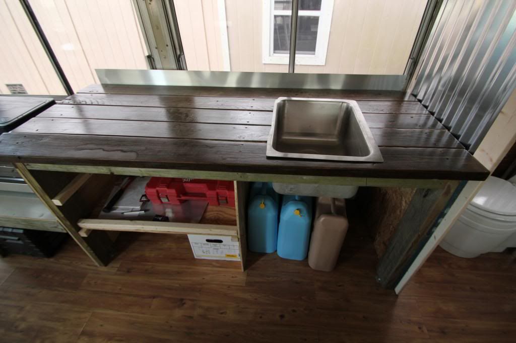

      Counter top with sink inset. Didn't glue the sink down in case we aren't parked level so we can tip it to drain. Still need to plump a faucet and the foot pump. Water will be handled by jerry cans. Also keep in mind that I built most everything out of lumber that has been out in the weather for a long time so it isn't the straightest....
      Tool box mounted in place. Held to the wall by D rings. Going to pack the drawers with rags so there are less rattles on the road

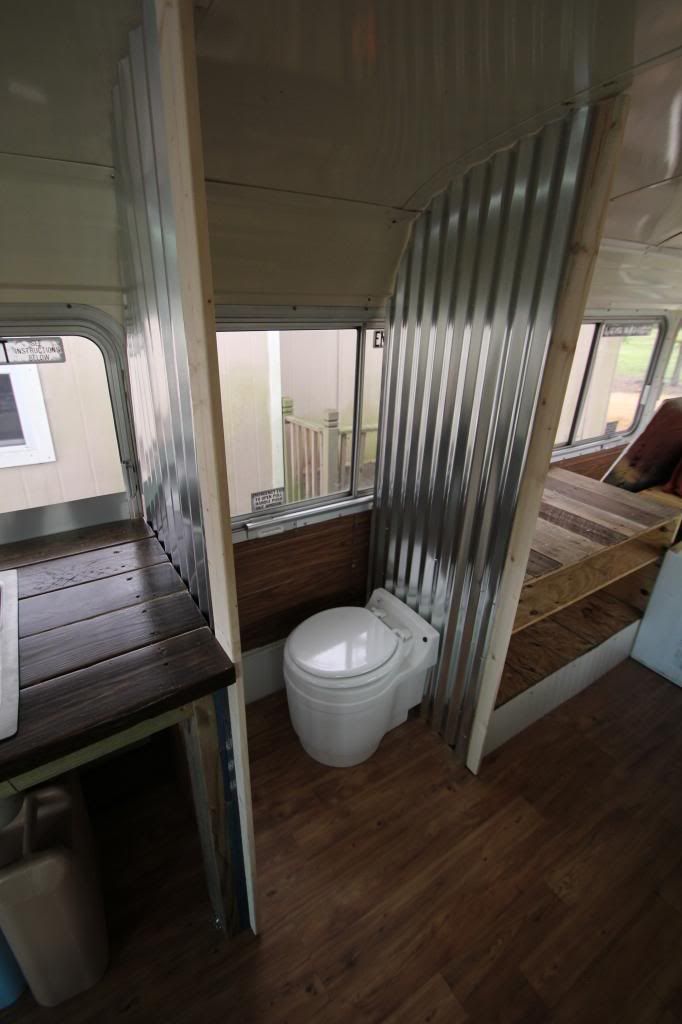

      Tiny room for the toilet. Wall built out of corrugated roofing panels. Still need to build a door
      Over the rear wheel wells I built a couple shelves, plan on using these for clothes storage and other odds and ends. Also have plans to build a small section of closet rod behind the bathroom to hang clothes... we will see how far i get with that.

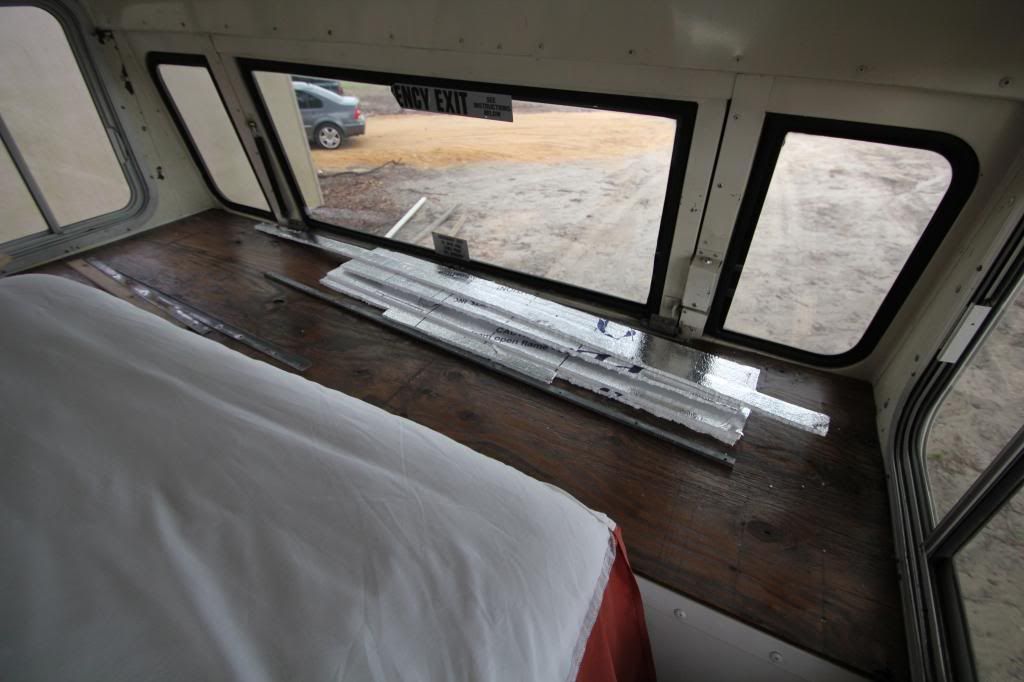

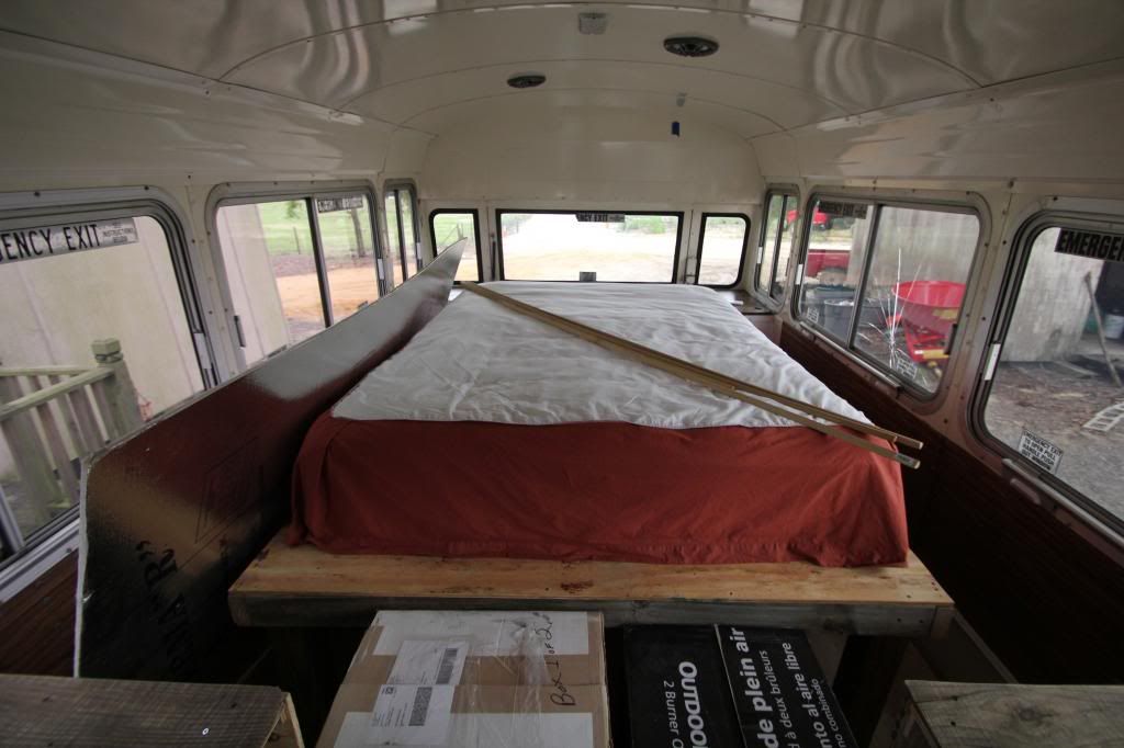

      Bedroom with a view! Bed platform has 2 feet of clearance underneath, lots of room for storage. We even got to keep our fancy new queen mattress. Ditched the box spring though, we figured we didn't need the extra height (also it wouldn't fit through the door )
      Large ''headboard'' area at the very back. I want to get a new gas strut that works better to hold up the rear emergency exit window, it combined with the side windows makes for pretty decent ventilation

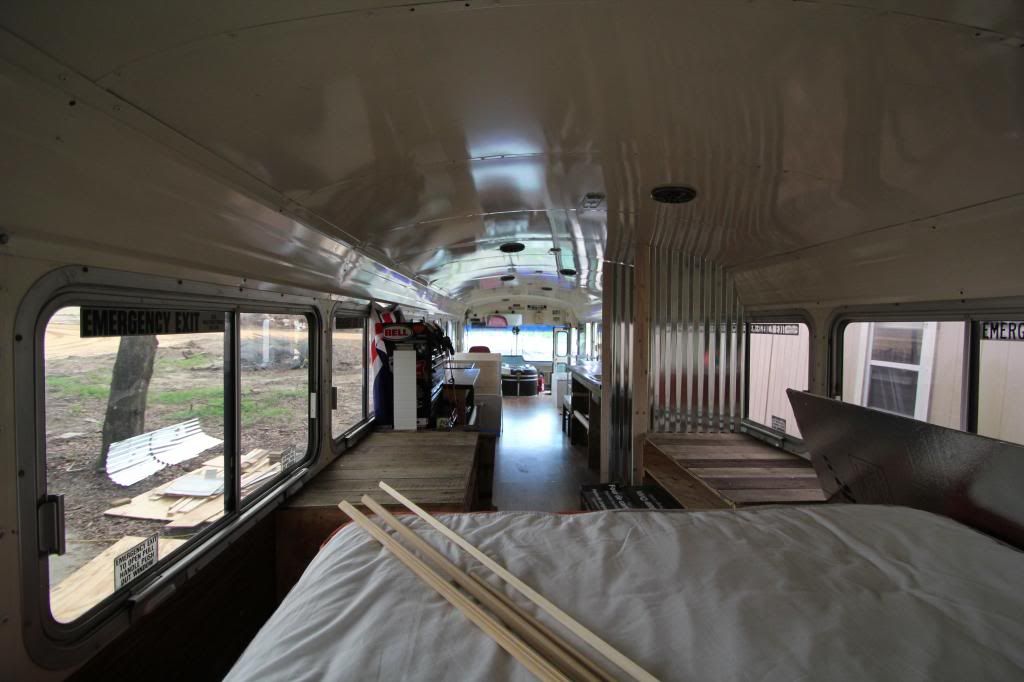

      And this is the view from the back to front. Surprising amount of space in here.
      There is still lots to do inside, painting and finish work, rigging up water and power, etc. Should be a busy couple of weeks!

                    This is awesome. Considering your plumbing is going to be simple. I am assuming your toilet is basically just a bucket? Use it only in emergencies. I was on a bus from PA to FL and I was in the middle closer to the front than the rear. The toilet was in the rear and the smell drifted up my way on more that one occasion. And it could flush. This was a little over ten years ago. I have not ridden a bus that far since. I am looking forward to future updates.

                      We are using a dryflush toilet. More info here: http://www.dry-flush.com/
                      Pretty interesting concept, going to take some getting used to. Although I plan on it being more of an emergency toilet when there aren't any conventional bathrooms available

                              That is a pretty cool toilet. How much do they cost? How much are refills?

                                It was $450 and came with a couple packs of refills. To get more they are $50 or $60 a case, each case has 3 cartridges in it. Each cartridge has 17-18 "flushes" in it. It's a little spendy to operate, but nicer than dealing with a regular porta-potty. That's also why I plan on using it for backup use mostly.
