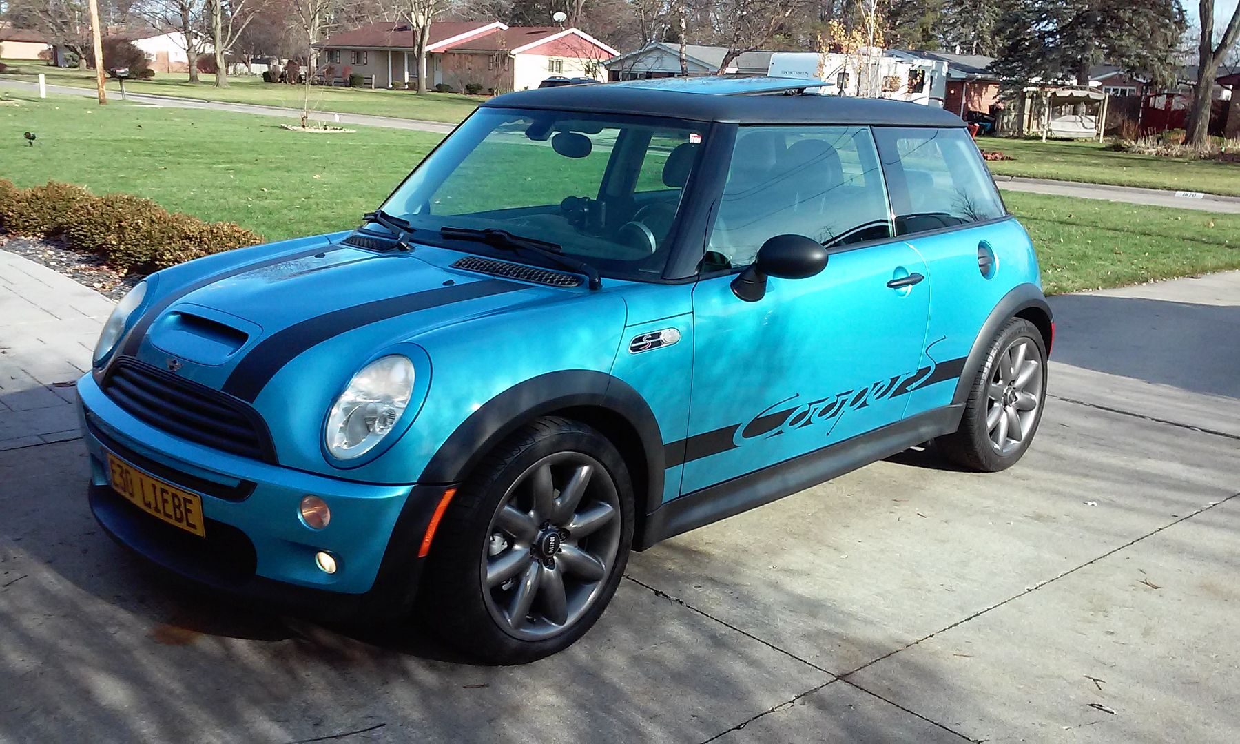

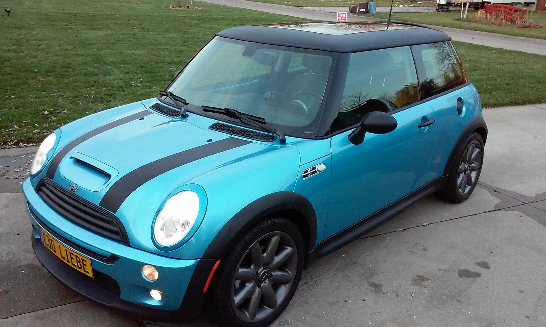

    Originally posted by rcsoundn1
    What did you use to black it all out? Only thing that gets me is that the stripes stop beore you see color again.
    I'm unsure what you mean about the stripes.
    • Stanley Rockafella
      • Aug 2011
      • 4062
      #32
      the lower edge of the hood you see body color at the end of the black stripes.
      ...at least that's what I think he means
      • graveshaker
        • Sep 2009
        • 828
        #33
        I guess that's how the stripes are designed
        I can always add a little plasti-dip now that attention is drawn to it lol. Now I can't stop looking at it.

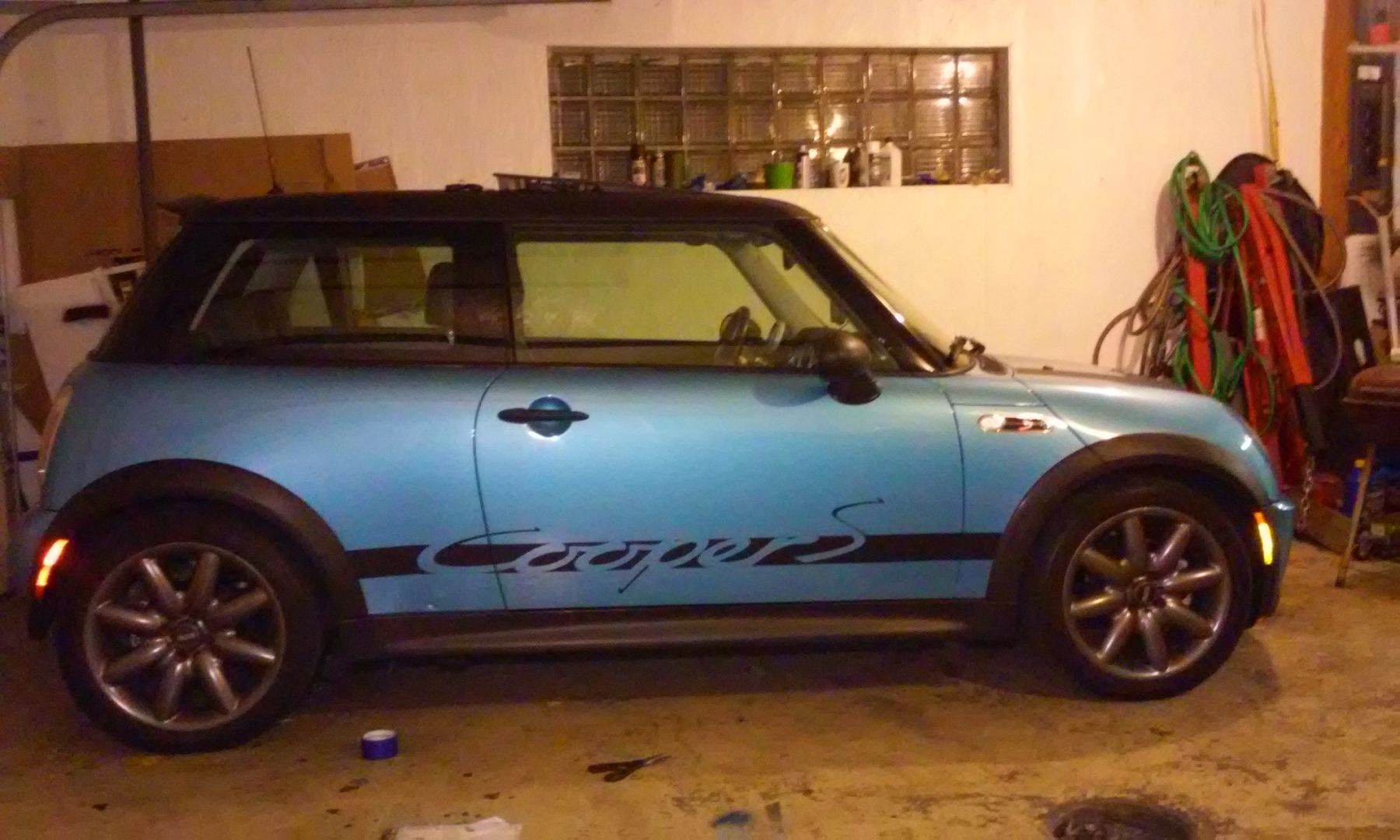

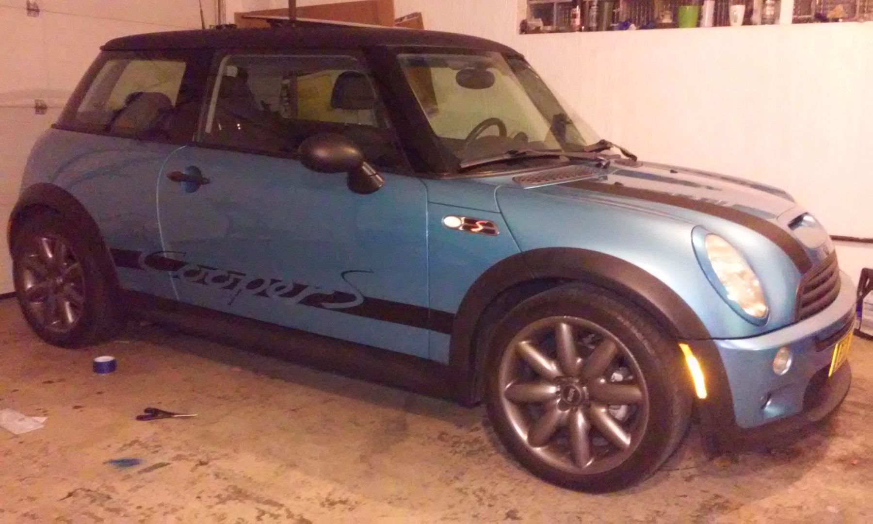

          Just laid a Carrera style decal. This thing is going to be loads of fun, I can put on decals and stickers and get away with it. This would never fly on a BMW.

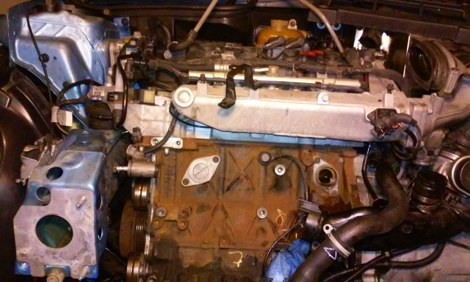

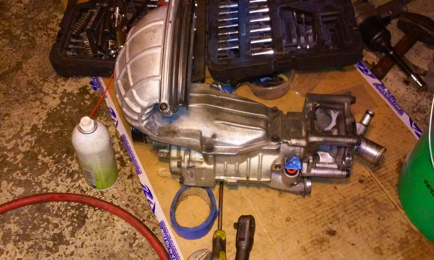

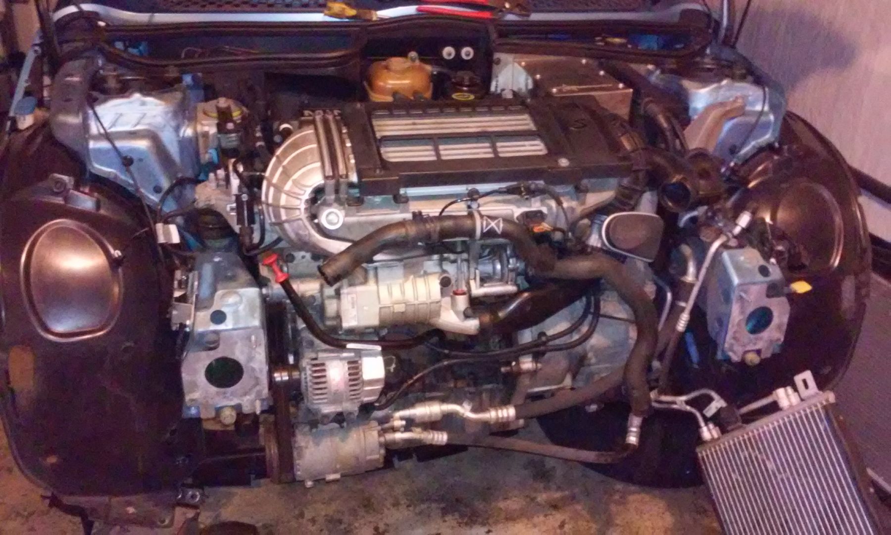

            Sooo I tackled the supercharger oil change job. It honestly isn't that bad. To do most maintenance on the mini cooper you have to put the car into what's called front service mode. This is taking the front bumper off and depending on what needs servicing the radiator may need to come off. Doing this the first time surprisingly took me just under an hour. After that the supercharger was off in another 40 minutes.
            I won't have to worry about the oil for another 100,000 or so miles. There are a few O rings and gaskets that I'm replacing while I'm at it so I honestly shouldn't need to go this deep any time soon.
            I installed my Ireland engineering exhaust and along with the supercharger reduction pulley and other mods she pulls as strong as my m3. So far I do not miss my m3, the mini handles so well and can power out of corners like crazy.
                the supercharger gets different oil?
                Sorry but 100k miles b/t oil changes?!?!?!
                :o
                • graveshaker
                  • Sep 2009
                  • 828
                  #38
                  :o
                  The Eaton supercharger uses a lifelong oil same oil used on GM cars equipped with Eaton supchargers. Only thing after 100,000 or so miles the oil could potentially dry or leak out. Mine was a little low. Piece of mine is knowing that it now has clean fresh oil. And will be good for well over 100,000 miles.
                    • Aug 2011
                    • 4062
                    #39
                    wow, didn't know that.
